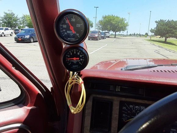

Yes, rotate the allen screw clockwise to turn up the fuel (on an NA & turbo truck). Only rotate it 1 flat; or 60*, at a time. Correct, a pyrometer is an Exhaust Gas Temperature gauge.
My Bullnose truck is NA and I installed a pyrometer.
I've since added a vacuum gauge above the coolant temperature sensor. We'll see if I ever install a turbo.
Here's the pyrometer I installed. Interestingly, it wasn't listed on the Summit Racing website. That's where I bought it from a few years ago.
https://www.autometer.com/2-e-g-t-ki...-z-series.html
Here's another highly rated supplier of automotive gauges. I bought a Glow Shift fuel pressure gauge that I just keep in my tune up bag with my timing light and piezoelectric timing adapter.
https://www.glowshiftdirect.com/

What temperature should I keep it below and is turning it up going to cause it to run hotter or cooler?
I know on gassers the richer they are the cooler it will tend to run but I dont have much experience with diesels.
What do you use a vacuum gauge for on a diesel I thought only gassers had vacuum and the diesels had electric vaccum pumps?
Thanks, Ill take a look at those pyrometers!
Old Mar 16, 2026 | 07:30 AM
tjc transport's Avatar
tjc transport
i ain't rite
Joined: Mar 2005
Posts: 65,221
Likes: 5,405
exhaust temps should be kept below 1100 degrees.
over 1200 degrees will start to melt the aluminum pistons causing irreversable engine damage.
too much fuel in a diesel will create excessive heat in the cylinders causing piston melting among other things.
