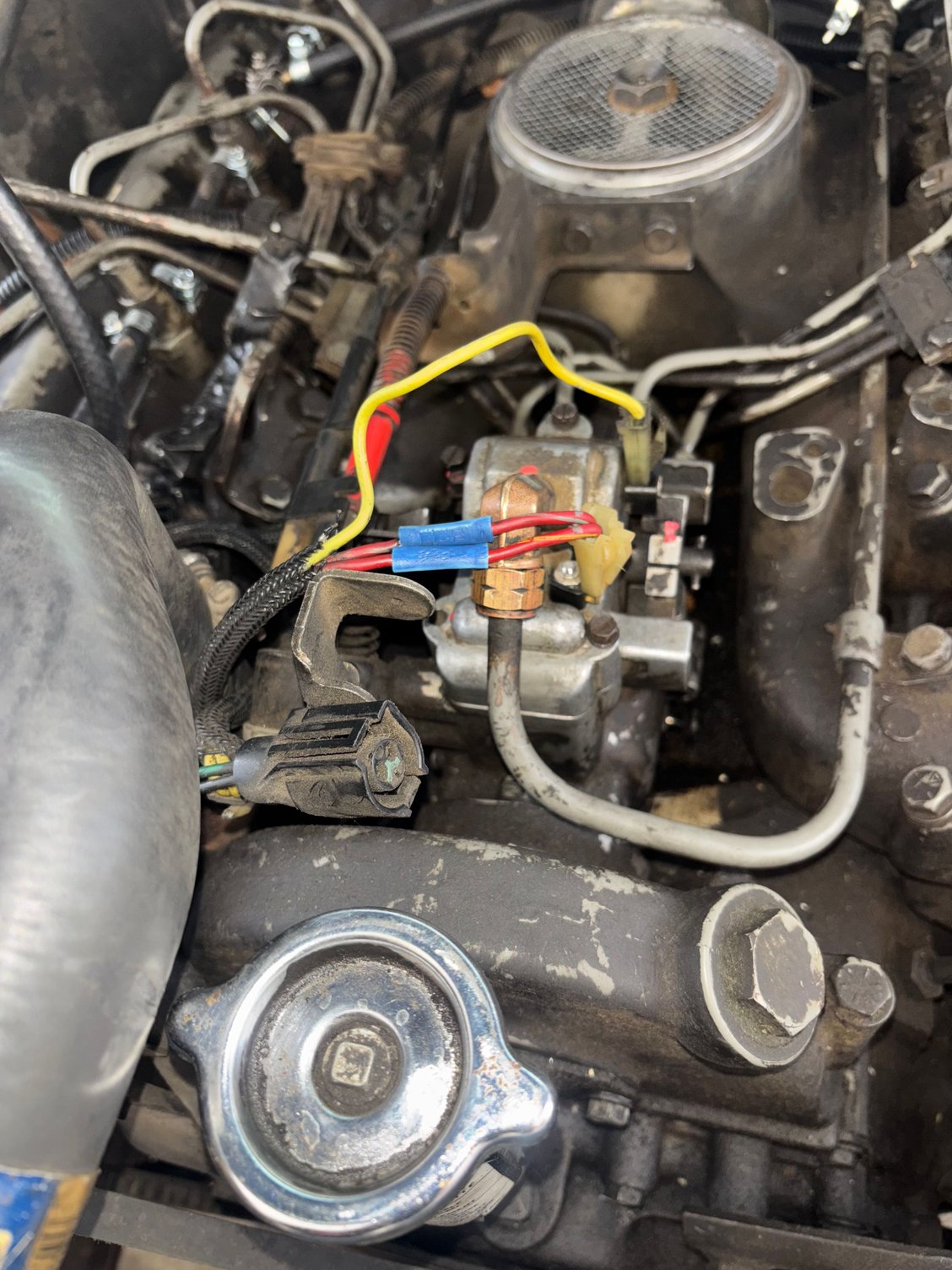

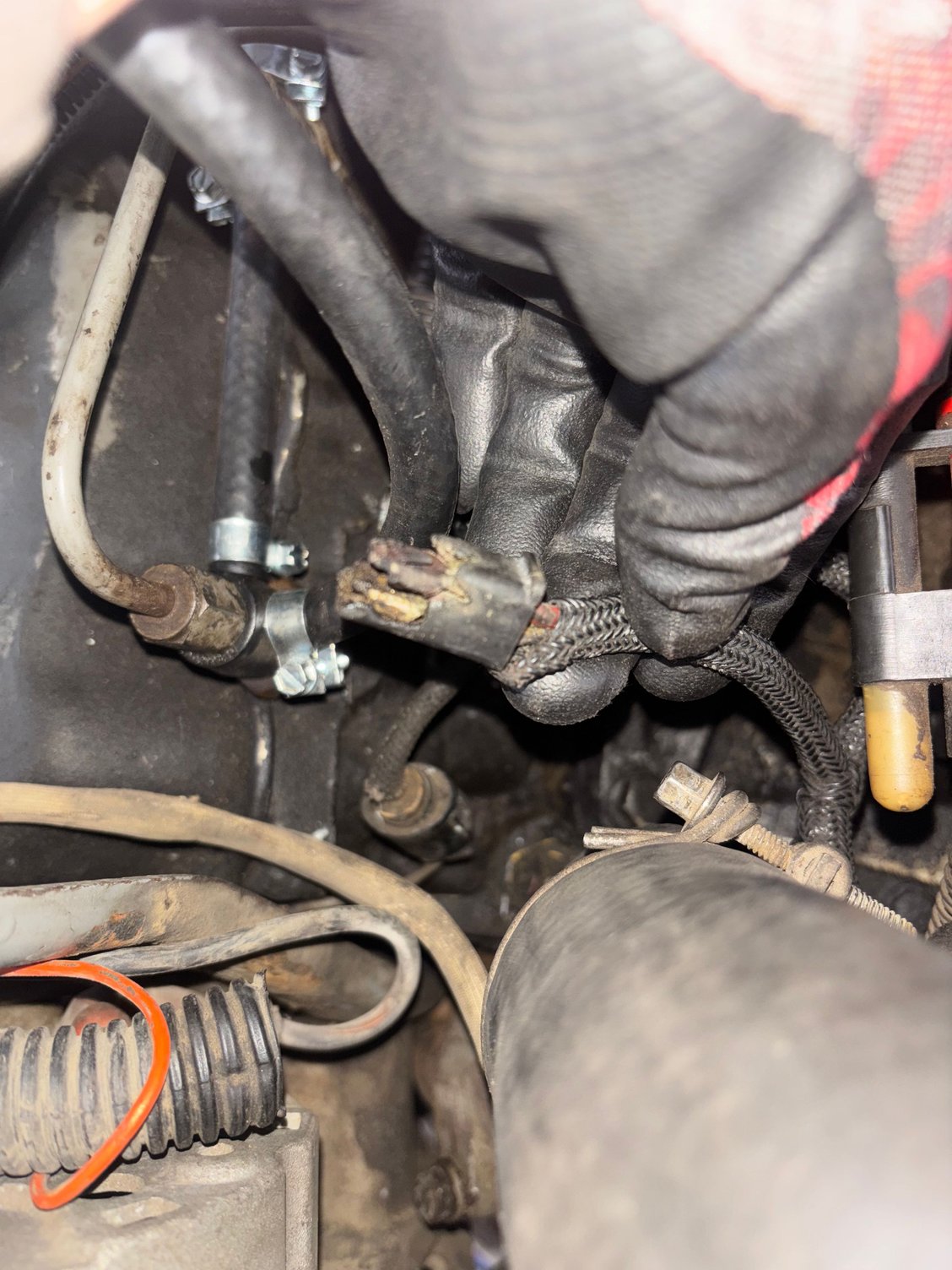

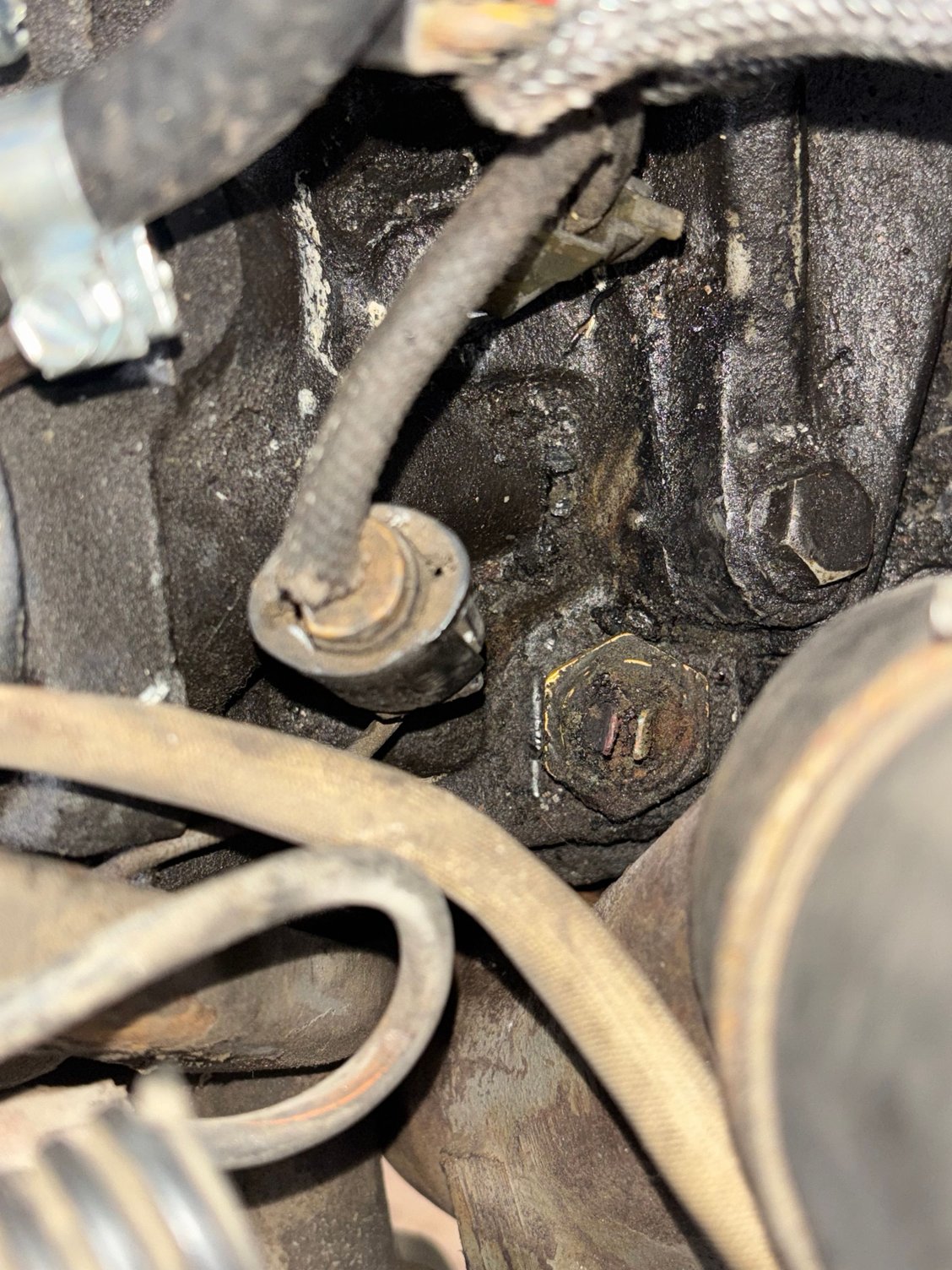

Hey yall. I got everything replaced and warmed up, I turned the key and let the glow plugs warm up. My buddy immediately was yelling about smoke so I shut the key off. The wires connected to my temp sensor burned up. I’m worried it has something to do with the way I fixed the wiring to the IP. HELP
Burnt wiring from temp sensor
Wiring I fixed on IP
Temp sensor
Temp sensor
