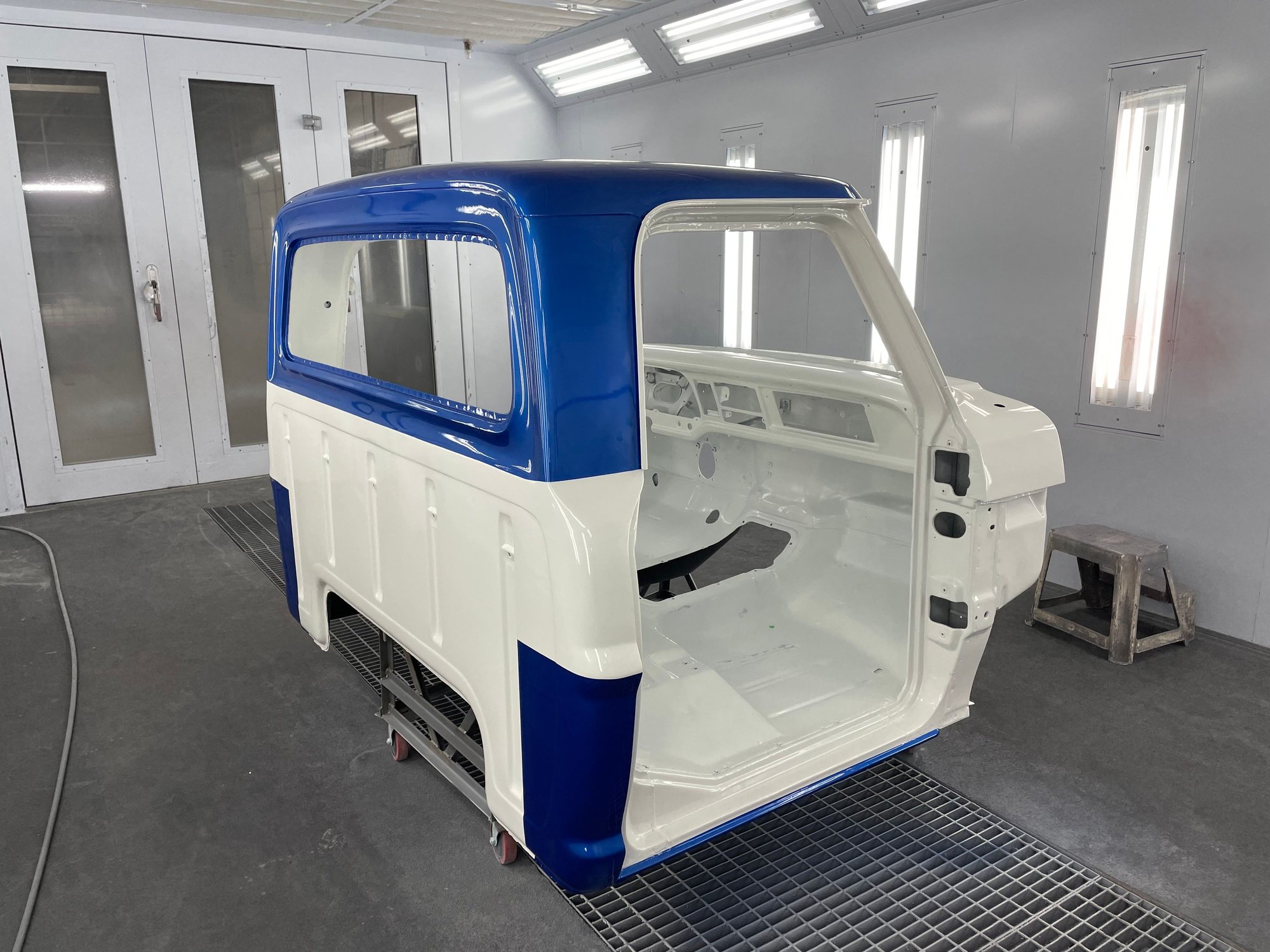

Got the cab painted yes
If you zoom in on the white you can see the metallics

Old Nov 30, 2024 | 04:03 PM
  #36
moto_hero's Avatar
moto_hero
Joined: Apr 2024
Posts: 812
Likes: 266
From: Laramie Wyoming
Wow the cab looks amazing! Great job!

Ids that Pearl White paint? That truck is going to be a show stopper!
Old Dec 2, 2024 | 07:46 PM
  #39
1971f1004wd's Avatar
1971f1004wd
Joined: Oct 2024
Posts: 162
Likes: 68
Yes ford paint code az It was on a 2024 expedition we just had in the shop. It has a slight blue flake in it along with silver and gold. The blue is ford paint code sz

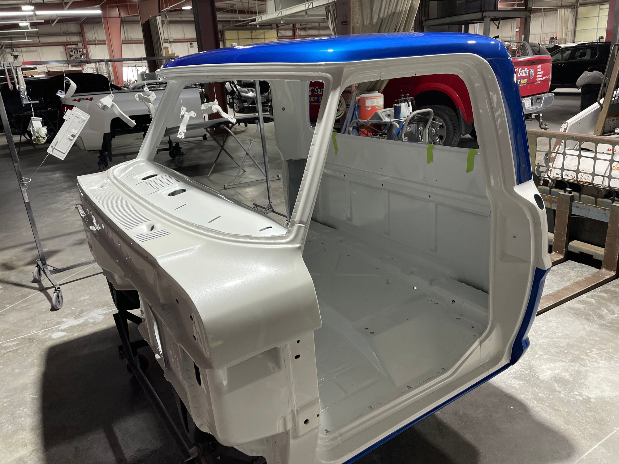

Got the rest of the front parts painted yesterday. The radiator support and wheel wells are also pearl white

Going to be an amazing truck when done!
