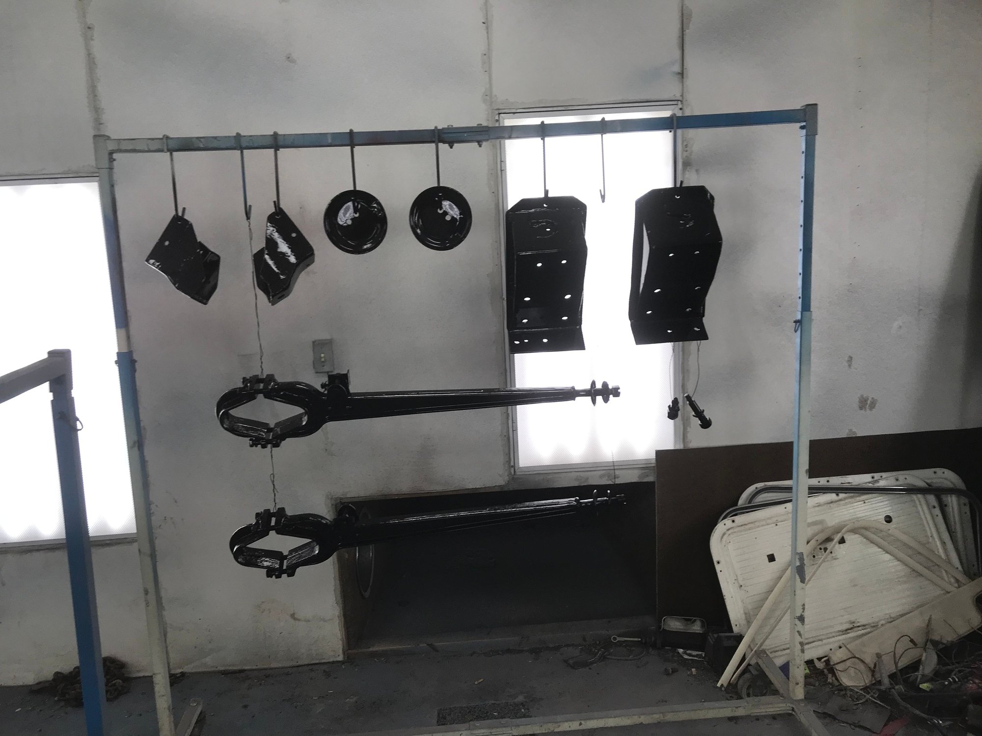

Got the new spring towers and shock mount brackets fabricated
