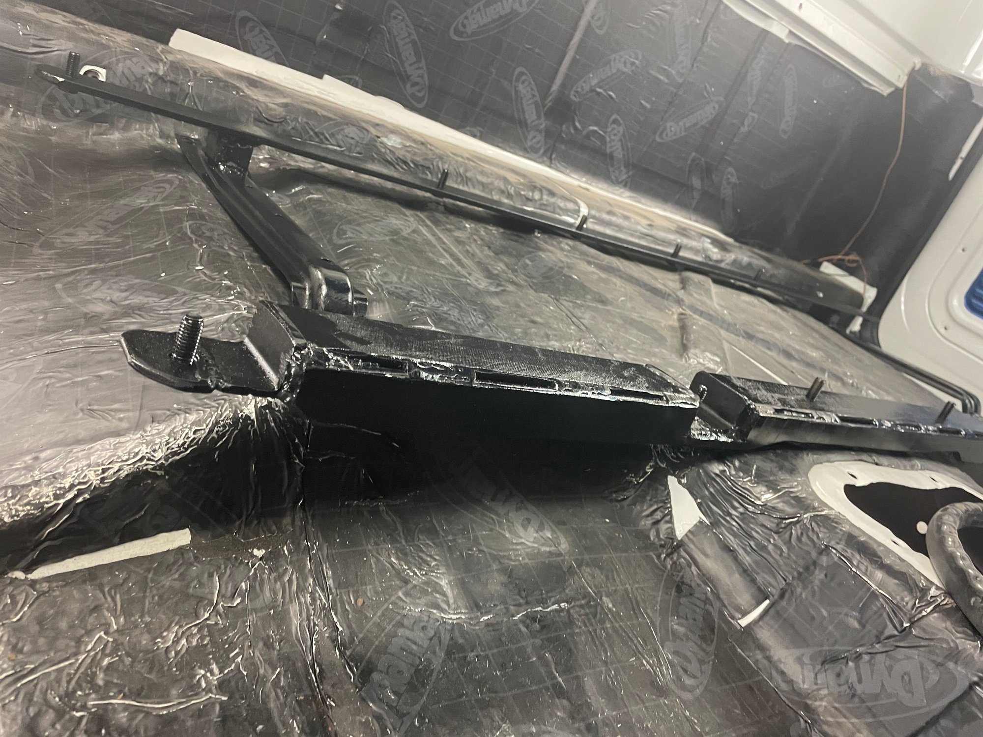

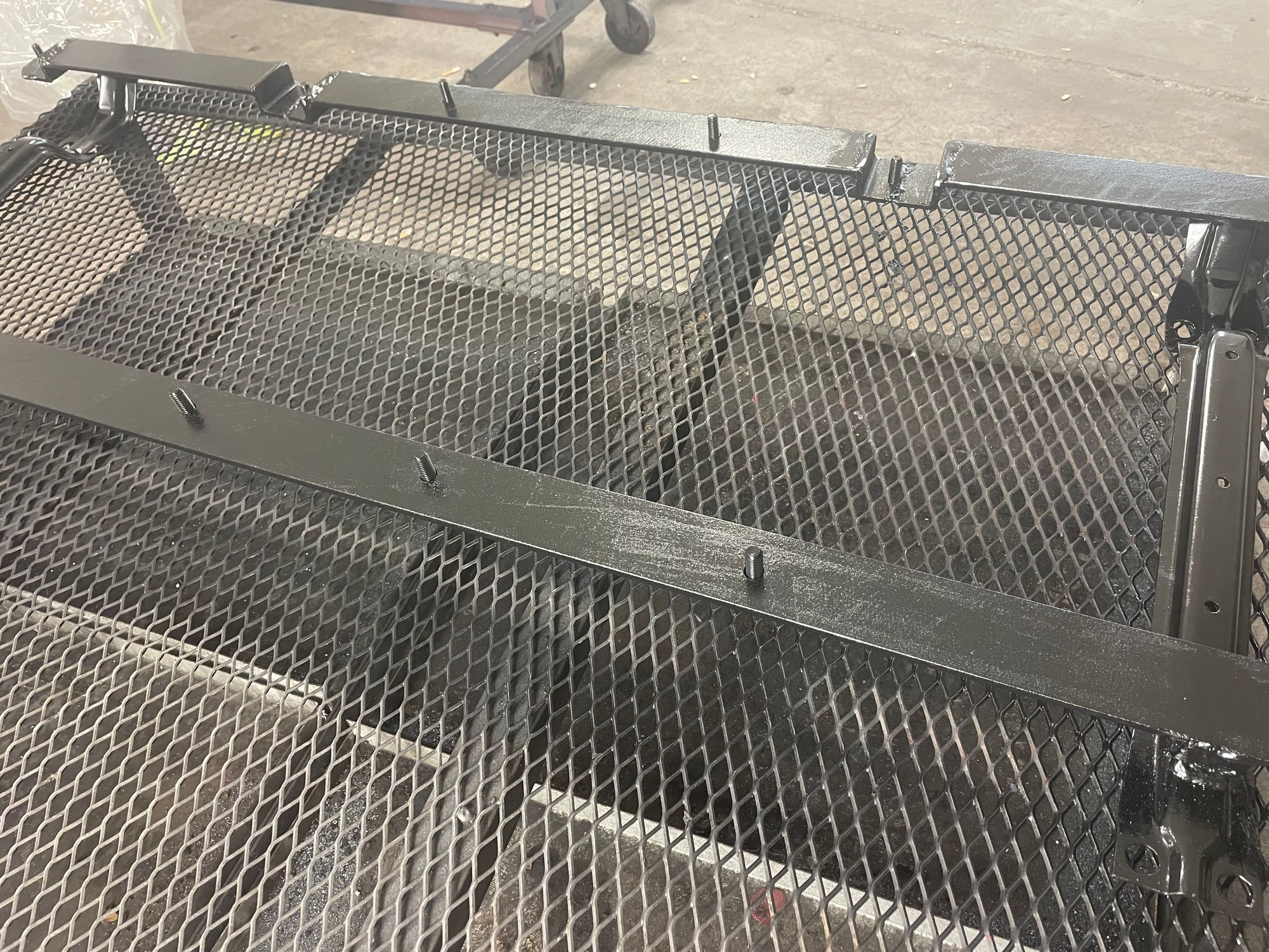

I would like to see your fabricated seat brackets. I would be interested in doing that swap myself.

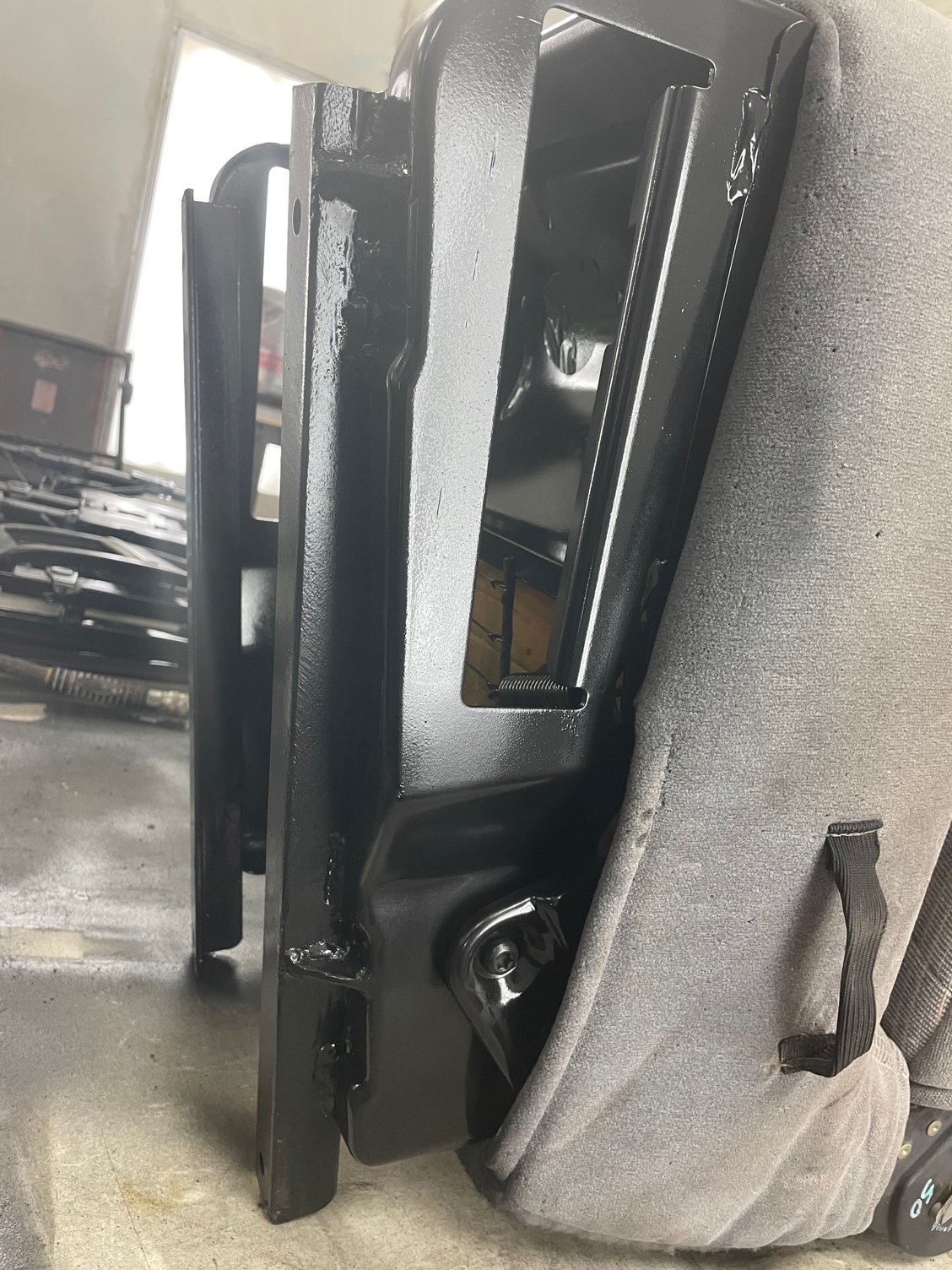

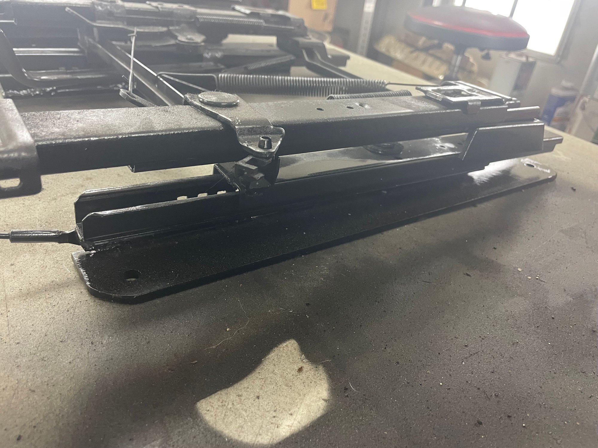

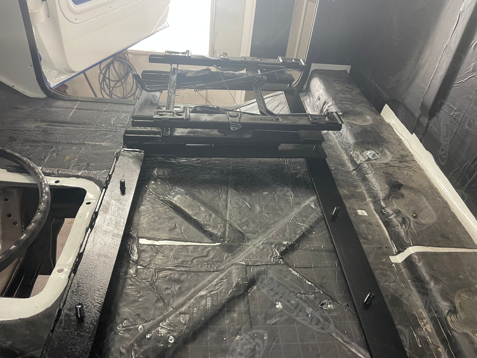

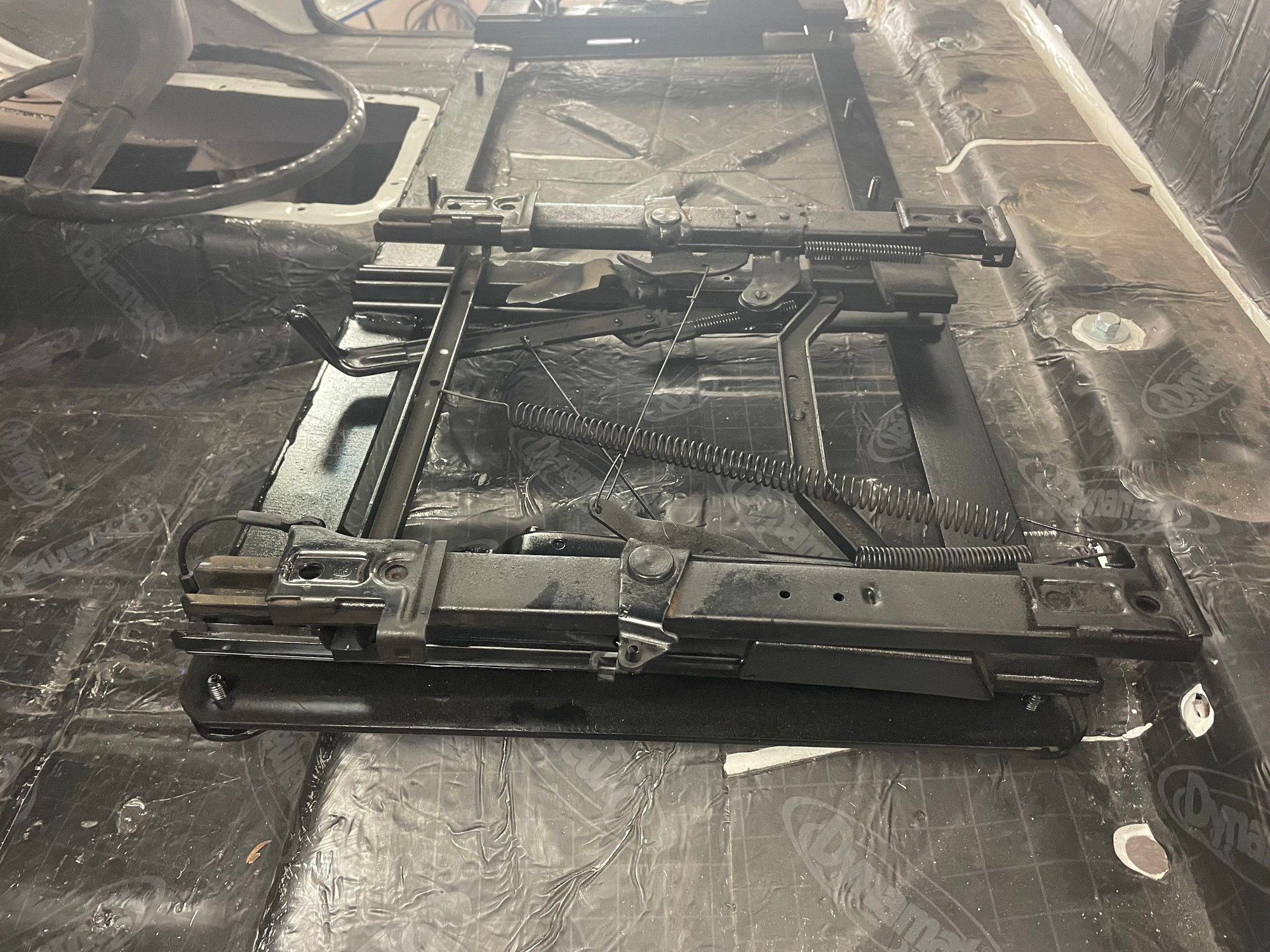

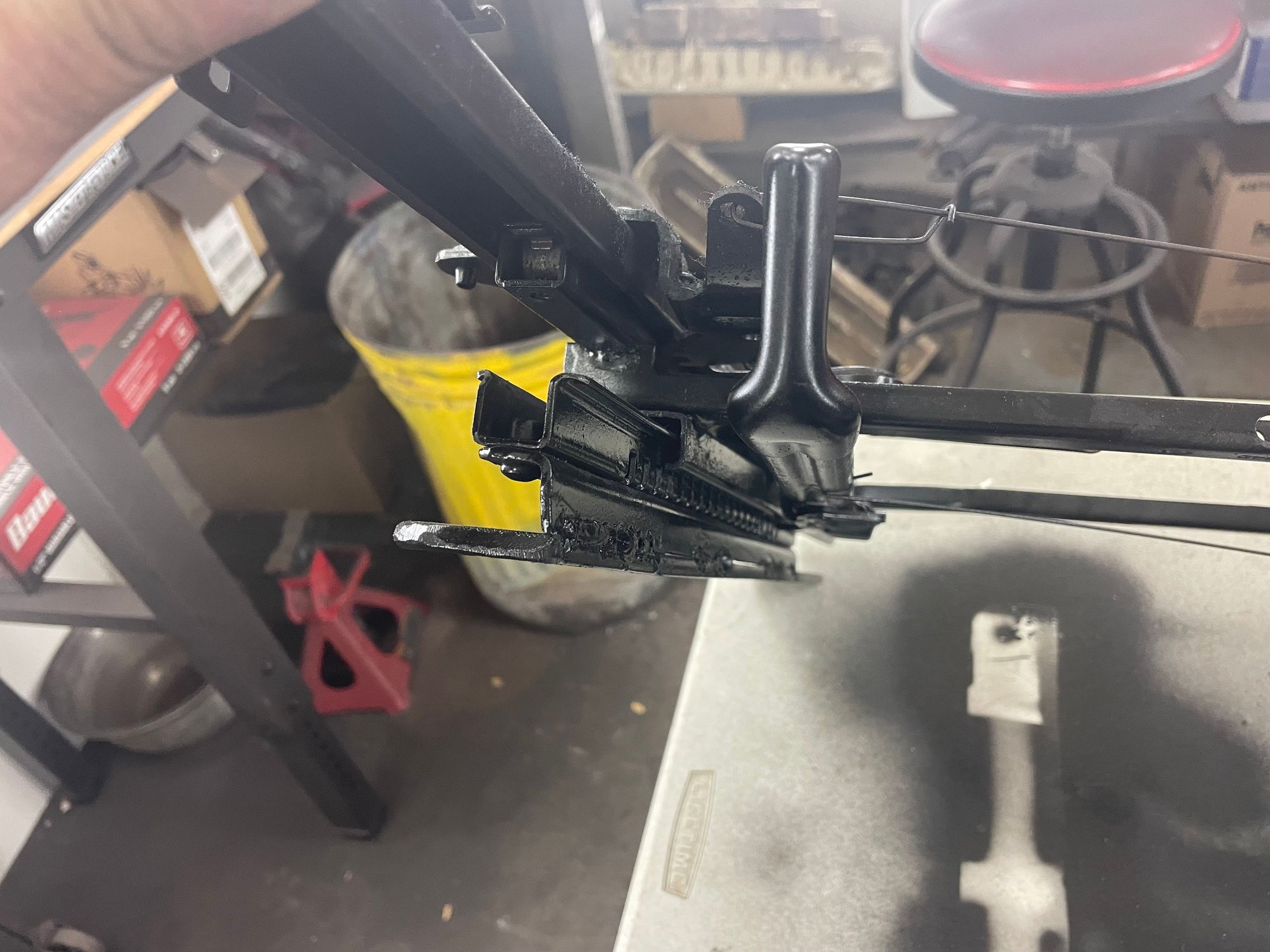

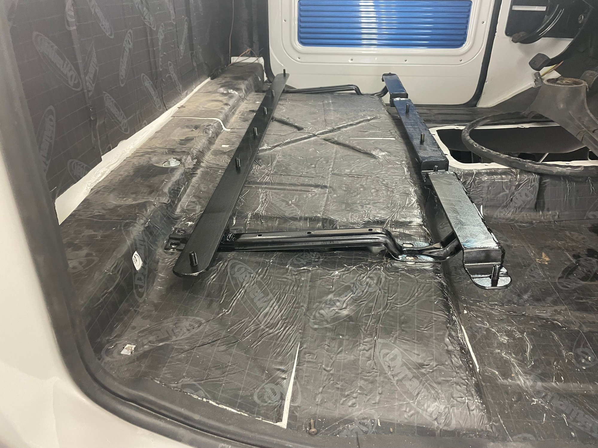

The long framing is the bottom support frame. The three seats will bolt individually to that

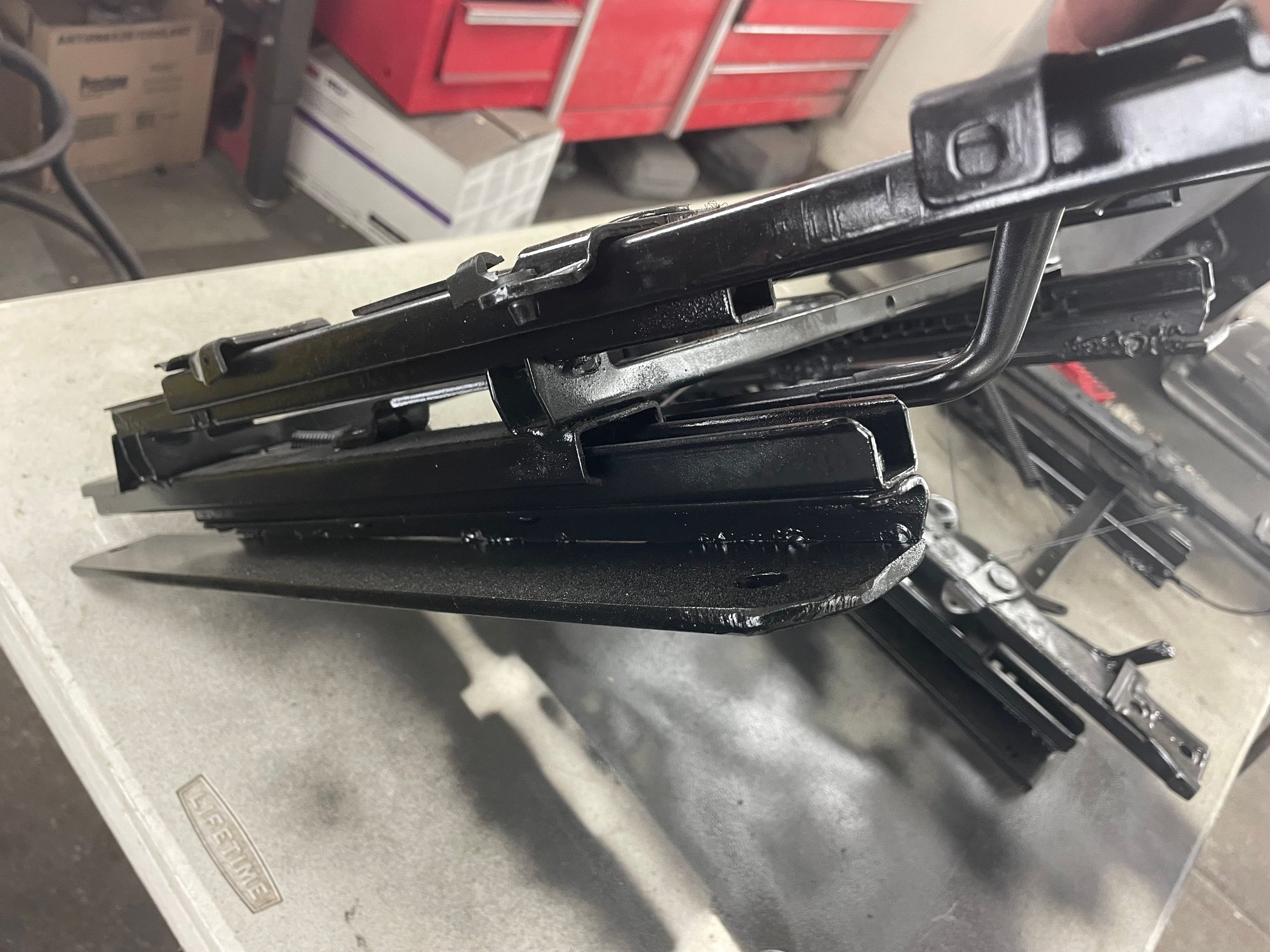

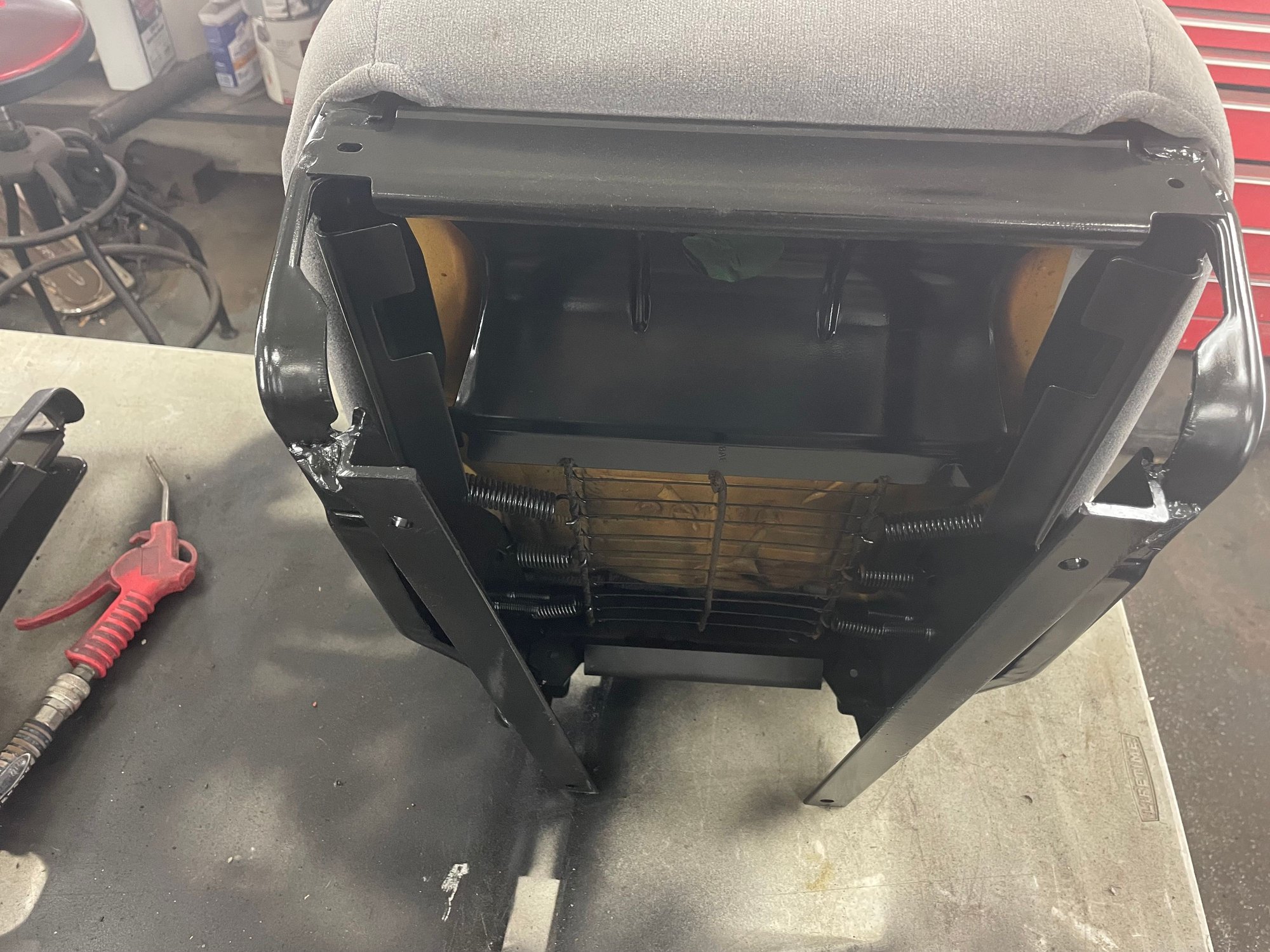

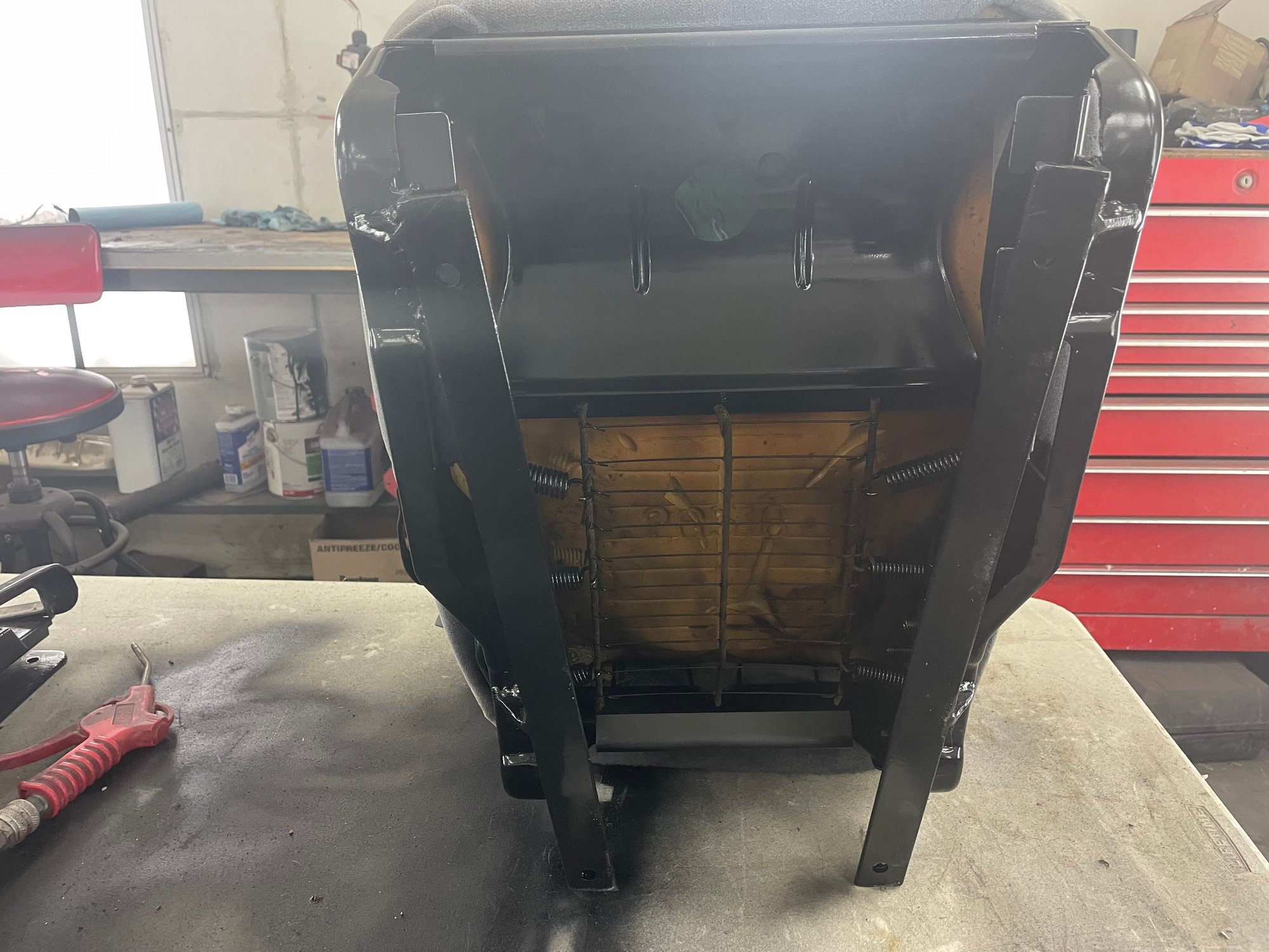

The hard part was getting the seats low enough. I’m only 5’5” so it’ll work great for me. Headroom for someone 6’ might be a little tight

Thanks so much, now I have some visuals. Looks like a great job as well.

These are perhaps the best pictures of any custom seat rails I've seen. thank you for these.
