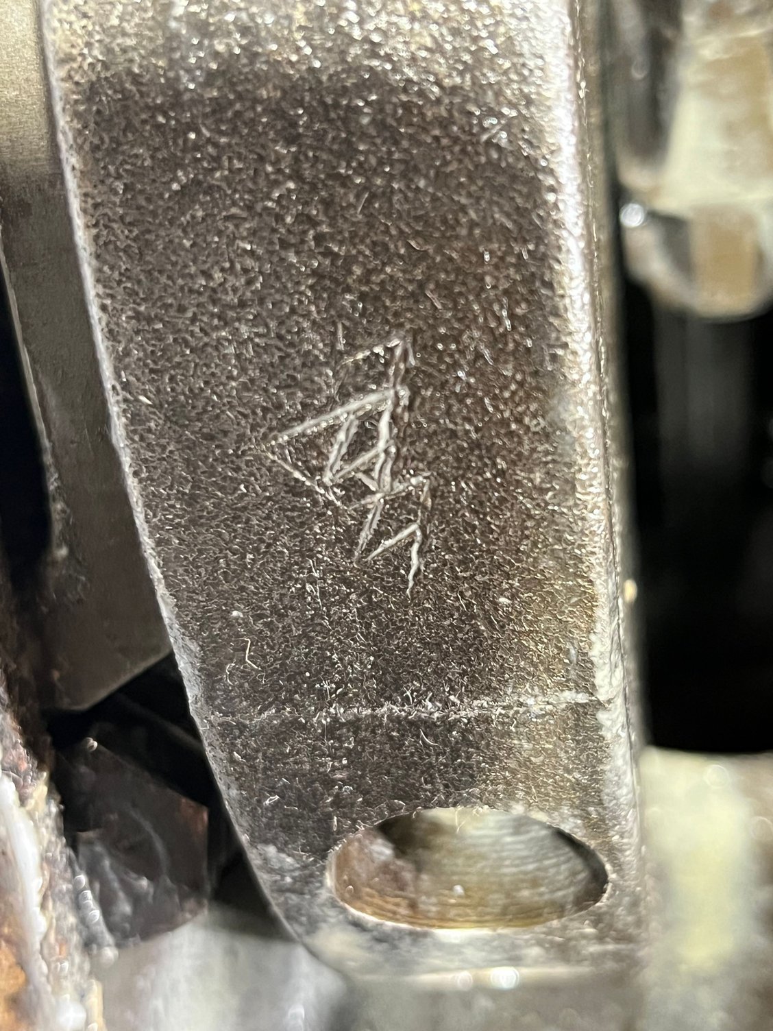

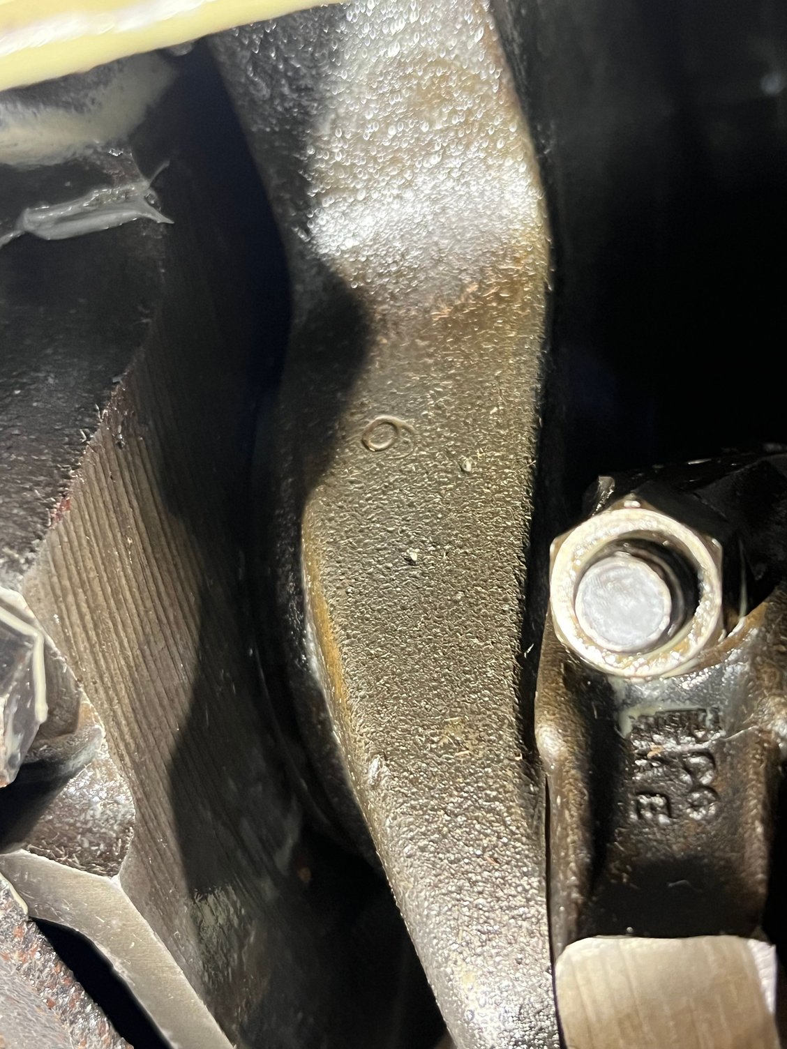

I have measured the stroke and diameter and the one I have is a 352 or 360 but I will send some pictures of the connecting rod with mark 6 or 9 and also of a strange marking that you may be able to decode

The first picture you posted has a date code. I can't make out the first character, but it read " _k23". If you can clean up that first character we can find out when the block was cast and get a better idea of what's up with that engine.
Did you measure the bore as well?
I don't know if that mark on the crank means anything.
The rods would be the "long" FE rod.

Here are the stamped 6 on the crankshaft and on the connecting rod is the mark C6AE and on the other side S61

Crankshaft: marked 6 or 9 and a special die-cut mark that is pictured in previous pictures
Connecting rod: Cast mark S 61 and C6 AE
