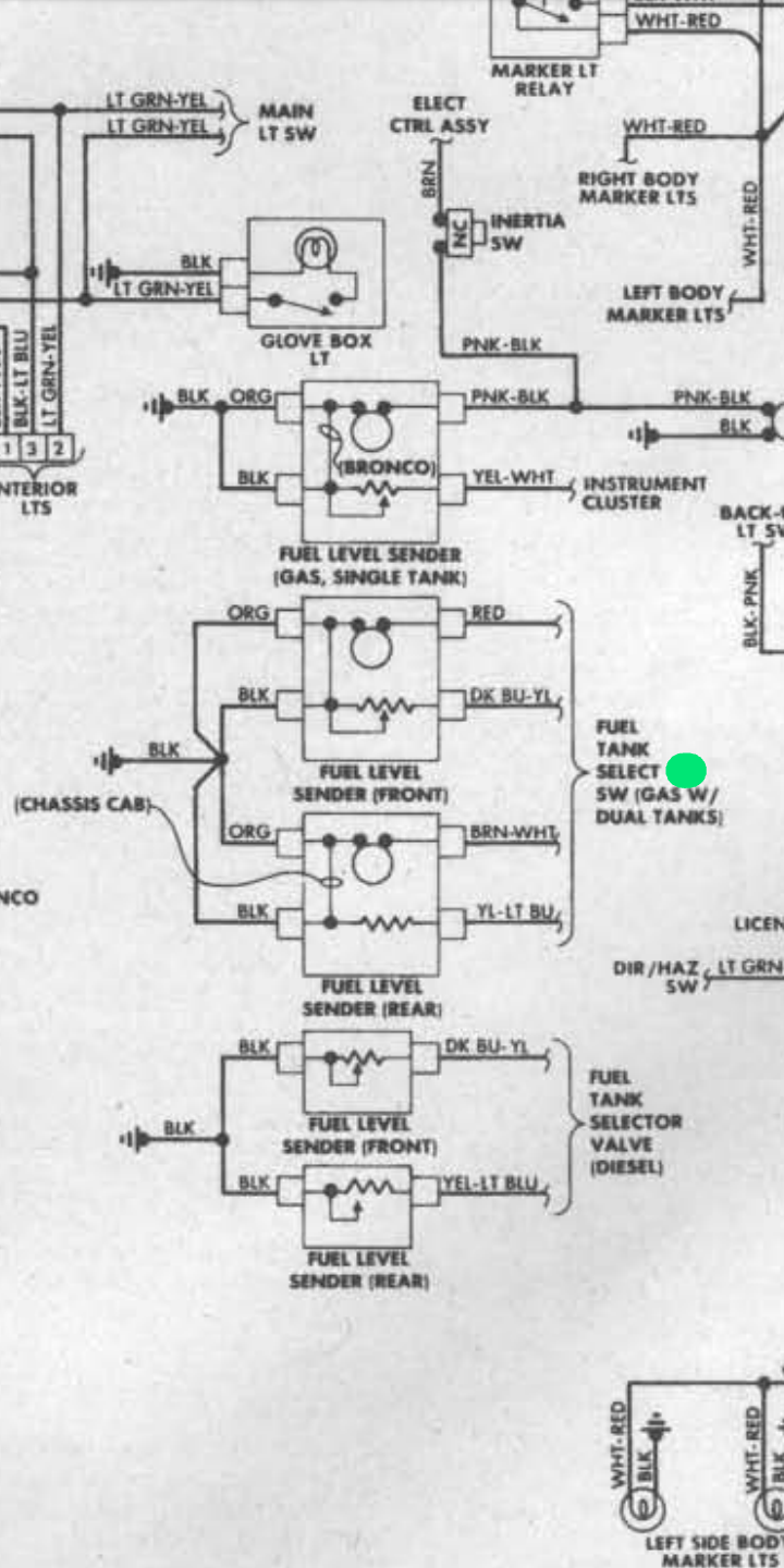

Does anyone know what the schematic is for the wiring on the plug on top of the front tank to the sending unit/fuel pump is? And where is the damned fuel pump relay located? I have a 1989 f-350 super crew, and I am already only using the front tank, as the rear tank is in need of serious cleaning. And a new lift pump. I need to run the pump on direct power, as I did with the rail pump. It works fine but I don’t have any other way to keep my truck running. And it’s my work truck right npw

Next to the EEC relay. On the left fender by the hood hinge.

From Haynes:
