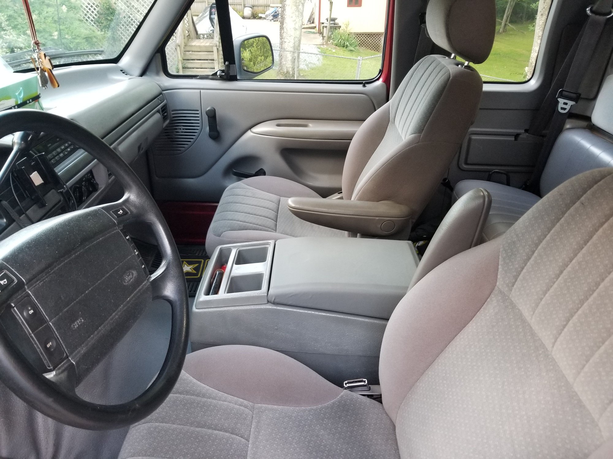

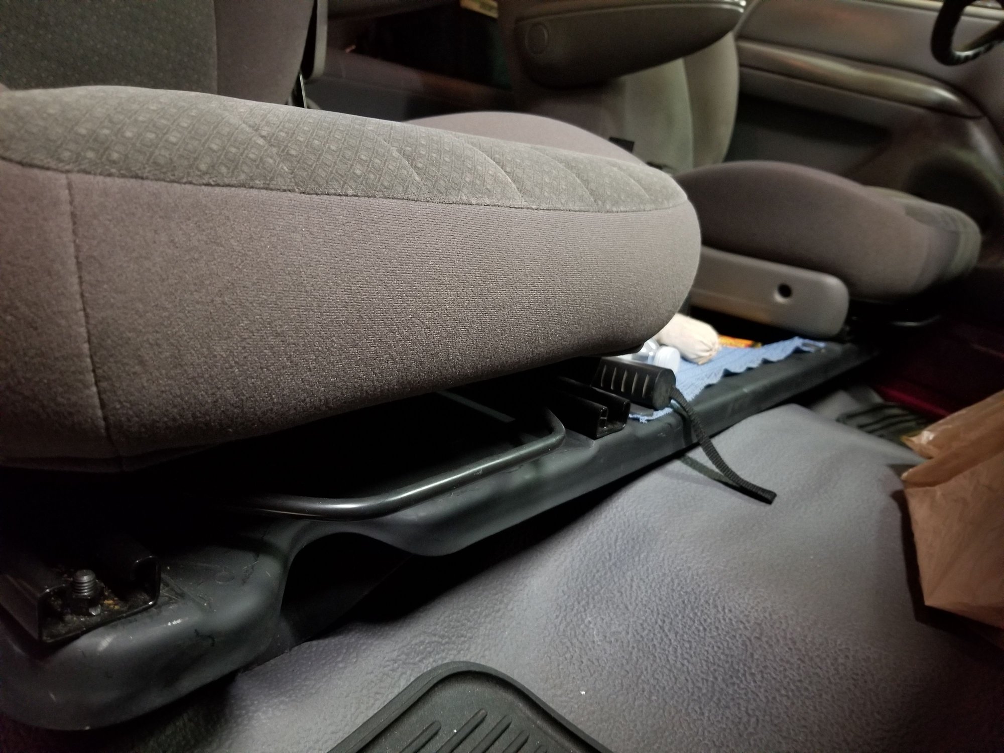

With your description, I am assuming that you have an extended cab. I have a 94 and it had a bench seat. I found out that there is a seat pan that is a direct bolt. You can then mount almost any bucket seats you desire.

That looks really clean. Nice interior.
Only bad thing about doing it that way is you don't gain the ability to adjust the seats independent of each other. Back seat legroom is at an absolute premium in these cabs.

Originally Posted by tjc transport
actually both seats are adjustable front to back IF you put the sliders in.
On top of that one piece seat bracket that spans the width of the cab? I would imagine that would put the seats uncomfortably high.
Actually, the seats do slide forward and backwards. I had at one time put in the bucket seats from an F150, but they did make me sit too high. So, I found another set that sits lower and I have to say, more comfortable.
Looks great!
Where did the seat pan come from?
Im not sure there were any ford bucket seats in '89 so not sure there is a seat pan that would fit like what you have?
Old Sep 18, 2024 | 01:46 PM
94Crimson's Avatar
94Crimson
Joined: May 2020
Posts: 30
I found mine on craigslist. I searched under F150 parts, seats, Ford seats, and bucket or truck seats. It took some time but well worth it.
