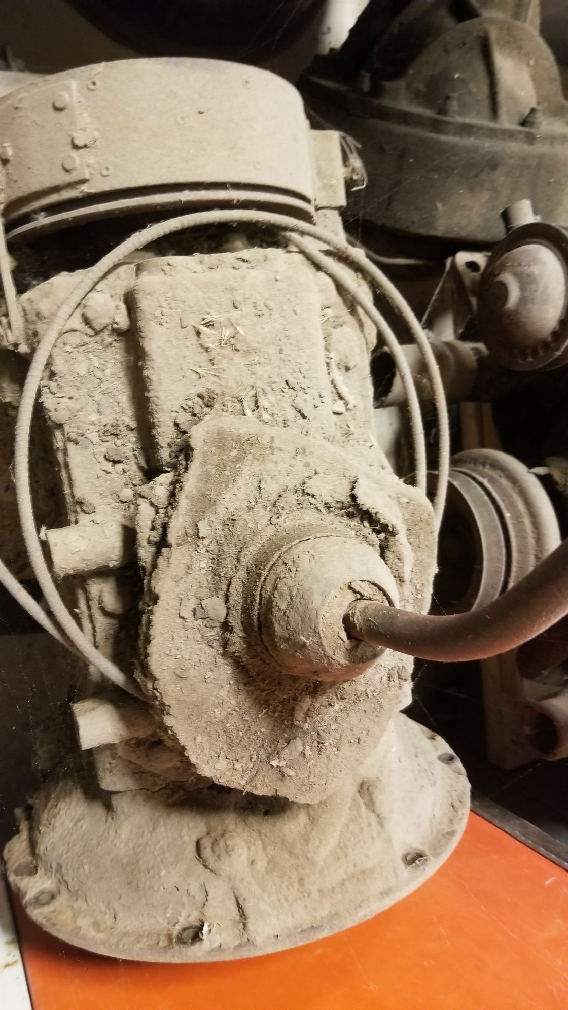

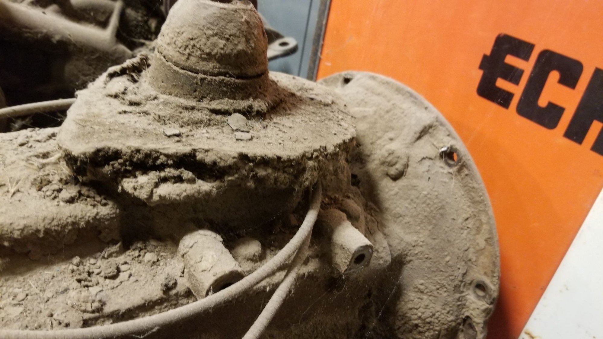

Whatever rubber boot offered by parts vendors that fits inside the floor is not stock or original to trucks of our era. To seal the floor from the outside, a large foam rubber pad sat on top of the transmission and the trans cover sat down onto it to seal the elements from getting inside. Here's pictures of the remnants of one, and the bottom of the floor cover panel.

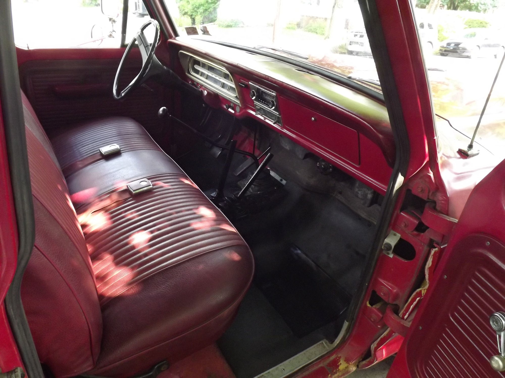

I had a 70 F350 with a flatbed dump from 2012 to 2016. It had a Ford factory bed. Whoever put the hoist on must have used a cutting torch on the floor for the PTO and lift levers. The guy I bought it from had old towels pushed in the holes to keep cold air out. I went to a local junkyard to look for shift lever boots. I got two from some small cars and screwed them over the levers and into the floorboard.
here youi can sort of see them. So if youi don't carre if its not original stock to yoiur truck, that is a solution.
