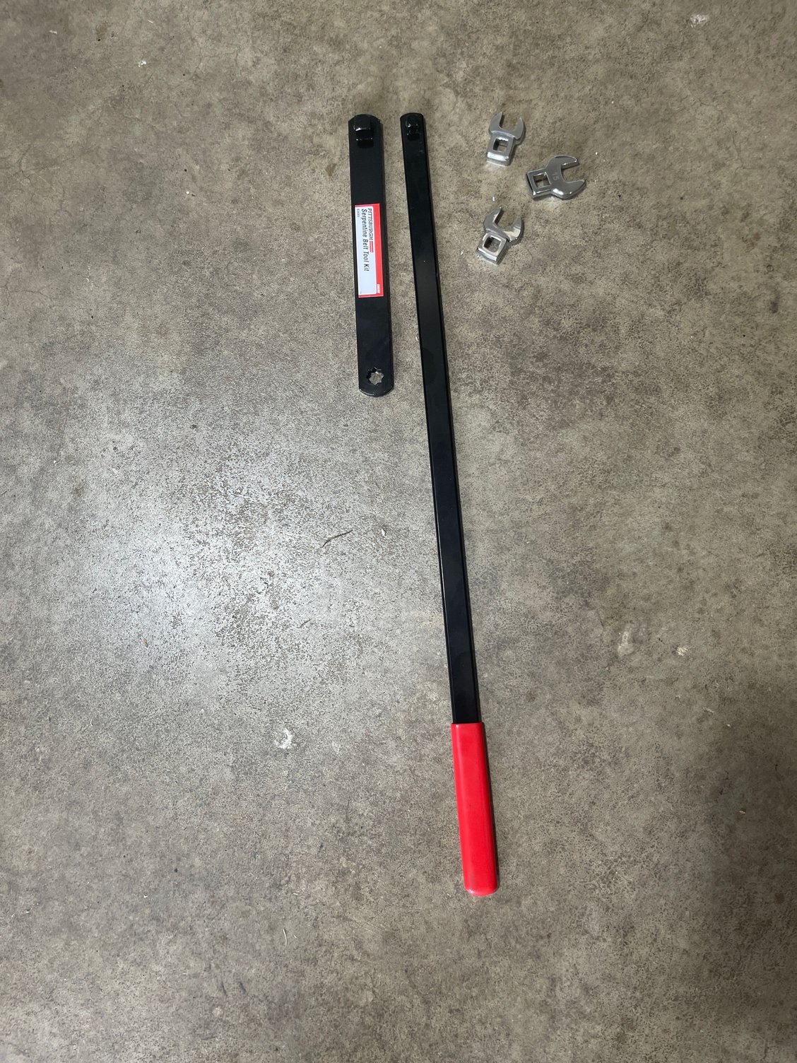

I just pull the belt up and off the pulley wheel then tie it off.
By no means easy, but much easier than lining up the square hole lol.

Harbor Freight has them too in the event you have a store close to you. This was a required tool to loosen the tensioner on a V6 Toyota Venza when replacing an alternator. Came with 3 sockets and 3 crows feet. There was absolutely no room between the inner fender/ strut tower, and the pulley. I’m not usually a fan of HF tools, but this one saved my knuckles.

I bought one of those and with the fan shroud in place (stator?) couldn't get the tool to work - I ended up loosening the alternator bolts and letting it tilt forward until I could get the belt off, then also held the belt up with a bungie cord and did the opposite to put the belt back on...
Glad I'm not the only one!
Take out the two front bolts, push down on the case and remove rear bolt, then let the alt tip forward. Easy peasey.,
