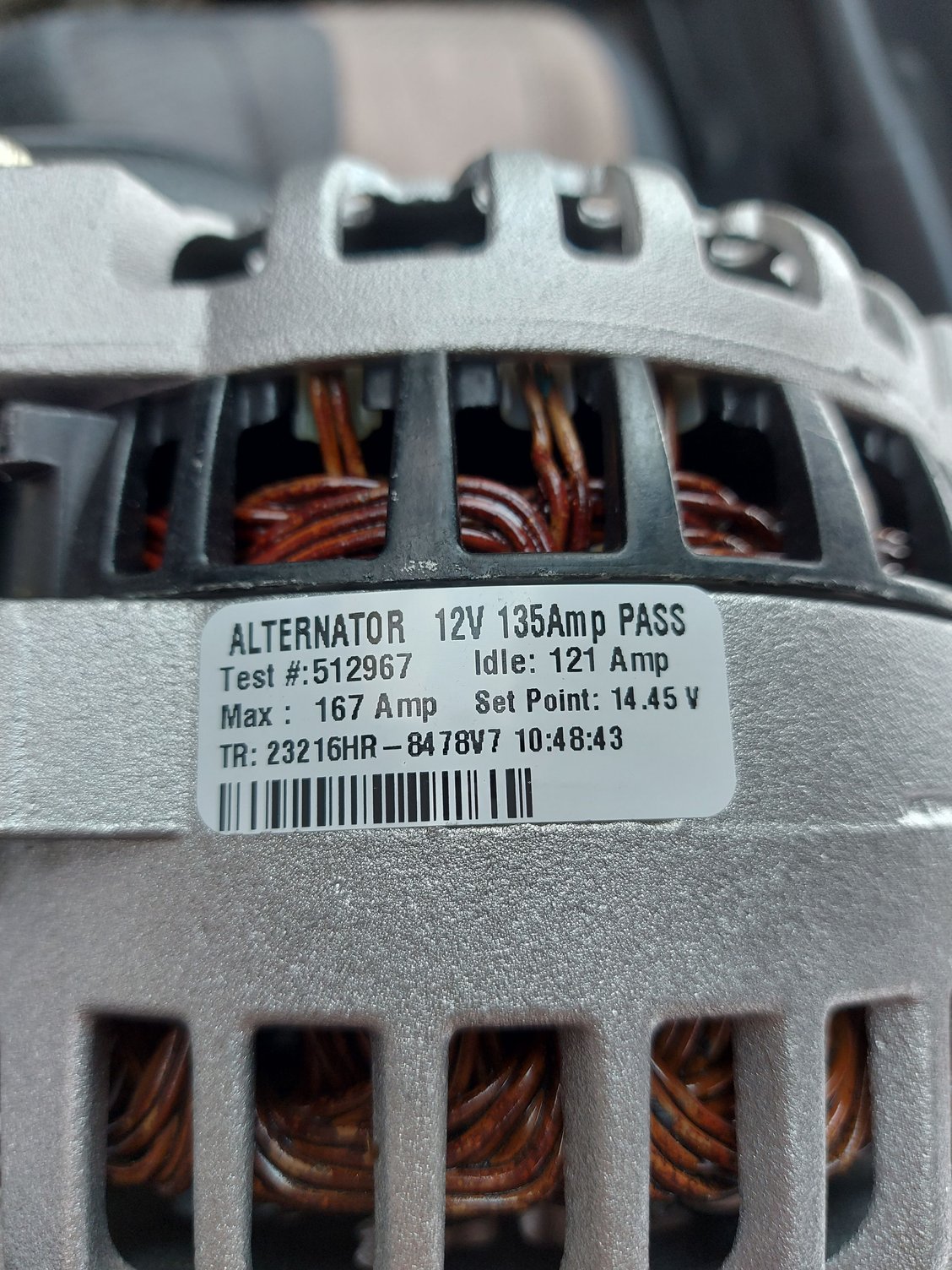

Well not sure if this is anything to be concerned about, but the reman unit I just picked up makes a good deal of noise when spinning the pulley wheel. Got the overdrive pulley put on and unit in the truck and just topping up the batteries for a couple hours then I'll start er up while monitoring the voltages via FORScan. Crossing my fingers here lol 🤪

The brushes are new and haven’t burnished to the commutator.

It's actually a 135amp and I don't have the part# on hand at the moment. It comes out to over 500CAD after taxes, but I get the friends and family discount so only paid 260CAD. It's keeping my voltage around 13.75-14 and both my FICM voltages mainly showing 14 and the other FICM voltage is steady at 50 so the Bosch unit was down quite a bit after only 1 year the POS!

Thanks Jack, They couldn't get the Bosch I wanted so I ended up with A NAPA reman (with limited Lifetime Warranty)
https://www.napaonline.com/en/p/RAY2133186D
It was $227 - (10%) making it $204 with tax. The "core" is $60 and I have one to give them so I'm keeping my OEM alternator
Here's the numbers:
Original ALT : IDLE---87A (GP's still glowing)..........2000RPM---125A
After GP drop out: IDLE---75A........2000RPM 60A
135A NAPA REMAN
IDLE(GP's still glowing) ----115A........2000RPM---160+ Amps
After GP drop out, currents were similar to the OEM ALT at Idle and 2000RPM
All measurements were aken with a Fluke 189 multi-meter and a Fluke i1010 AC/DC Clamp directly on the ALT output.
The actual alternator swap was of course pretty easy, and took probabl6y 15 min or less.
Getting my 1/2" ratchet on the tensioner took me almost an hour to get the square peg in the square hole because it's nearly impossible to find the hole and I kept burning my arm on the components close by!! And of course, the square hole doesn't "line" up right to use a "breaker-bar"
It was pretty frustrating! Nice that they supplied a "kick-stand to hold it once it was moved far enough. (I couldn't pull the belt far enough to move the pensioner enough.....Maybe if I had Tyrus here to do that!!)
Anyway, it looks like the 135 will do the job!
