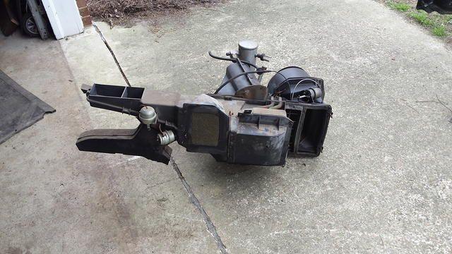

I can tell you I am happy I got AC in my truck because right now it is 97*f & 50% humidity and they say it will hotter the next few days
I know you can remove 1/2 the box in the engine bay to R&R the evap coil as I have done that with the truck all together.
Now when I R&R the full box both inside and engine bay I did not have the front end or dash in the truck so cant say how easy or hard it will be when together.
I would say start with the parts truck and experiment on how it comes apart so if you break something it will not be that big a deal.
The inside box is the only part that may give you a problem as the dash may need to be un-bolted.
It has been a while since I messed with mine you have screws across the top in the defrost vents, 1 bolt at the bottom to the kick panel on either side and 1 in the center from a brace from bottom of dash to firewall.
You also have the steering column / pedal bracket to bottom of dash.
Now if you dont have to replace the inside half maybe leave it in place but think some of the bolts that hold the 2 parts together you have to get to from inside.
I dont think you have to this crazy on removing the dash.
All to get this assy.
Inside truck side
Engine bay side
Firewall where box bolts up to

Fuzz thank you for the pictures! From the pictures looks like i might be able to remove the box on the engine side. Retired (73) with more time and would like to get this old truck 81 F250 with trailer special package running again….has been sitting for quite a few years, could never get rid of it thinking i want to fix it up…

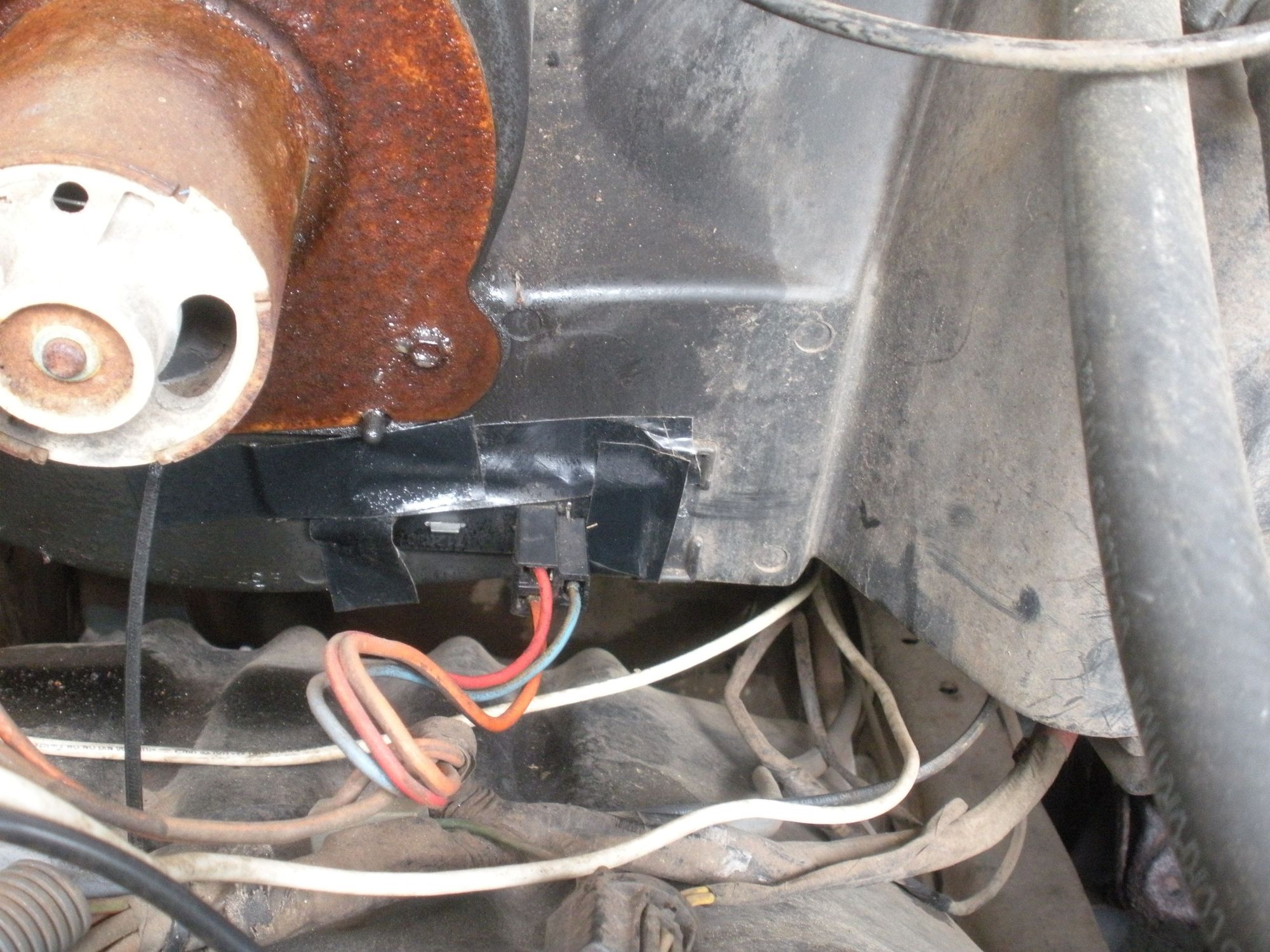

Ok, just saying, this has worked for me for many years, but I don't drive my truck much. That's a resistor from a mid 1970's Jeep. I don't have AC and Ford stopped stocking the OEM part, all they had at the time were AC resistors. I paid $6.00 for that one. It's a common part that you can find if you look around.
