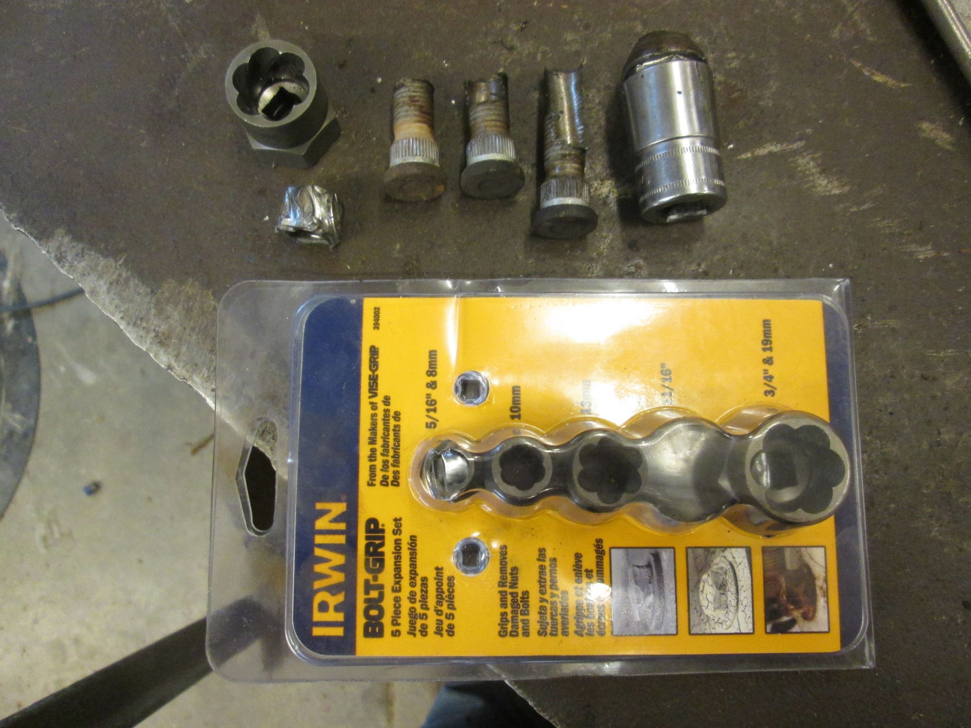

The day after my daughter got new tires on her car I was going to do a through brake inspection and put the car on my lift and went to remove the wheels, a broken snap on 1/2" drive socket, lug nut sheared in half, several chrome lug nut cover removals, 3 drilled out studs, a couple gallons of sweat and 5 hours later I had the wheels off.
I bought a set of the irwin bolt grip striped nut remover and was very impressed, that thing gripped so well that the lug nut actually sheared in half and it never let go.
Called the tire shop and they said that they always use a torque stick but they did offer to pay for the damages.
