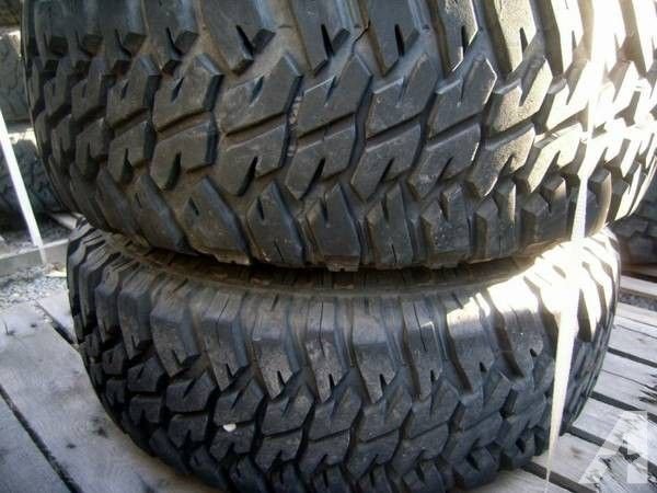

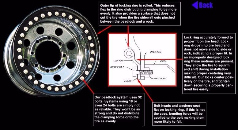

Did you get the 36x12.50x16.5 tires Goodyear Wrangler R/T II? You know those are bias ply, drive like crap (IMO, when cold they will have flat spots and be out of round until they warm up), and have bad wet road manners. See bottom pics. As far as the bead locks, those are double beadlocks. And either have the magnesium 2 piece bolt together insert or the rubber one piece run flat inner tire. And those can be a PITA to get out of the tire. Like ratchet strap the tire to a telephone pole and use a truck to pull the insert out of the tire. No the beadlocks do not hurt the tire, they just clamp on the outer part of the bead . On the Turbine rims you know you will need Mag seat or long shank lug nuts with the washer due to the thick face of the rim.
Yes they look good. Beware that you need to put some grease or anti seize on the back face of the aluminium rim where it contacts the steel hub. Area prone to dissimilar metal corrosion. And be ready to torque your lug nuts OFTEN. The alum rims have a habit of loosening up lug nuts. Why?
See his tires?
No I am not saying NO to them or 16.5's on a truck. I bet the tire shop guys are probably gonna want to say NO. I have 6 brand new never mounted 36's, but BIAS ply tires suck if you ever drive on pavement. For off road trail ruck all the time, you will not notice the bias ply as much. Pure trail rig you can cut groove them and make them a pretty good tire.

No, the beadlock rims do not do anything to the bead of the tire. Disassemble the beadlock to take the tires off though- do not try and use a tire machine to stretch the tire over it as there is a runflat assembly inside the tire that will NOT go over the rim. You have to disassemble that after you have the tire off the rim.
