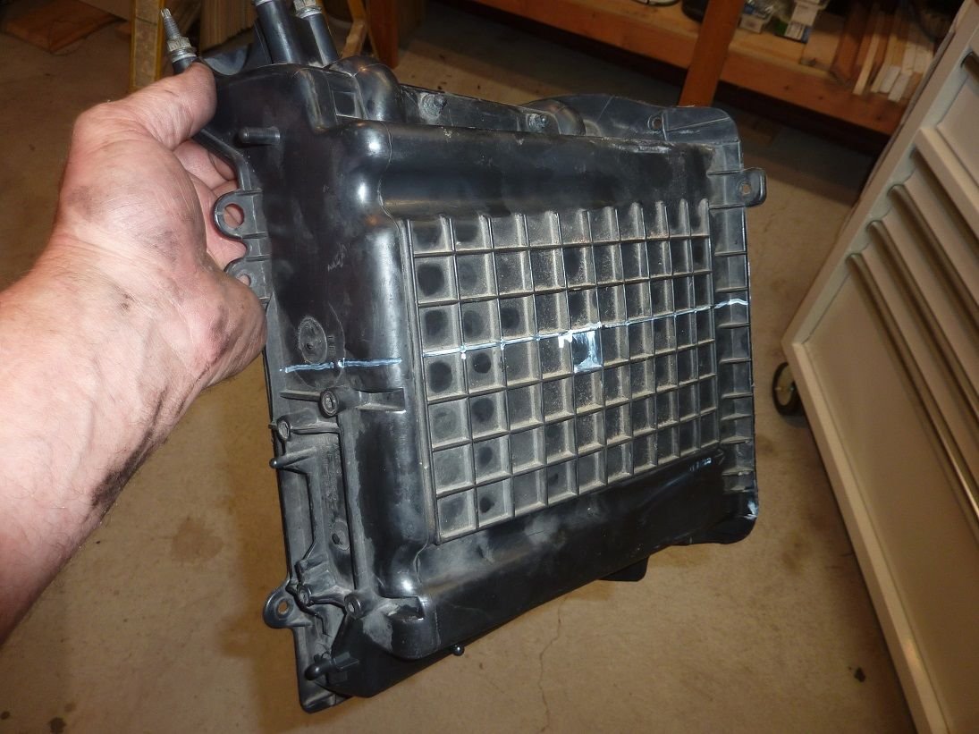

And just so credit is given where it is due, I am also stealing Jack's 2-piece air box cover mod. I'll be cutting it above the line, half way to the next rib. The plan is to hold the two sides together with 304 bar stock and screws and foil tape the seam.

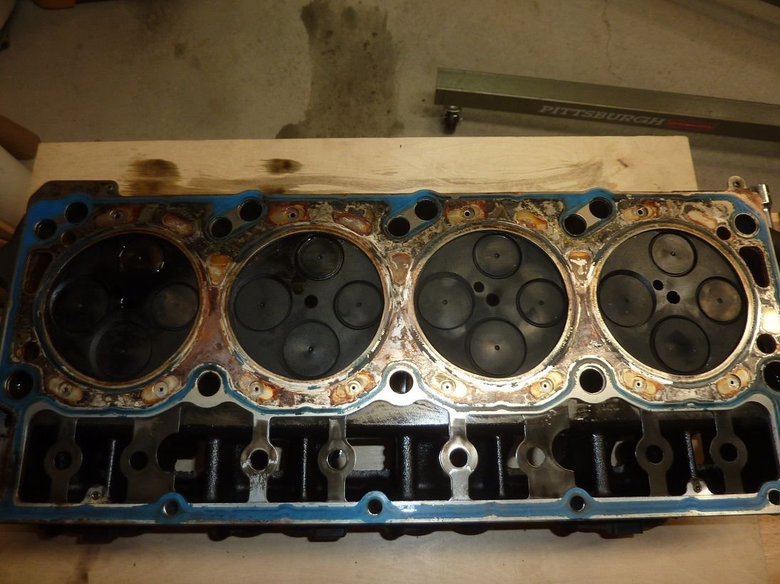

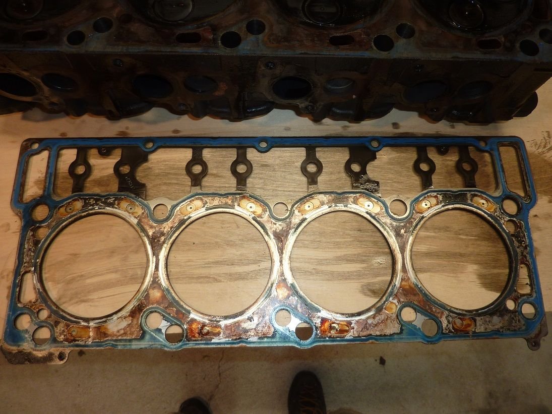

Pulled the right head:
Cross hatching still looks good after 296K miles:

I would pull the engine out, you can do it within a day and all the work required is much easier and better to do on an engine stand (including closing the holes in the block deck). If the block deck shows surfaces like the ones in these pictures after the first cleaning, these surfaces are difficult to improve when motor installed, the room is simply too narrow.
In my opinion it is also much easier if the engine can be rotated so that the block deck surface is horizontal.
