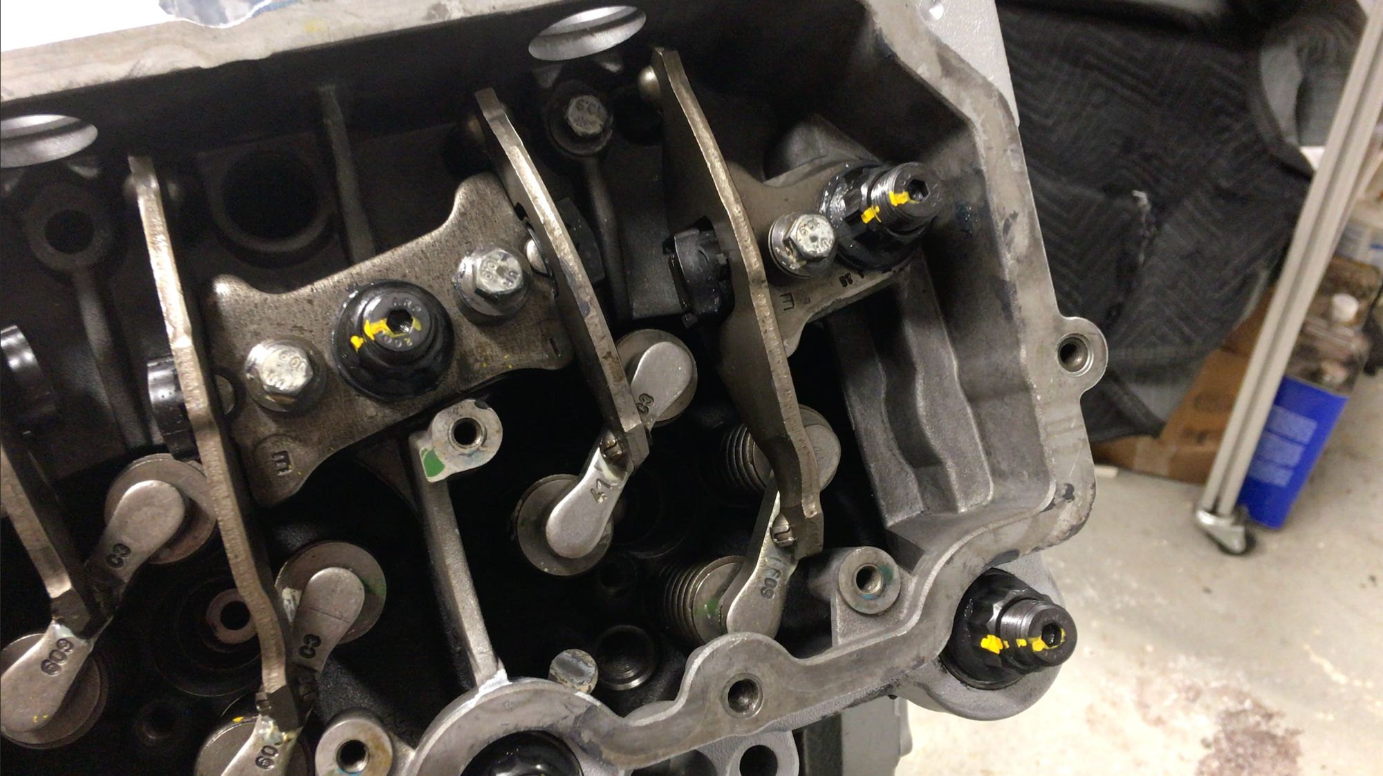

I did mine in five steps, with a minimum wait time of 30 minutes between the fourth and fifth sequences.
I did that to have a more even step up in clamping force. It's well-known in engineering that there is a period of relaxation once a fastener is tightened down. So, if you do the last step right after the last one, you may not end up with a full clamping load. You can use the same principle by doing a final torque check 30+ minutes after the final torque. This is especially true when dealing with a gasket between the two clamped objects.
I also used a permanent marker to identify where I ended up so that it's easy to tell if the bolt or stud ever backs off.

Well I didn't want to wait, so I did 65, 135, and 210. I'll go back over them to double check.

Most people do that. I took a different approach. It's also not a bad idea to plan for a recheck after some heat cycles. However, any fastening engineer should take that relaxation into account during the final step and consider it will settle where they want it to (clamp load).
The best way to do a post-initial tightening check is to back off 10 degrees or so and re-torque to the spec. Just going to the 210 lb-ft value does not consider the break-a-way high static friction you have to overcome unless the relaxation is so significant that the static friction is under the target.

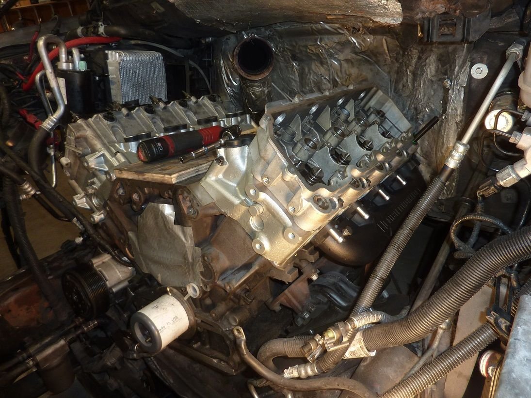

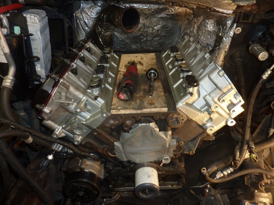

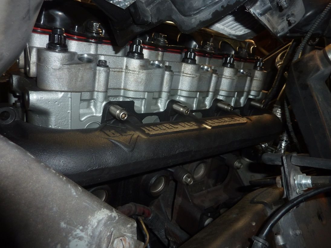

Got the right side buttoned-up.

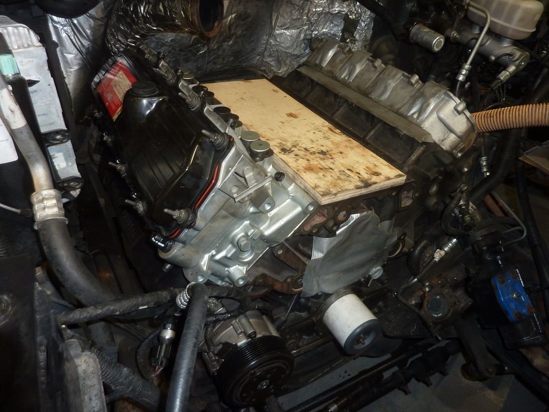

Plenty of room with left side of engine jacked-up about an inch.

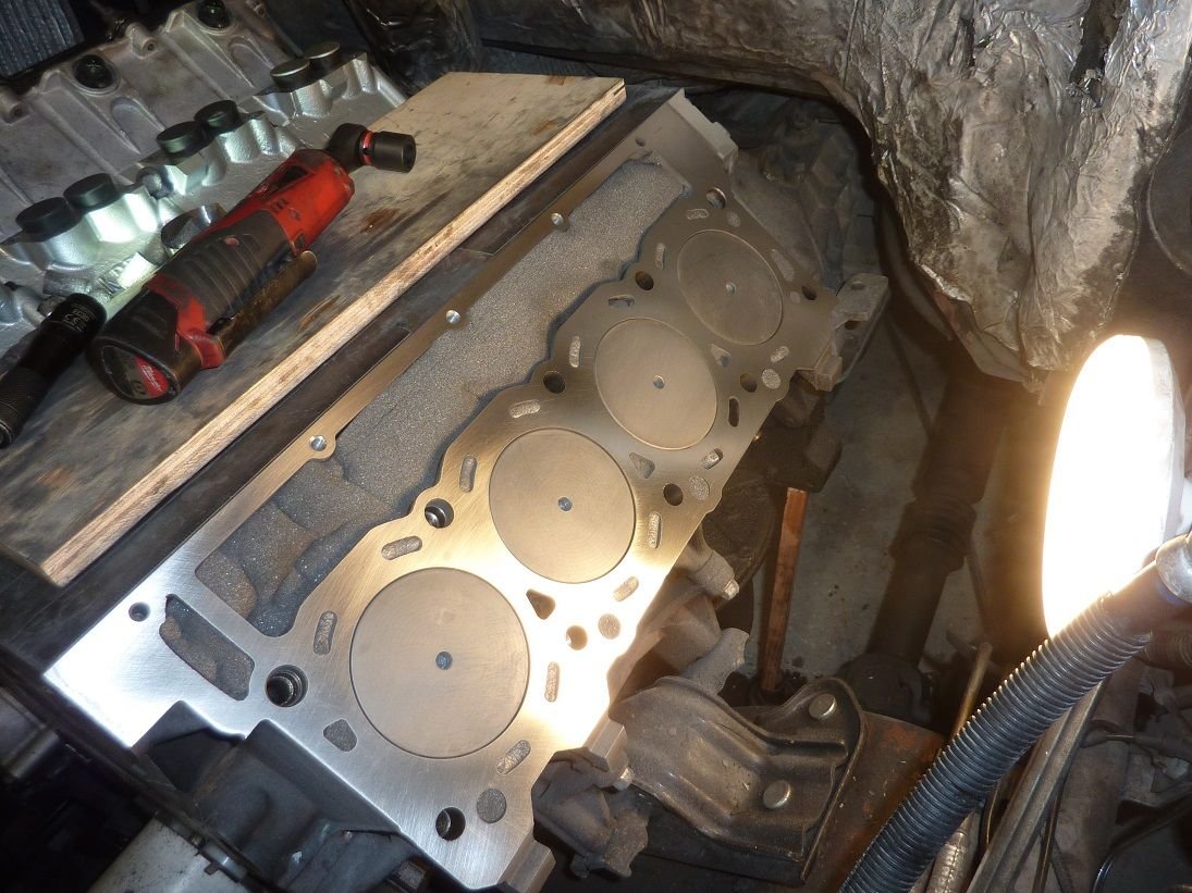

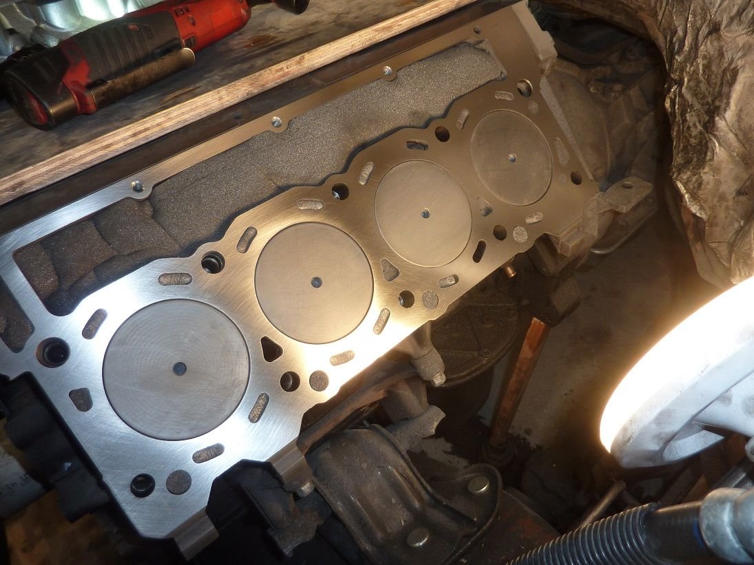

The hard part is done

Both of those surfaces looked great, Chris. I'm curious: How many hours did it take you to lap them while doing that in-cab?

The first side (right) took about 7 hours. The left side took about 6 hours.
For my own piece of mind, I have to pull the left head back off to make sure I got all of the foam pieces out of the water jackets. I'm 95% sure I did, but I was rushing, I was aggravated that I had to fish out a few of them, AND I gashed my head on the corner of the degas bottle mount while I was fishing one out of the back cylinder. So I was a little distracted.
I have only tightened the inner row bolts hand-tight. Hoping I can reuse the head gasket.
