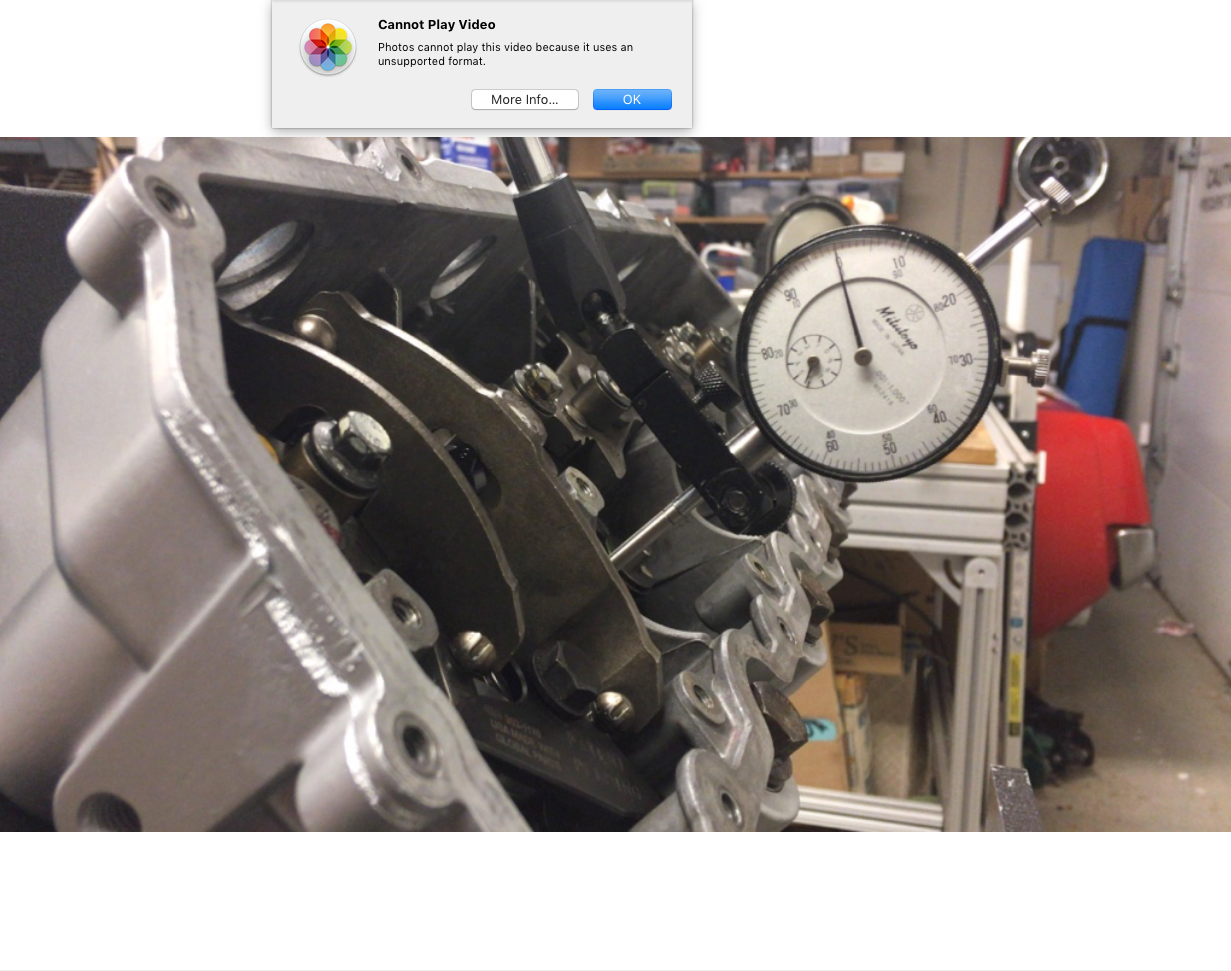

Actually, what has really screwed me up to this day is I was doing all my Powerstroke things on my 2011 iMAC, images, and video, and I had a hard drive issue; or a software issue. So all the top-end building of the engine is screwed up, and I haven't found anyone who can correct the mess. Apple software for photos and videos is not like Windows. I had 1.6TB of files; I now have 0.6 TB.
So worked on my 2017 iMac post-install and tried to recover what I could, and another hard drive issue screwed the iMovie projects up. Notice the blank segments.
And then the destruction at the farm from the kids, me falling down the stairs, and Leslie's two emergency surgeries, I'm not paying much attention to 6.0L things.
