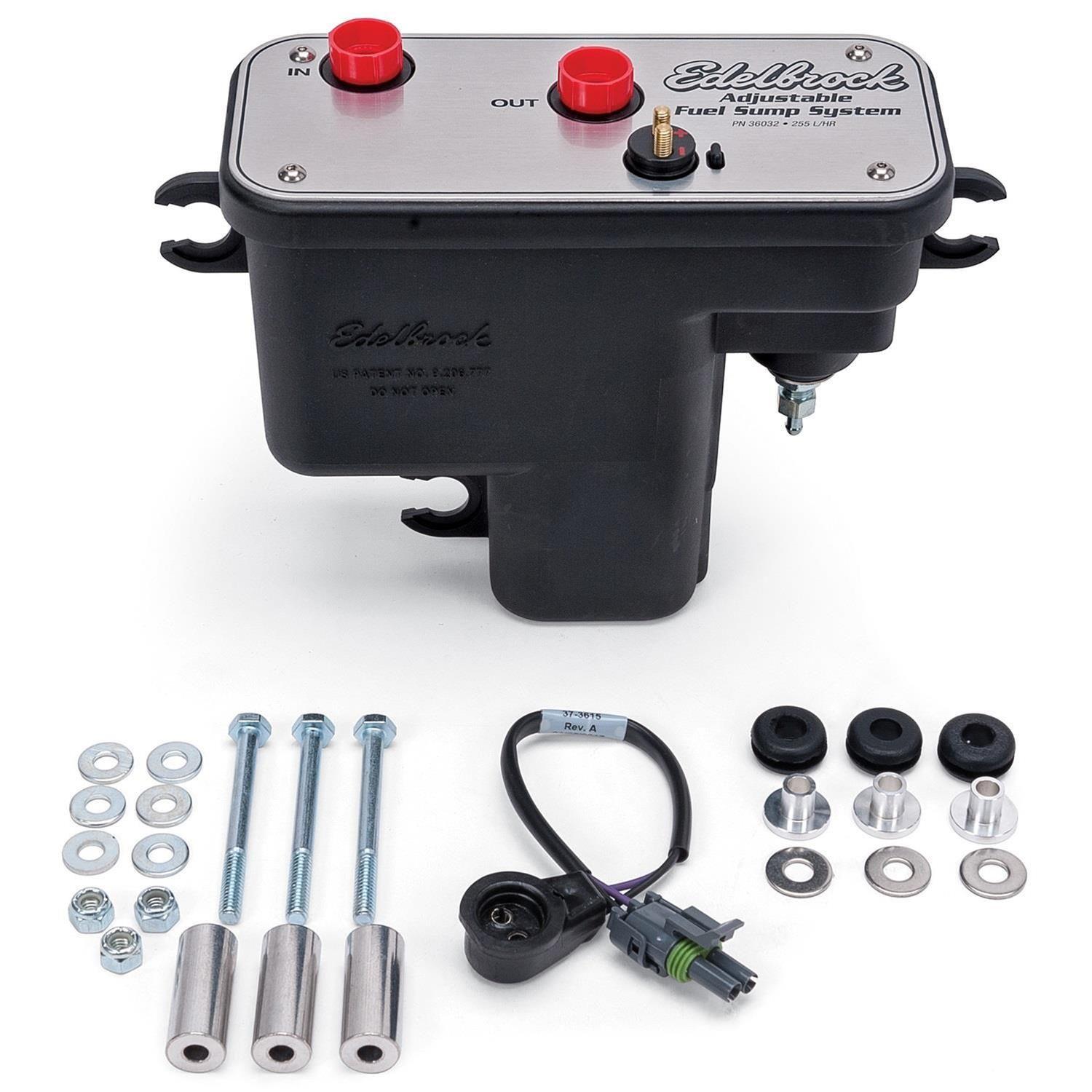

This could do the trick.
Edelbrock Universal EFI Sump Fuel Systems 36032

Joined: Sep 2017
Posts: 203
Yeah, I thought about those... but I don't know that I can hide one all that well. And I've worked and thought considerably about making this thing look some kinda way. ha! Even though that way is rusty with bits of old school brilliance.

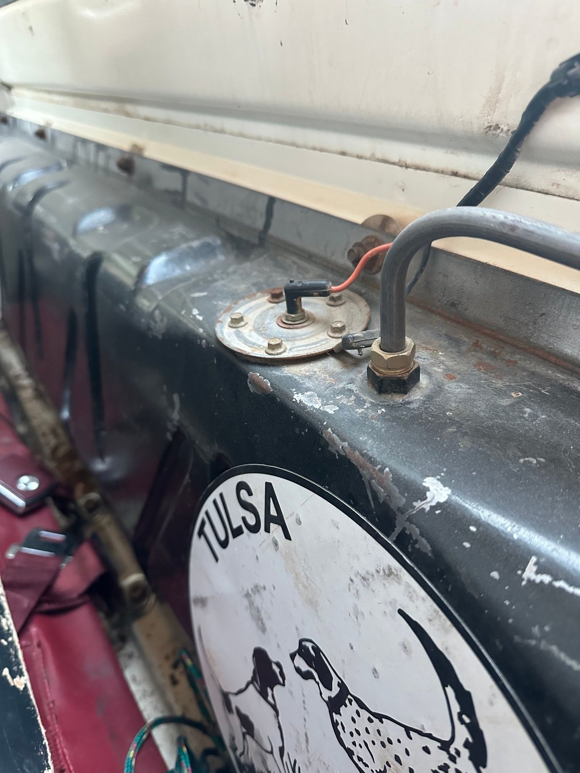

Yup... already have one... no problem with that. Just trying to figure out how to plumb the fuel line without drilling the tank. Or rather making sure i am not missing something before I do.
For instance... this something like this with a fuel pickup built in. Not a pump. Just the pickup.

Posts: 203
Fuel line is fine.... gotta have two. Return line is required for EFI setup. Something like so is what I am looking for. I might try to drill the existing sender. But space is pretty tight.
