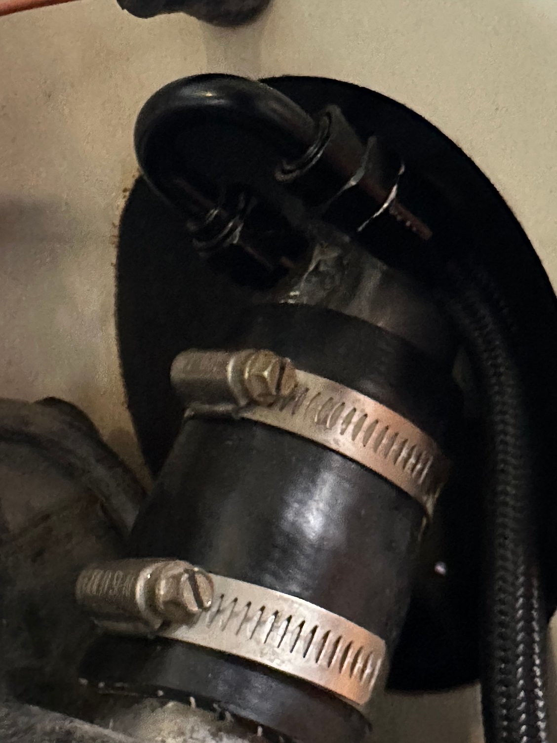

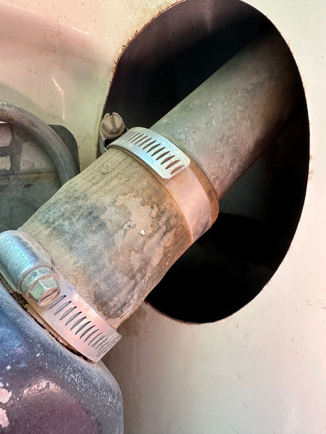

What about adapting the Sniper return line in the filler neck? Does it have a piece of rubber inside the cab? Or even some solid piece of filler neck too splice into?

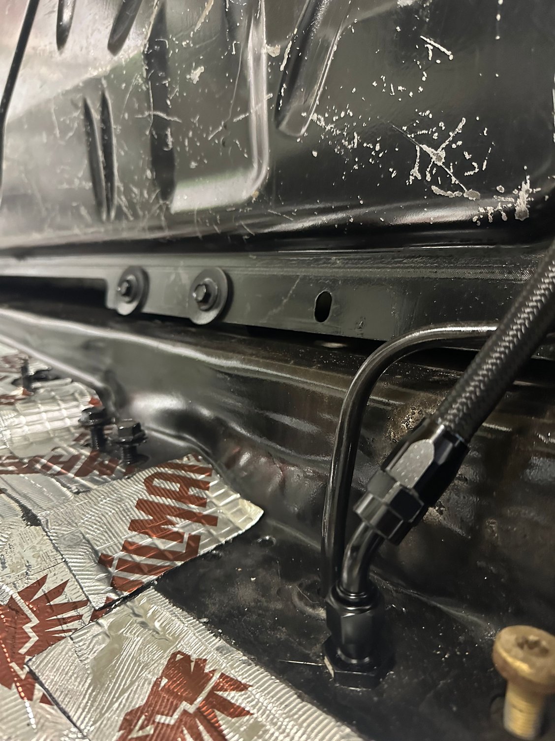

I ended up having a bulkhead fitting into the fuel filler. I didn't want to put a hole in the tank, and I figured that the fuel running into the filler hose and then into the tank would make less noise than a stream of fuel shooting directly into the fuel in the fuel tank from above. Plus... it's very difficult to see the fitting if you aren't looking for it. Which I like. The line runs straight down and through a bulkhead in the floor.
