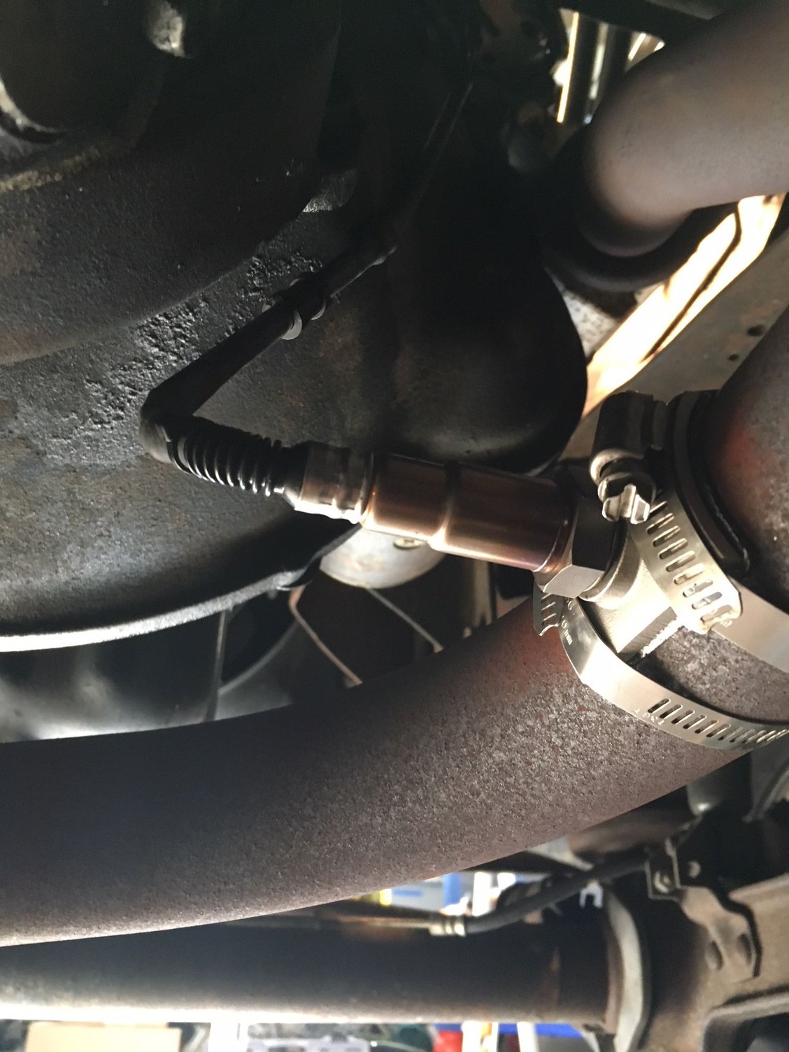

  1. Needs an O2 sensor installed in close proximity to the collector area. Screenshot of mine is below. This was a bit of a struggle to drop the exhaust enough to get an angle on it. They want it to be 10 degrees or higher from level. Presumably so it doesn’t get as much gunk on it. Mine isn’t quite right as it’s too horizontal. I’m getting new exhaust soon so I’ll let the shop worry about drilling a new/better location.

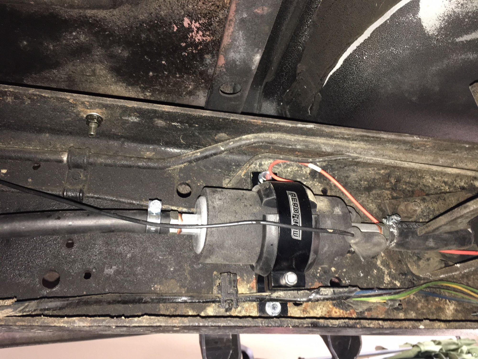

  3. Requires inline electric fuel pump so I had to remove the mechanical and use a block off plate.
  4. The Aeroflow pump they provided was louder than my Flowmasters. It wasn’t just during startup but constantly. I ordered the Walbro to swap it out. The Walbro fit the Aeroflow bracket perfectly and it whisper quiet. Problem solved.
  5. Requires a fuel return line. They provided fuel line that I used for the feed to the throttle body. Then used the original hard line for the return. Issue: There’s nowhere to put the return line into the tank. I didn’t want to drill the tank so I opted to install the return into the fuel filler hose. There is a Moroso kit for this BUT that’s for 2” lines whereas mine is 2.5”. Ended up flattening out a part of the metal portion of the fuel filler doohickey and installed the elbow they provided in the kit. Photos below of the result. Seems to work as designed. ‘Merica.

.......not 100% sure you (or the computer, I should say) will be all that happy with the temp sender location if it gets REALLY cold, but it might be fine. In the neck like that is downstream of the thermostat, so it might not read right before the thermostat opens.

Hey Jake - You may be right on the temp sensor location. I'll keep an eye on it. So far everything is operating very well though so fingers crossed.

You are 100% correct that the fuel pump and return line were easily the biggest pain. The Command Center was an option but an expensive one and added a component that I wasn't interested in seeing under the hood. I definitely would have preferred to stay with the mechanical pump if at all possible but that didn't seem to be an option. I don't like that I had to add an electric pump because in, I don't really like adding more things that could go wrong down the road. Simplicity is a huge reason why I like and have this rig!

That coolant temp location isnt gonna work. It will not see coolant flow until the thermostat is almost all the way open... No bueno. I put the coolant sensor in the old temp sender location (400 block) and moved the temp sender for the gauge to the thermostat housing.
EFI is a great upgrade and has really extended the driving season on my truck. I have had some tuning issues, in part I think due to my engine combo. Not a really wild motor but definitely not stock.
it is highly recommended to ditch the gasket and clamps on the 02 sensor and weld it right to the pipe as leaks there mess with 02 sensor readings.
You're the second to post the coolant temp sensor warning so I'll definitely keep an eye on it. So far so good though. But I live in a pretty temperate climate.
And you're right on the O2 sensor. I'm having Super 44's added in a few weeks and already told them I want a fitting welded in. Good call!
