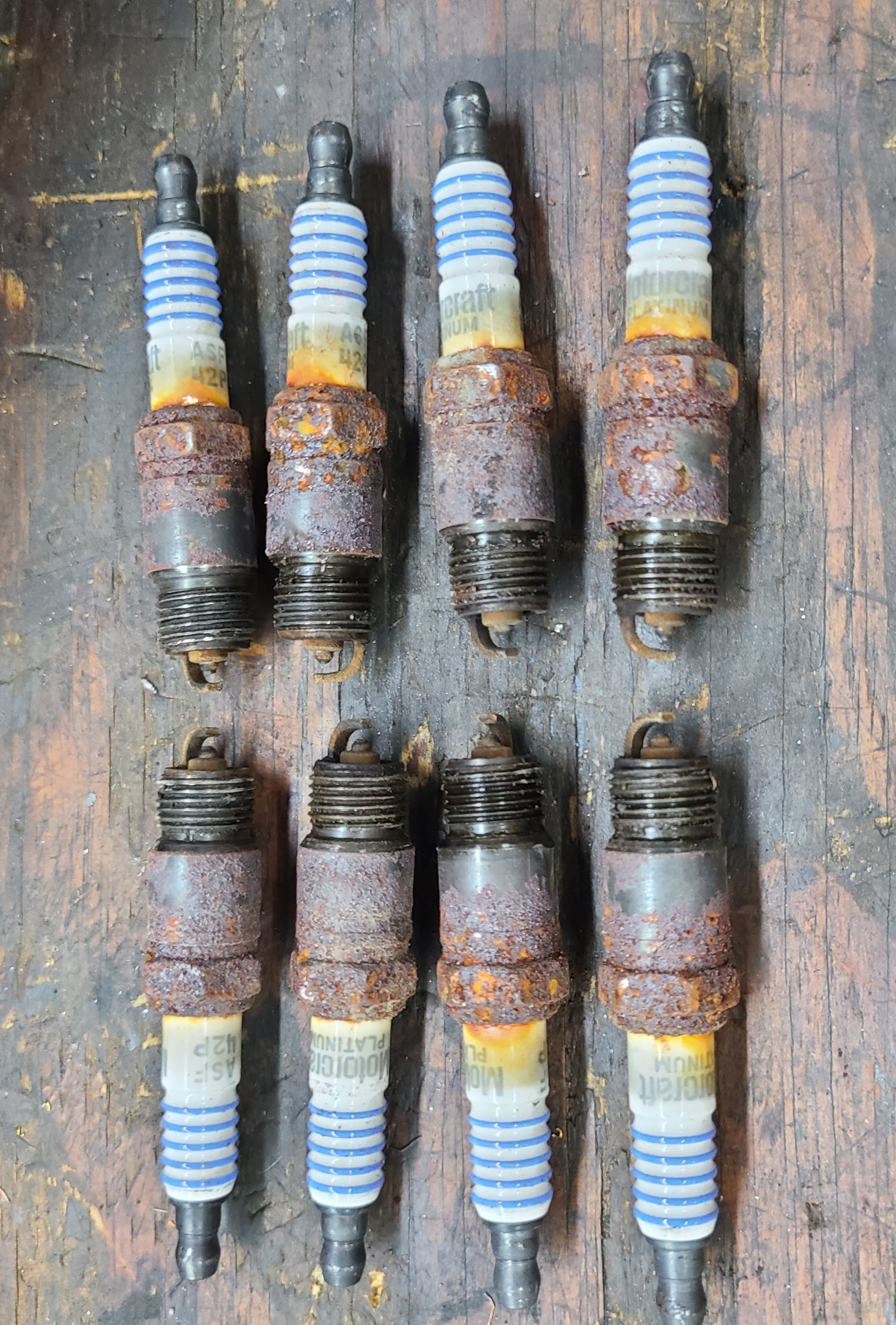

I have this problem on my 460 truck. It's been that way as long as I can remember. I can mask the problem with premium fuel, but that's gotten spendy. Over the years I have replaced all the EGR system (EGR valve, EVP sensor, EGR solenoid twice, and all the vacuum lines) thinking that had to be the root cause but to no avail.
Now having read this thread and others like it, I decided to dig back in and see what other causes there could be. I first checked fuel pressure and got this:
KOEO 42 psi
Idle 34 psi
WOT 42 psi
Unplug FPR 44 psi
These pressures are good, amiright? I don't have a lean condition based on the plugs I pulled so I think fuel delivery is OK:
So next I wanted to look at timing, specifically total timing, since I read some posts saying some were seeing 50 degrees BTC in come cases. Yikes. Well, that is not my case. With initial timing at 10 deg BTC, I am seeing about 45-46 deg BTC total. That is still too much, I think, so I backed off to 5 deg BTC initial and tried again. Now got about 41 deg BTC total. OK, if I a little is good, more must be better. So I checked it at 0 deg BTC initial and got about 36-38 deg BTC total. That is where I think it ought to be so I am leaving it there for now.
It's hard to tell but I ran down to the grocery store and did not hear any pinging. It's about 98F here, so should be hot enough. Perhaps the initial timing adjustment helps, but I cannot be sure yet. It's fooled me before. But I will say that it seems the initial timing only affects total because the truck drives totally normally otherwise, plenty of power like a 460 in an F150 should have.
Really just trying to document what I am trying and also see if anyone else has any other ideas.
