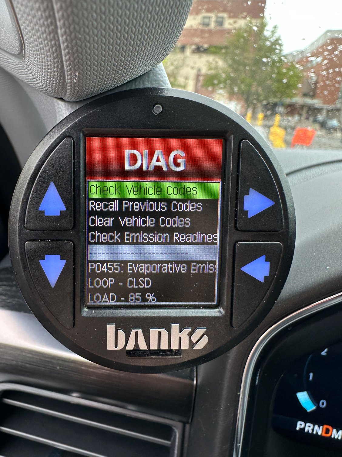

P0455 Code
Ok, 3 separate times now. . See the explanation in the link.
I looked and didn’t see anything obvious so I’ll continue to monitor the issues. Yesterday was the first time a had the smell of gas and I was near the fuel door.
Wonder if it as simple as a bad gas cap.
