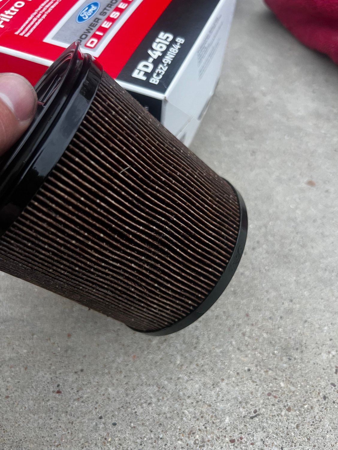

10-4. that’s what I was planning on doing! Don’t really know when the last time it got a fuel filter change so probably due for one. I managed to get the under the cab filter, but not the rail filter since I managed to forget that. Oops.

Negative, no metal in the bowl. Had a little bit of gunk but that was it.
Sprayed it with some carb cleaner, scrubbed it and let it dry out for awhile.
