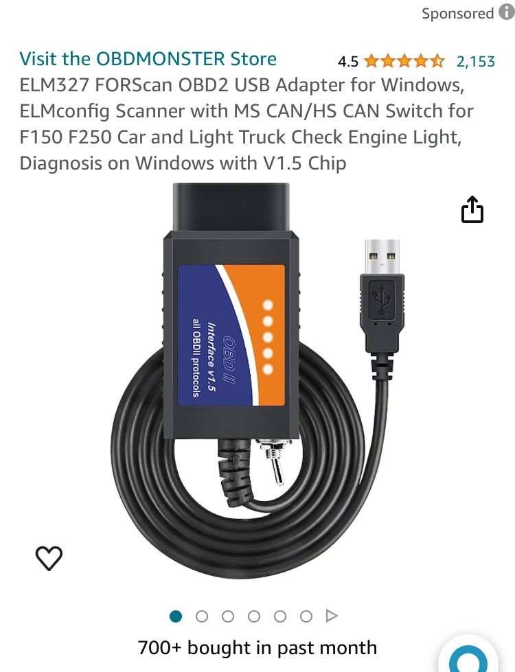

Is this the exact one your talking about?
Old Apr 20, 2024 | 01:19 AM
bismic's Avatar
bismic
Joined: Nov 2003
Posts: 27,917
Likes: 3,636
Download FORSCan from their home page ..............
https://forscan.org/home.html
That web page link lists supported adapters also.
What device are you going to install it on? A windows laptop?
If so, the adapter I recommend is lined below:
https://www.obdlink.com/products/obd...x/?ref=forscan
Or you can get a decent one a bit cheaper:
Amazon Amazon
If an i-phone, I would recommend this one, but it is somewhat expensive (but nice):
https://www.obdlink.com/products/obd...p/?ref=forscan
That said, I still use a cheaper ELM327 WiFi adapter from BAFX with some limited functionality, but it still works well enough to retrieve PCM PIDs and codes. Do a search here and others will say what they are using.

This cheaper one has worked with two Ford vehicles for me.
