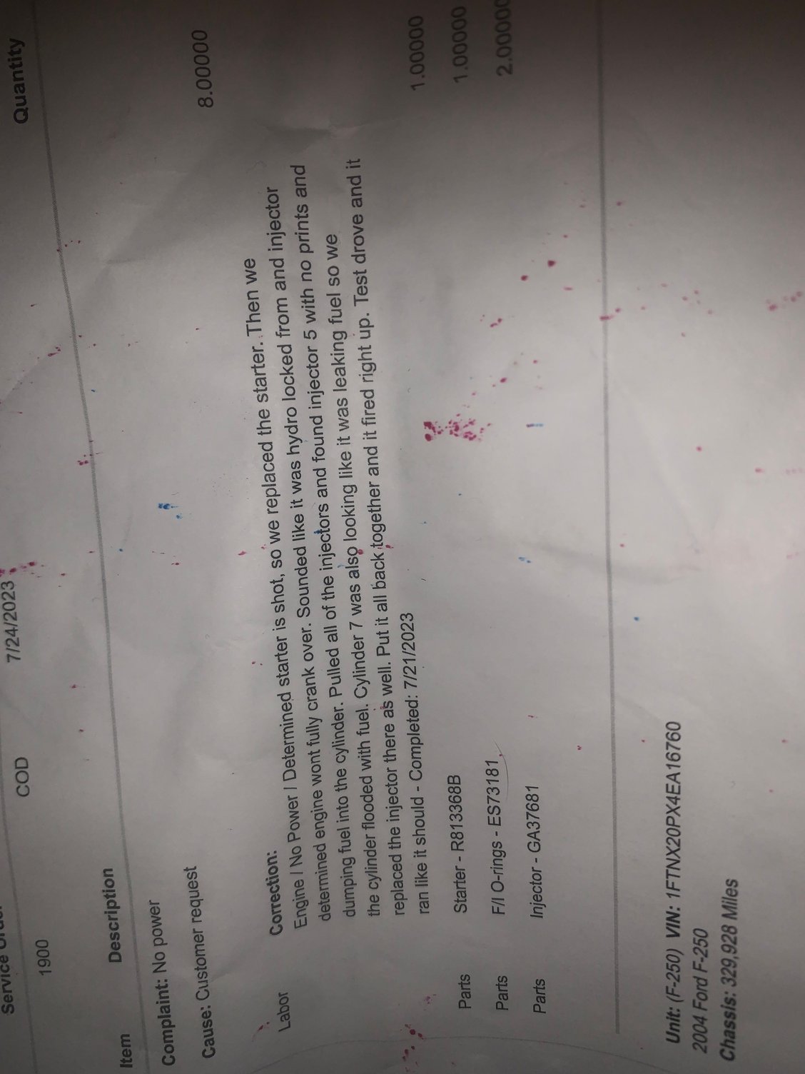

I traded a truck for a 2004 6.0 I had it for about 2 weeks and it ran great. I was hauling something one day when the truck slowly started to loose power while I kept my foot on the accelerator. It eventually died but I was able to get it off the road. It cranked a few time but then there was no crank at all. It sent 3 codes p2285 (injector control pressure sensor circuit low) p0118 ( engine coolant tempature sensor 1 circuit high) and p0198 (engine oil temperature sensor high). I did a few things that people had suggested to me like cam and crank sensors checking fuses but I’m not much of a mechanic so I just decided to take it to a shop. They called me and told me that one of my injectors had no prints and had dumped fuel into the cylinder causing it to hydro lock. He said that another injectior looked rough too so I had him replace those 2. He told me the rest were fine and that the truck would be good to go after he finished them. He even resealed the other 6. But before he messed with the injectors I asked him if code p2285 had anything to do with the problem. Low pressure from an injector caused it to dump fuel? He said that that was just throwing the code because the injector was bad. Once it was finished at the shop I picked it up and drove about a mile and it did the exact same thing as before. I called him and he told me that he really thinks all 8 need replaced when he told me the other 6 were fine before. I don’t know what to do can someone please help.

Hard to say if the shop is dealing with you honestly, but they might be. Obviously saying they fixed it and then hearing them say you need 6 more injectors is plenty questionable. You need to decide if they have a good reputation with the 6.0L or not (and if they have an honest reputation or not).

The truck does still have the egr and the Icp sensor is behind the turbo. Sounds to me like that high pressure oil pump is responsible for how the injectors perform along with the ope playing a role as well. Possibly why the truck was throwing the 2285 code? The description I received from the shop 8 can attach in an image. Should I ask them for more I depth explanation?

Might want to verify what they meant on injector #5. I think they meant that it didn't have any o-rings" maybe??
The statement about no "prints" doesn't make sense. The only thing close to blame it on "auto-complete" was orings ..............

I think they meant no copper washer.
From the shop's perspective, they found two leaking injectors and replaced those. As a precautionary, they resealed the other 6 injectors since the two had sealing issues, and they don't know the prior work. That's probably what most of us would do.
You developed the problem again and talked to him on the phone, so there is no hands-on diagnostic. He's hearing another hydrolock but believes they fixed sealing issues on 5 and 7. Again, they have no clue where those other injectors came from, did a reseal, and were confident in that (with no hands-on check as yet), so the phone call guess would be there continues to be an injector problem with maybe poor injectors.
A phone call analysis is no different than what we do here; to do a proper check, it needs data and hands-on diagnostics. Once they had the truck to do that, they may find that it's the same cylinder(s) that have issues. Cylinders 5 and 7 have a history of head cracking above the injector bores, and what might be happening in this case. But until that shop gets the truck back to find out what cylinders are hydrolocking, the swag of other injectors being the issue is one of the phone/online guesses. Although the head cracking usually ends up with fuel in the coolant, not so much hydrolocking.
You may have to replace the head or do the in-frame injector crack fix. Or there's another issue that has hurt the injectors if they were good from the start. Such as fuel delivery.

Grizzly injector??!! Part # GA37681??
https://grizzlytough.com/partdetail....1&line_code=GA
Two injectors bad on one side, 330k miles, and all 4 injectors on that side were not changed?? Questionable decision (except maybe not completely bad since it looks like cheap injectors were installed).
Not looking good ............
