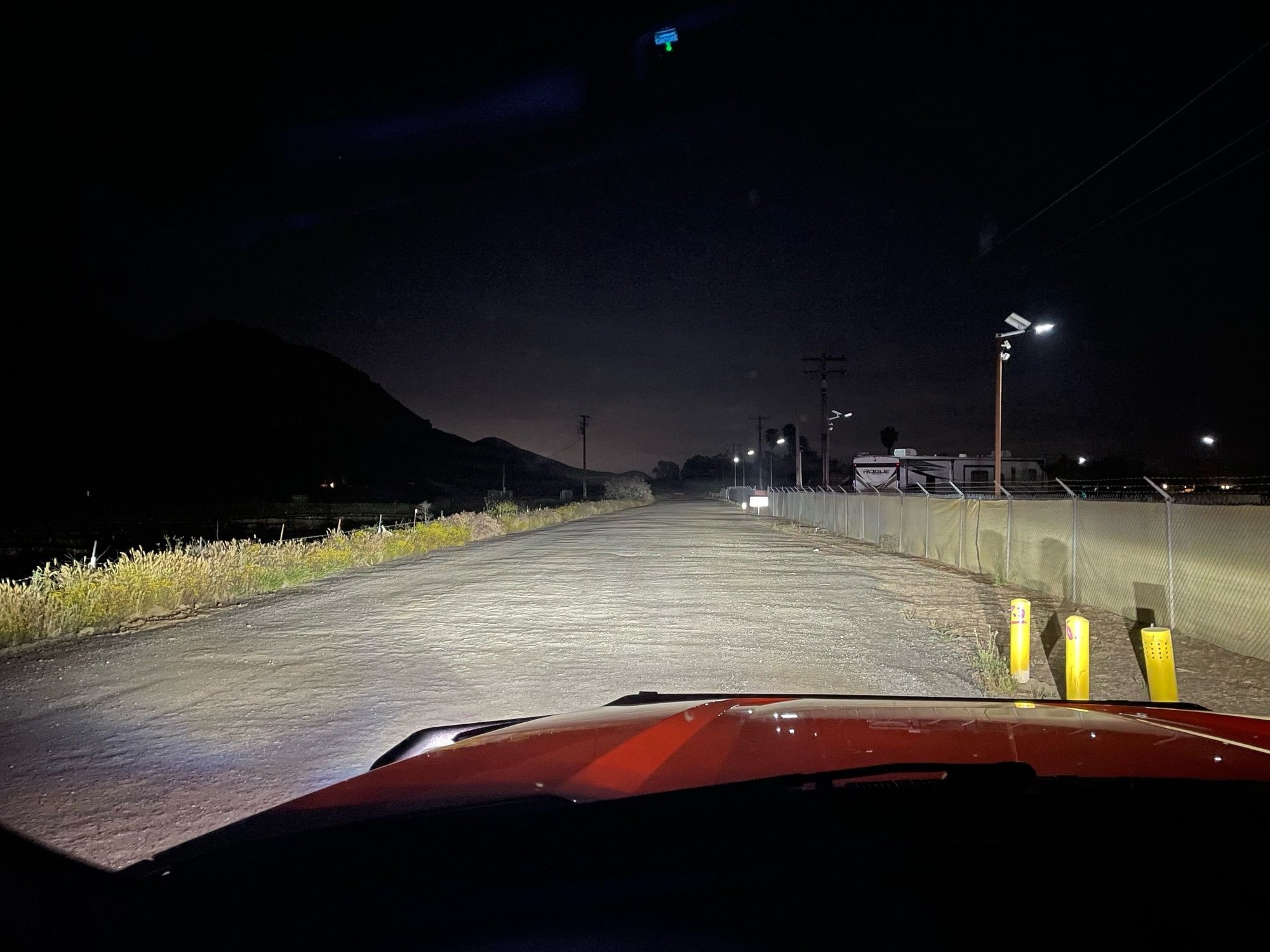

The light project is progressing along. Had to find a dark(ish) road near the house to see where I’m at. Past 10 vehicles or so tonight and nobody flashed at me so we will see. These are still a bit lower than what Ford recommends for setting them if you go by the owners manual.

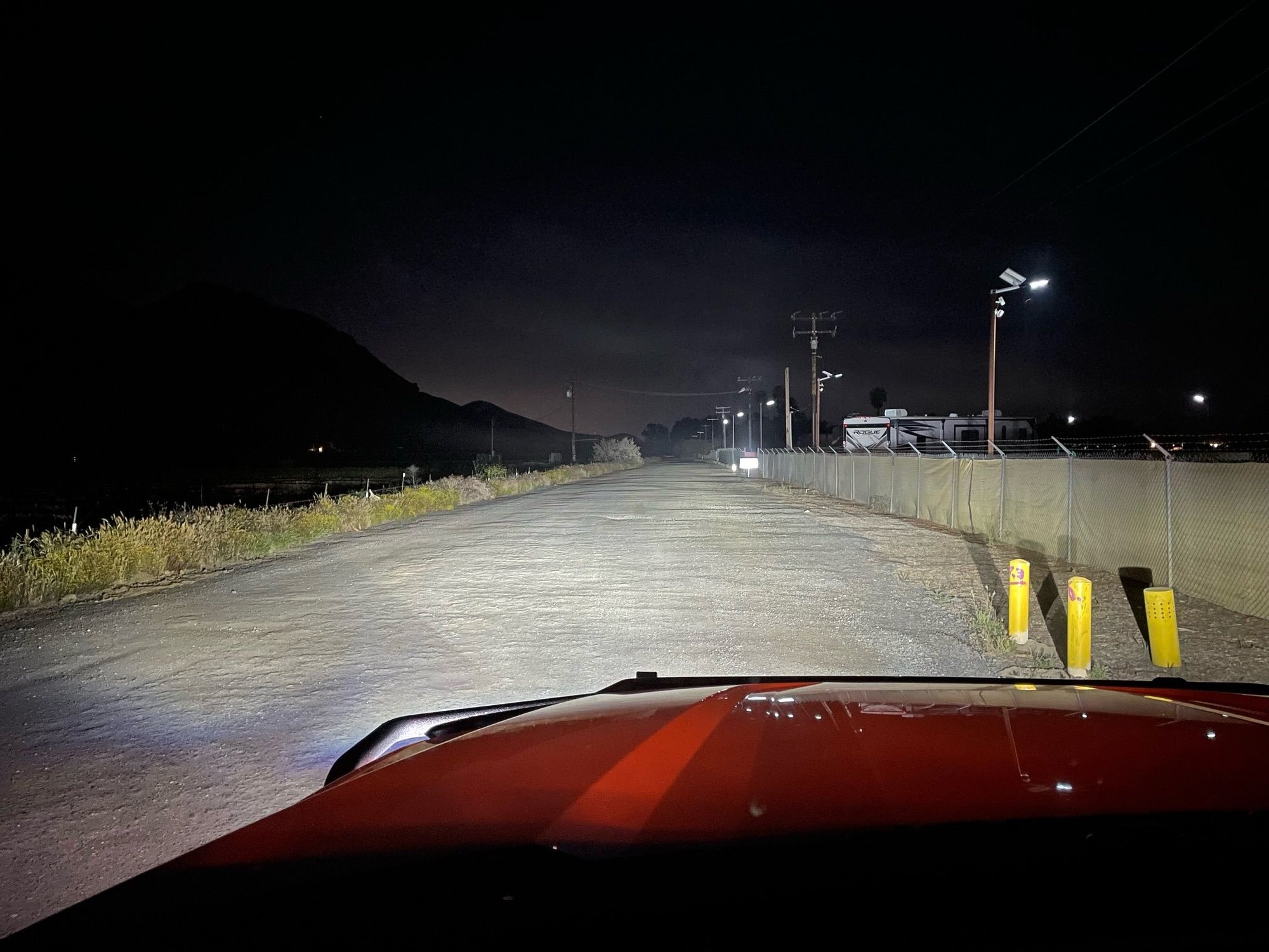

This is low beam headlights
This is high beam headlights

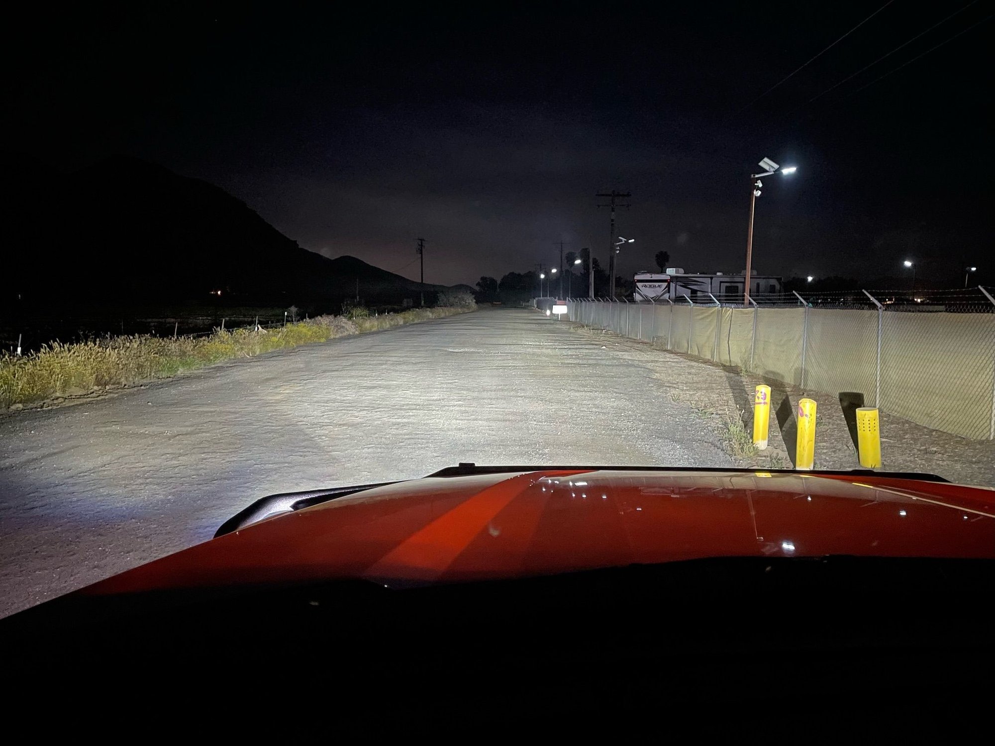

This is low beam with white fogs

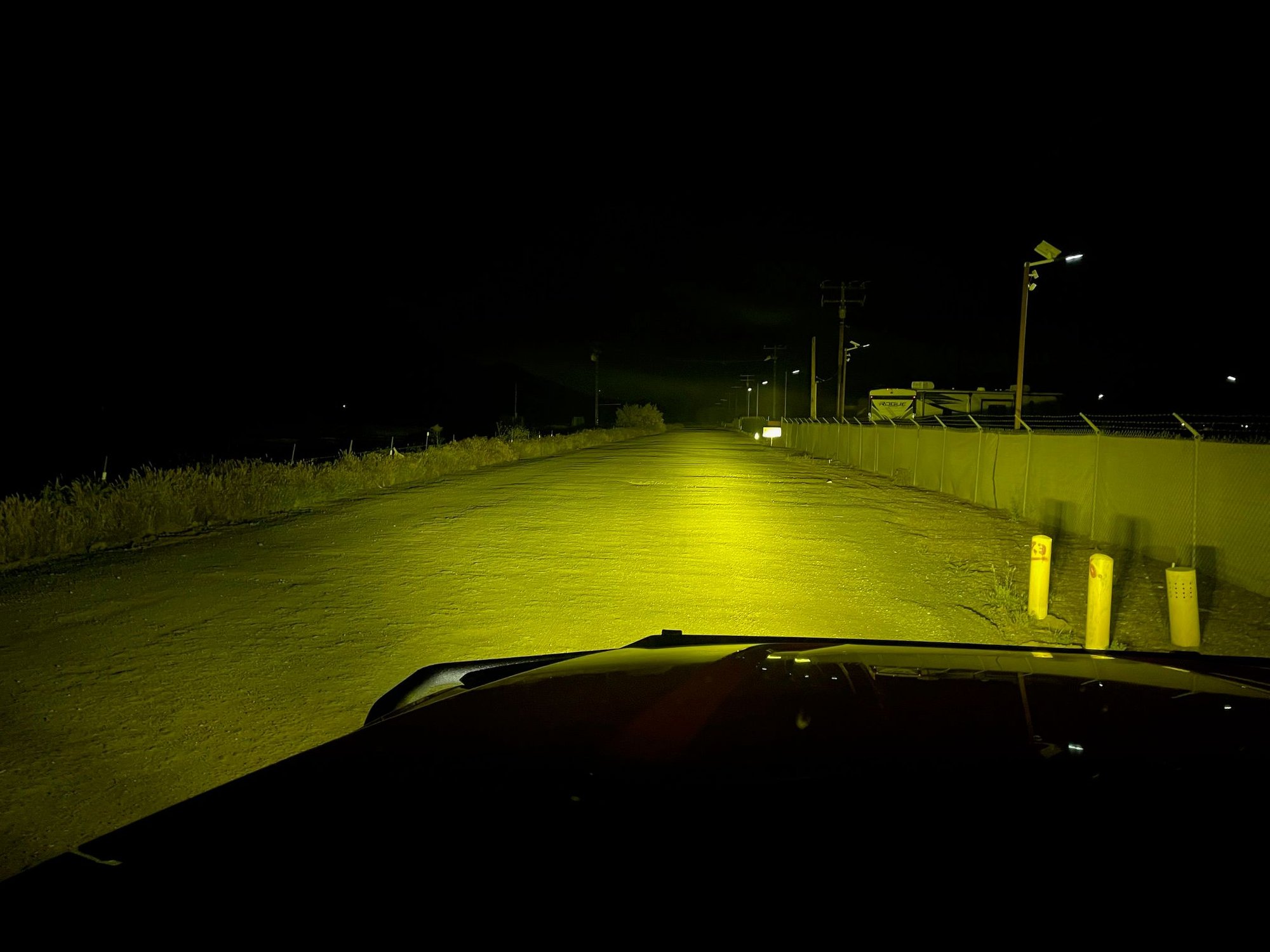

This is front amber/yellow pods on low with OEM low

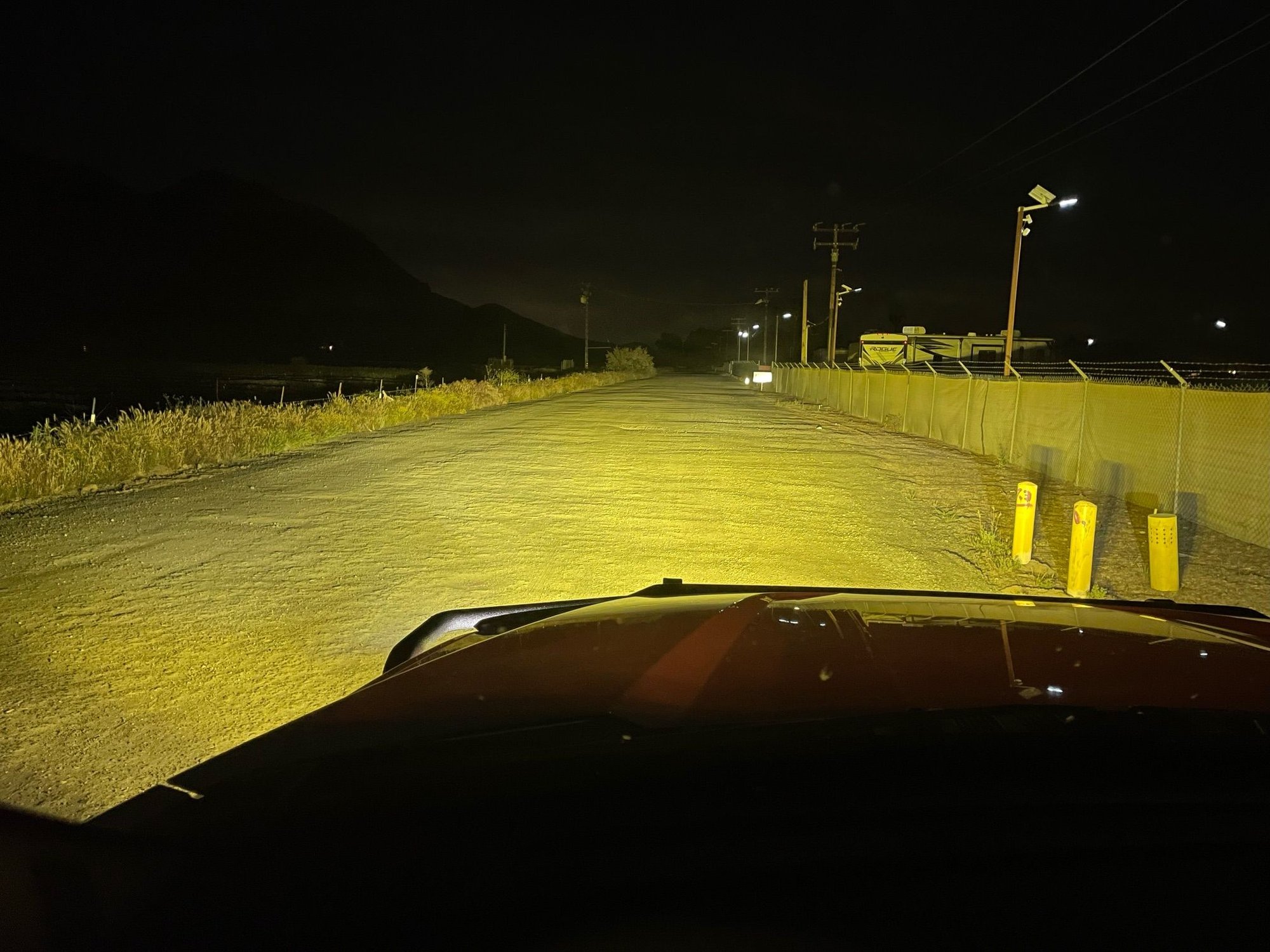

This is just the front amber/yellow pods on high which adds a driving spot for increased driving speed.

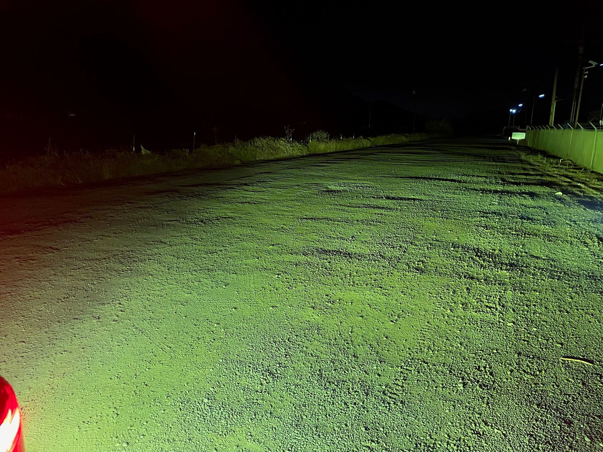

This is the driver side rear pod. Not a great pic as my friend was blocking the other side but you get the idea.

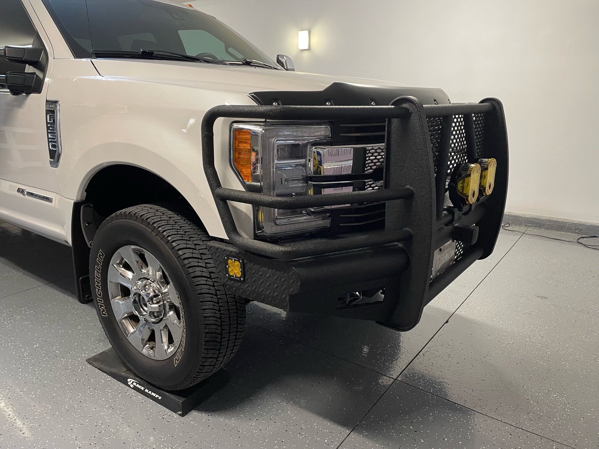

I might add these same rear pods and flush mount them on the side of my Ranch Hand bumper to cover the sides if needed. Even though my truck is white, it looks red in the pics.

Just posting to finish out the thread as I installed the last set of pod lights today, so the upgraded lighting project is now complete. These side pods were mostly a PITA, but I got them in. If anyone decides to do something like this, look me up and I can give you some FYIs that may make it easier on you.
