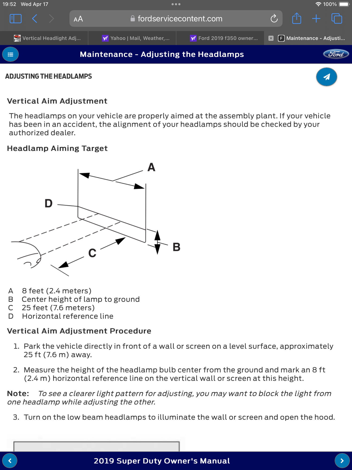

Yes, following the “procedure” in the owners manual would put them too high. I would say mine need to come up a bit but not being able to get them to move prevents any adjustment anyway. This is from the manual.
As mine are about 10” below my 44” horizontal reference line, no idea where they originally measured from when they set these up. My Ranch Hand bumper dropped the front about .25” so I would not think it should be so far off. Thanks for the replies and I will work on it again tomorrow afternoon and see if it gets better. If not, I may just have to live with it. I do have extra lights on front that are useful when no traffic is around but being in SoCal, this does not happen very often on any of the usual roads. I had this light bar on the old truck
