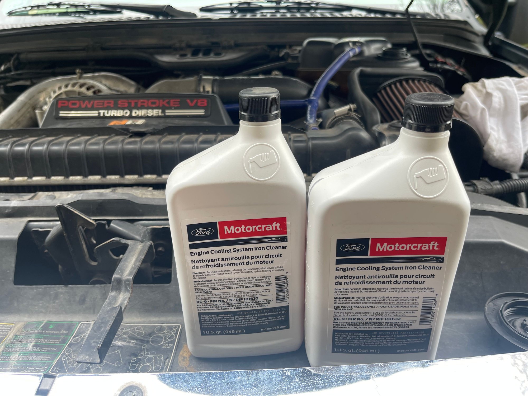

Time for a little spring maintenance. A few years back, before being educated by this forum, I flushed the coolant system. It never had been done since I bought it in 2008. I mistakenly put in the universal green stuff since I couldn’t find the gold at my NAPA store. I have other things to do but coolant system flush was first on the list.
I was able to get the passenger side block plug out by pulling the starter at first, and an 8mm Allen wrench. After the initial breaking of the plug loose I used this and kept the starter in so could flush both sides of the block and warm the engine.
Flushed 3 times with plain tap water, then added VC9.
Flushed once with tap water, then once with distilled water.
I figured finding ELC coolant shouldn’t be an issue, right? Wrong. It seems everyone; NAPA, Autozone, TracAuto, etc only had the Peak Fleet stuff. I wasn’t really convinced it was any good. Figured maybe the three truck stops around me would have CAT or Rotella…… nope, they had 50/50 Peak. Finally found Rotella ELC at Tractor Supply. 2 gallons local, 2 gallons 30 miles away. Sheesh!!! Final flush will be tomorrow, then on to other needed maintenance items.

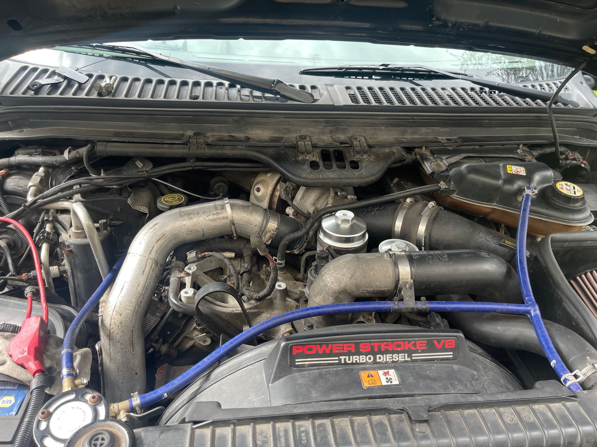

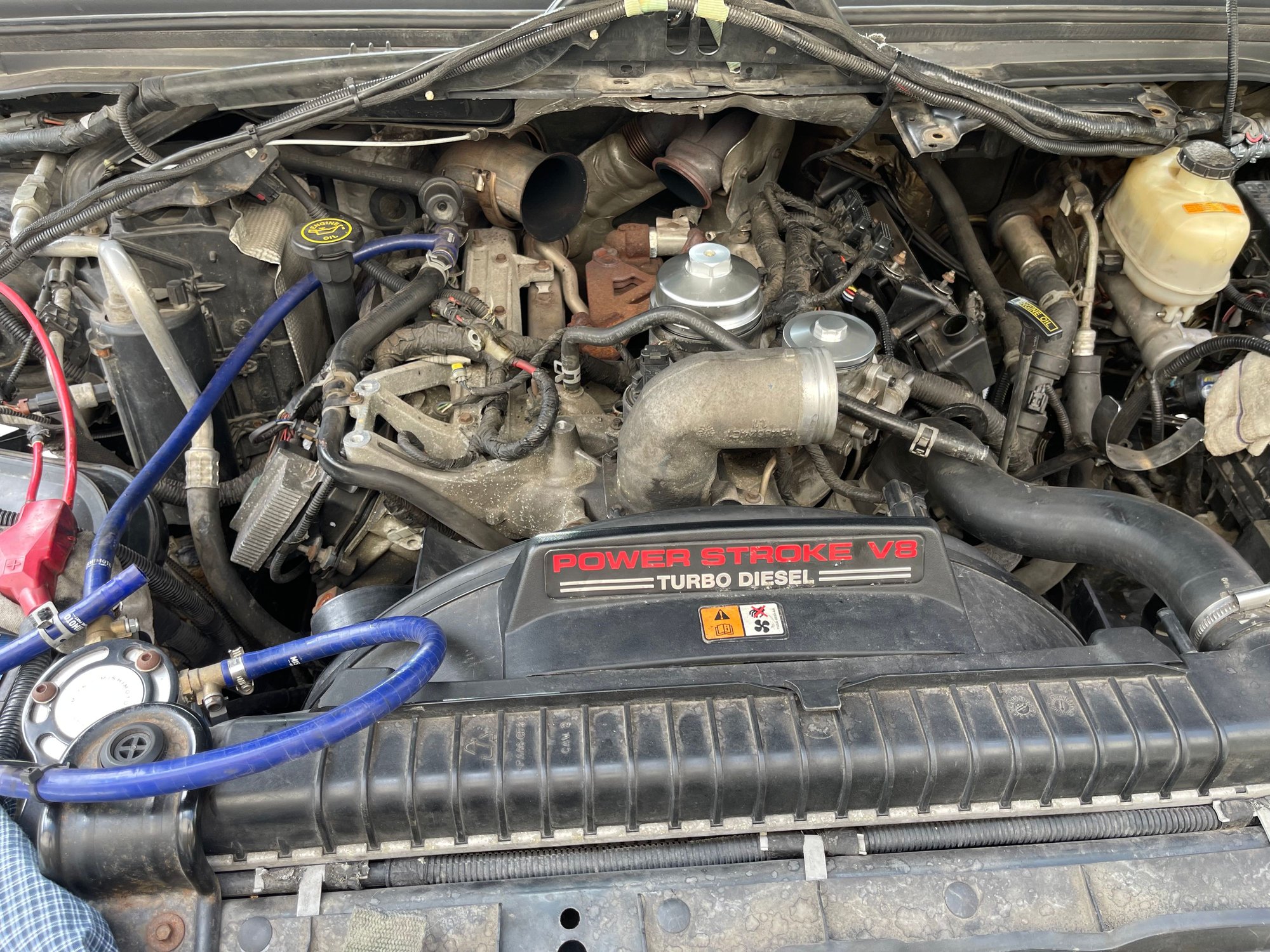

Started removing parts today. The plastic charge tubes were a real PITA, but not as much as the back bolt on the turbo.
Alternator off, air cleaner and plumbing out, CAC tubes off, charge pipe off, degas bottle and related plumbing out, FICM out, plastic wire loom holder braced, turbo out.
