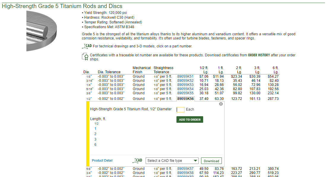

I called to ask if spacers were needed because none are shown on the product page. They said spacers are still needed but they don't offer any made of titanium. Seems smarter to use titanium spacers so the thermal coefficients are the same. So now I'm considering making spacers from titanium rod:

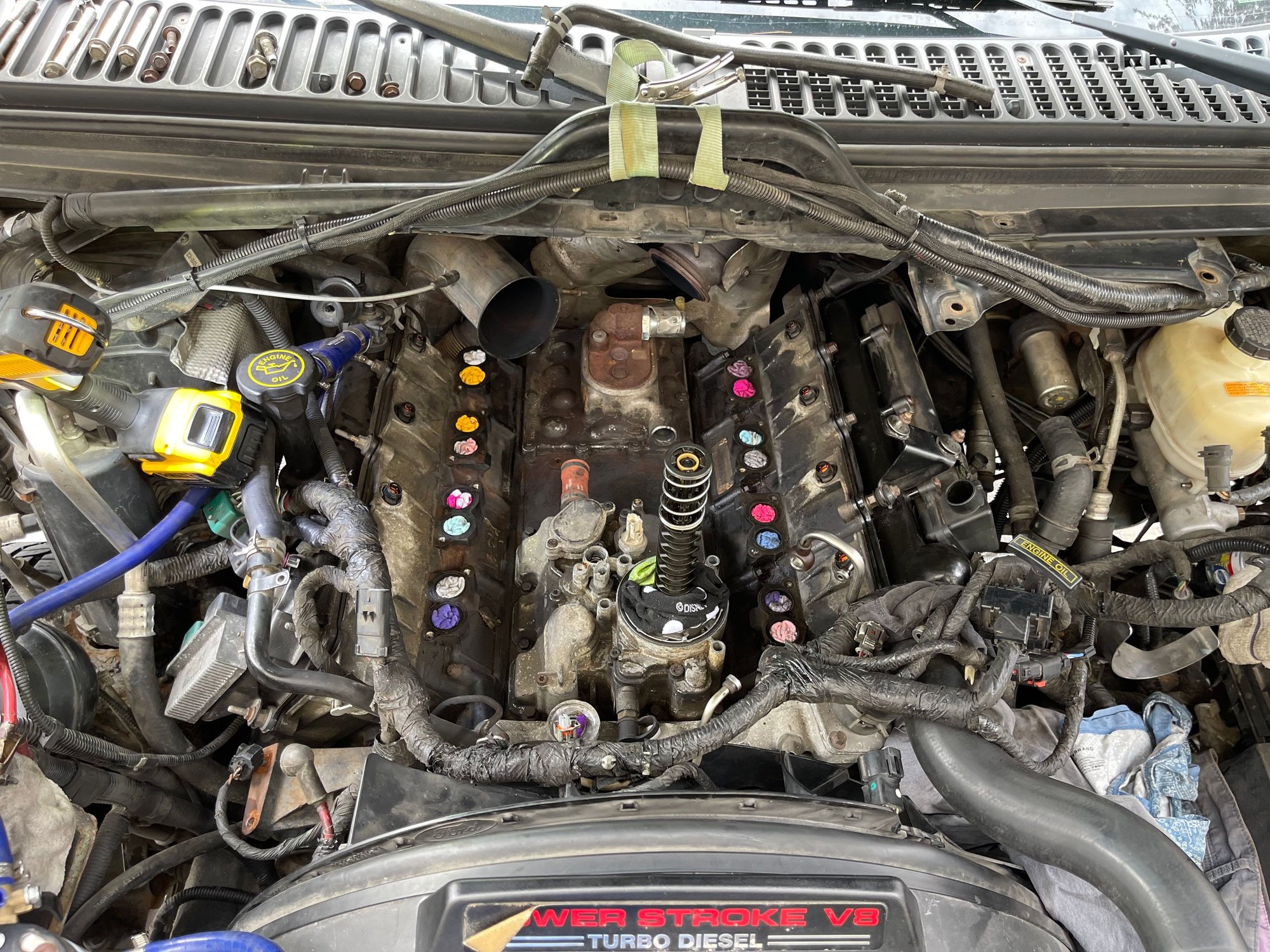

So far in the dismantle I found the CV tube had a hole in it which explains the oil everywhere on the drivers side valve cover. I found one intake bolt on the drivers side backed out about 1/4”. I also found one bolt missing and another backed out on the turbo pedestal. The missing bolt is nowhere to be found and the threaded hole in the block was hard to find because it was covered in dirt/ grime. Some of the heat shielding is also loose in front of the up pipes.
I’ve owned the truck since 2008, and to my knowledge the only thing that was ever completed was a turbo cleaning before I bought it. Aside from a warranty FICM, the only hands on this motor are mine. Perhaps there was more done to this truck than I was lead to believe…..or the motor was assembled on a Friday.

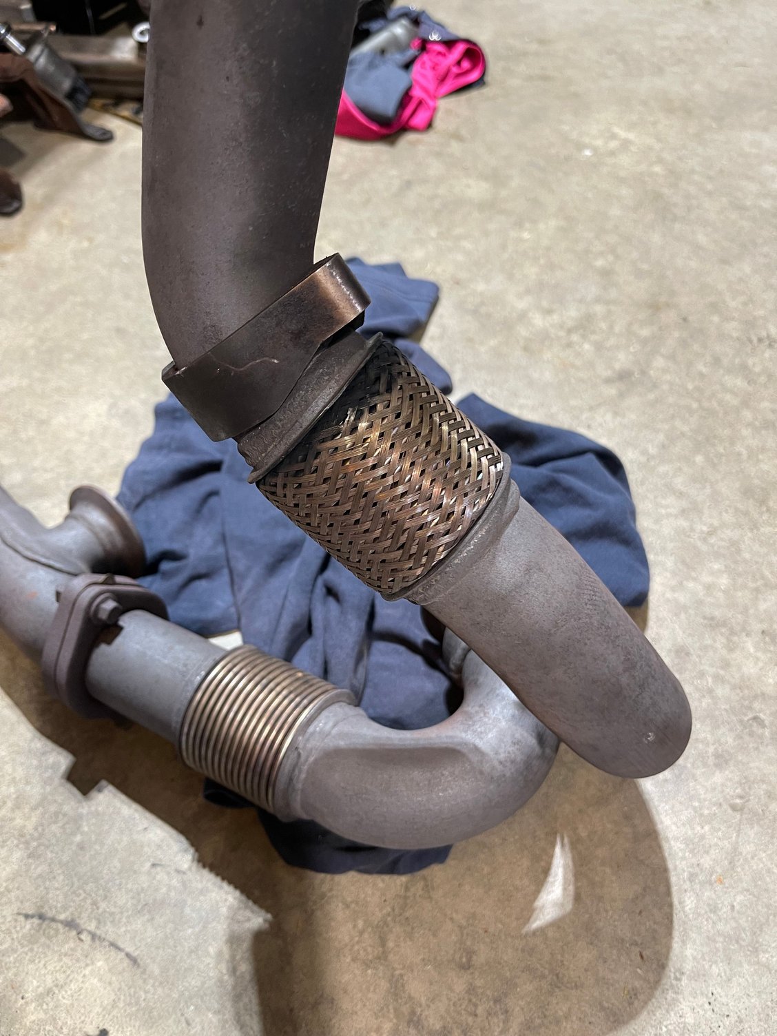

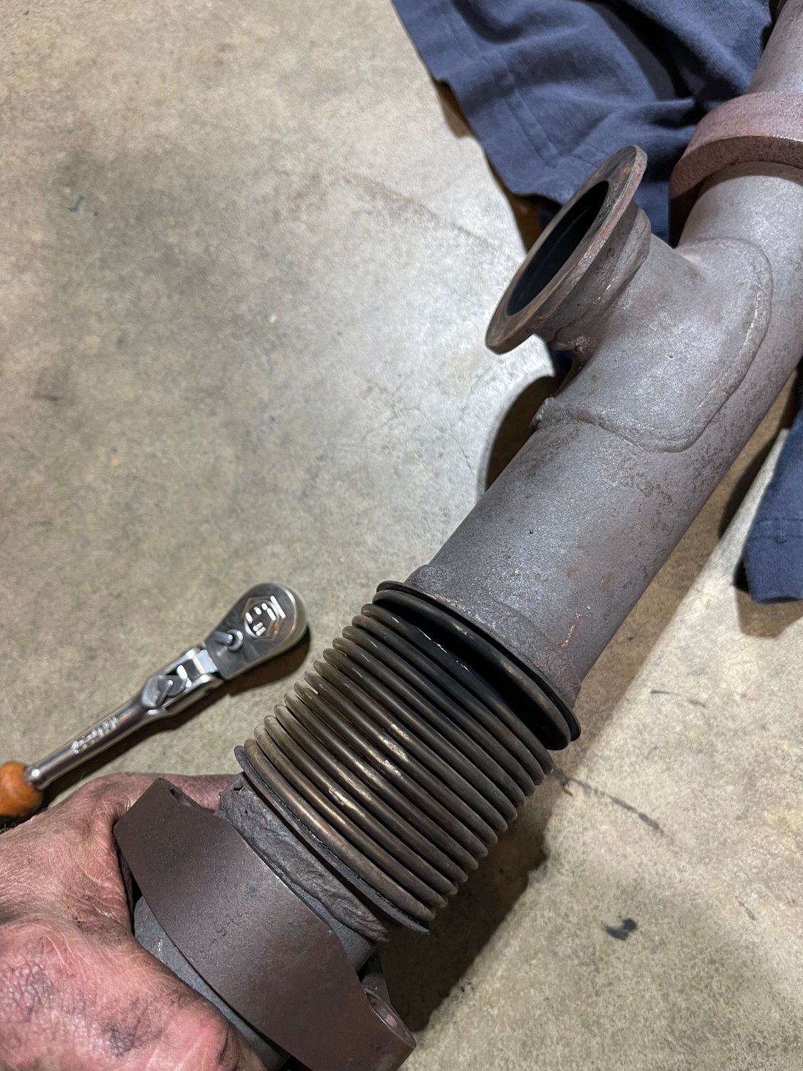

Got the up pipes off tonight. What a pain in the ars. When I replaced the clutch in the tranny I thought I saw some soot around the passenger side bellow. I was partially correct, looks like they were both cracked.

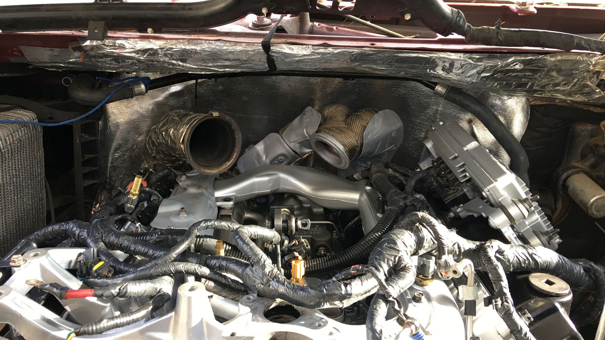

Does anyone think there’s any need to heat wrap the new-ish up pipes I’m putting on? Any benefit?

I did it just because. I had the wrap from years ago.
