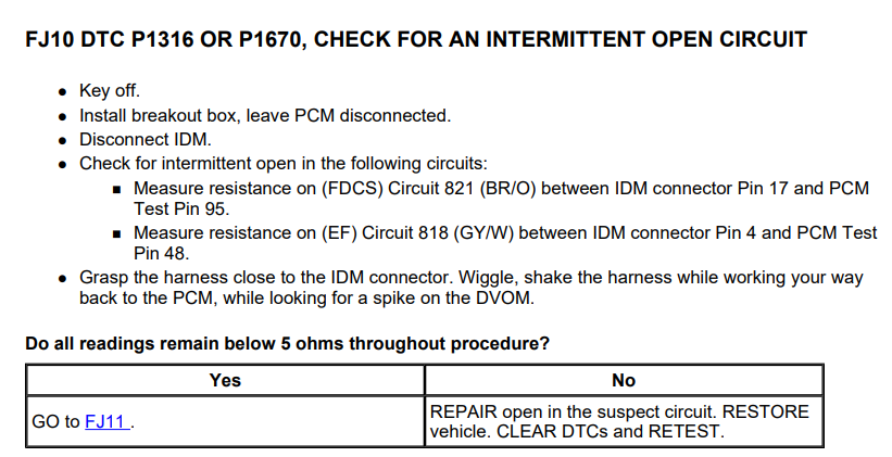

That P1670 could certainly cause the miss. With the buzz test telling us the IDM is working, check the wiring/connections while wiggling for shorts/opens between the IDM and PCM. If the wiring comes up good, it might be time to send the PCM/IDM to dieseltechchatt.com for checkup/repair.
Take a look at the attached troubleshooting for P1670 for wiring checks. If you just have P1670, and not other related codes, start at FJ10:
Thanks for the attachment. That’s a pretty handy test. Im kind of leaning towards PCM/IDM issue now. With the miss at higher rpms, the engine code that points towards it, my obd reader having a really hard time staying connected to the pcm or not connecting at all and the fuel pump pressure not stay consistent sounds all like computer to me.
