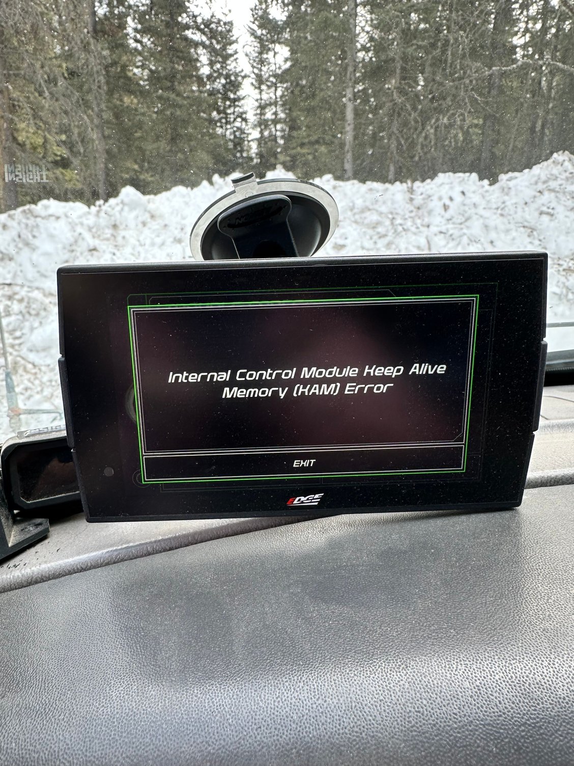

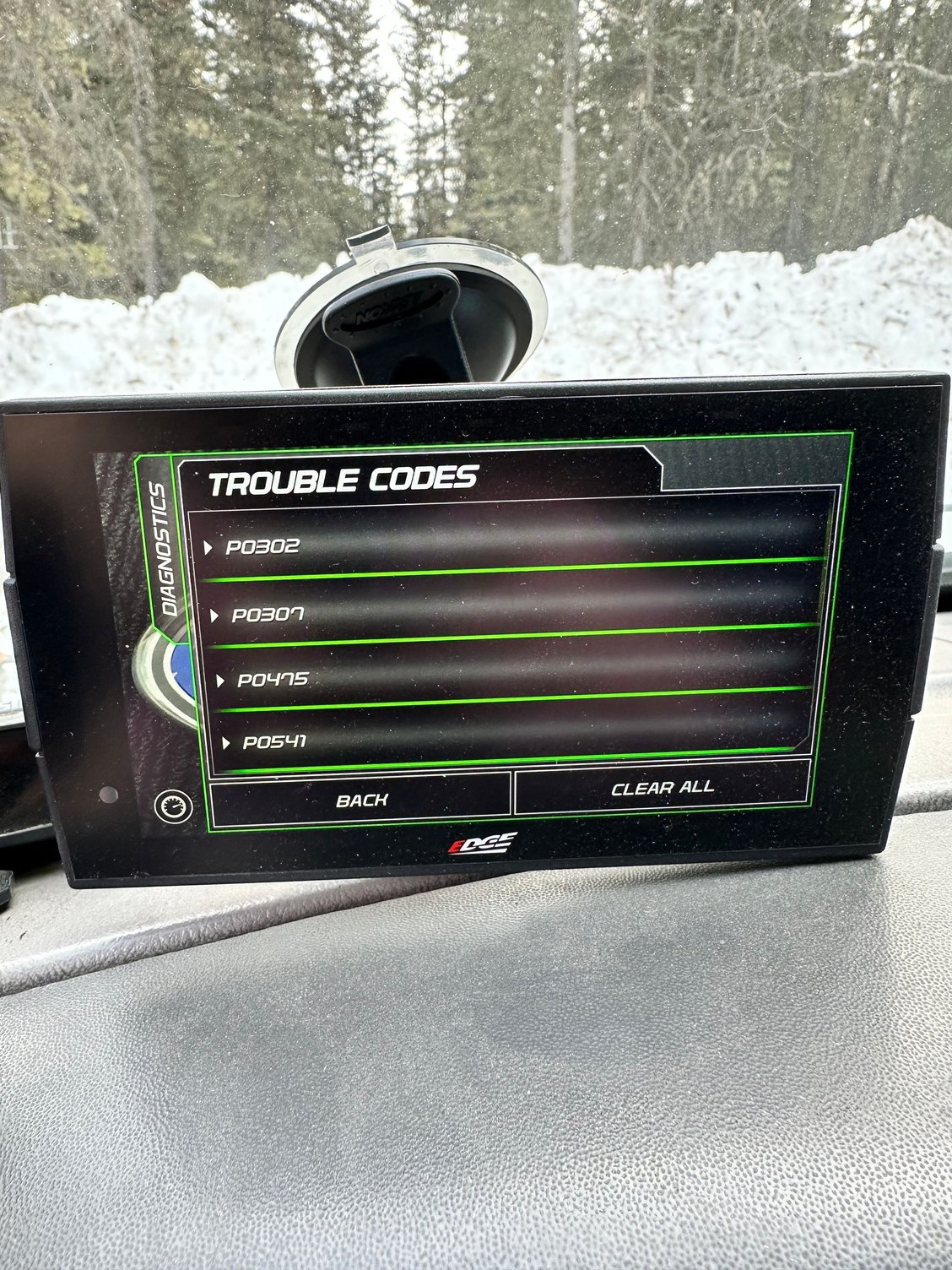

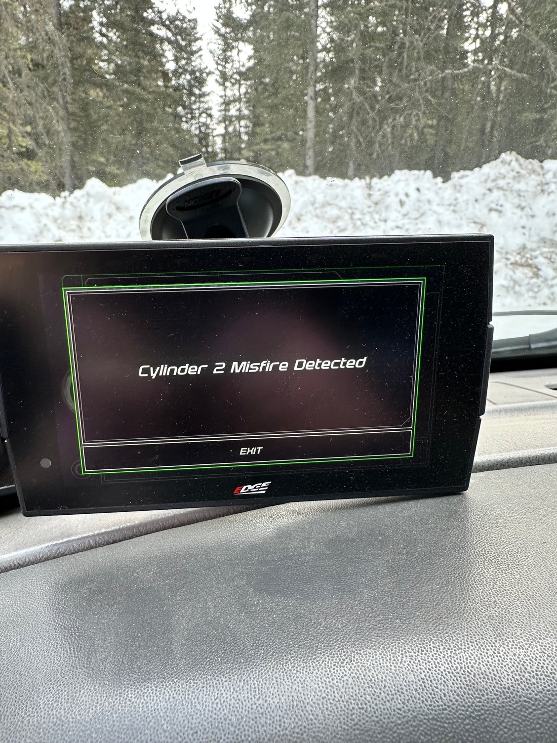

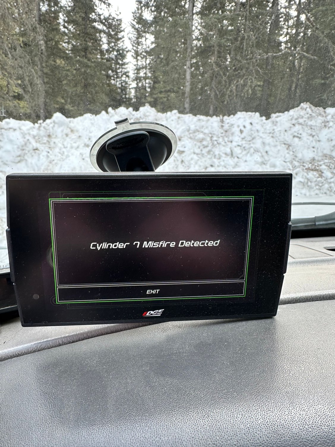

Unfortunately like mentioned my 00 is stock (split shot injectors) so I don’t have a way to compare to stock single shot tube. Anyway hoping to do some testing tonight. I did scan the codes and it had logged my misfires at some point. I cleared it to see if they come back( which I assume they will). I have a couple other codes but those are for the fuel heater, intake heater, and wastegate which are all disconnected.

Some good diagnostics so far. Do you have any blowby, as evidenced by puffing at the oil fill cap?
If compression is good, but with #2 and #7 flagged by the misfire DTCs, check PERDEL PIDS and see if they confirm these 2 cylinders. They should be in the list of PIDs along with RPM, ICP, etc.

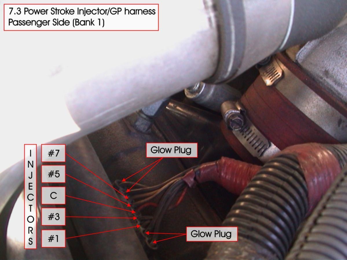

I'd recommend double checking the electrical side of the injectors with a buzz test. Does the CTS3 do this? If not, FORScan will get it done.
Check the solenoid wiring to these 2 cylinders - heck, check all of them, measuring resistance between the common pin and the solenoid pin. Should be around 3 ohms. Start at the valve cover connection, then 42 pin connector, and finally the IDM connector. Moving the harness while taking the measurement can reveal a damaged wire.

Well I was hoping to do it sooner but I had to deal with dead batteries for whatever reason...(Ive been fighting a random electrical draw).....On the first run I set off the Check engine light and set the ICP code. I also found out my forscan on my old android phone no longer works and the app is no longer in the app store, so I have no way of running a buzz test or seeing perdels unless someone has another app out there that works. The jelibuilt tunes have always been super loud on this truck especially while towing but have substantial more power than the 1023 tunes. Both are for the 160 injectors. Wish I had a stock tune file for these injectors but I do not currently.
