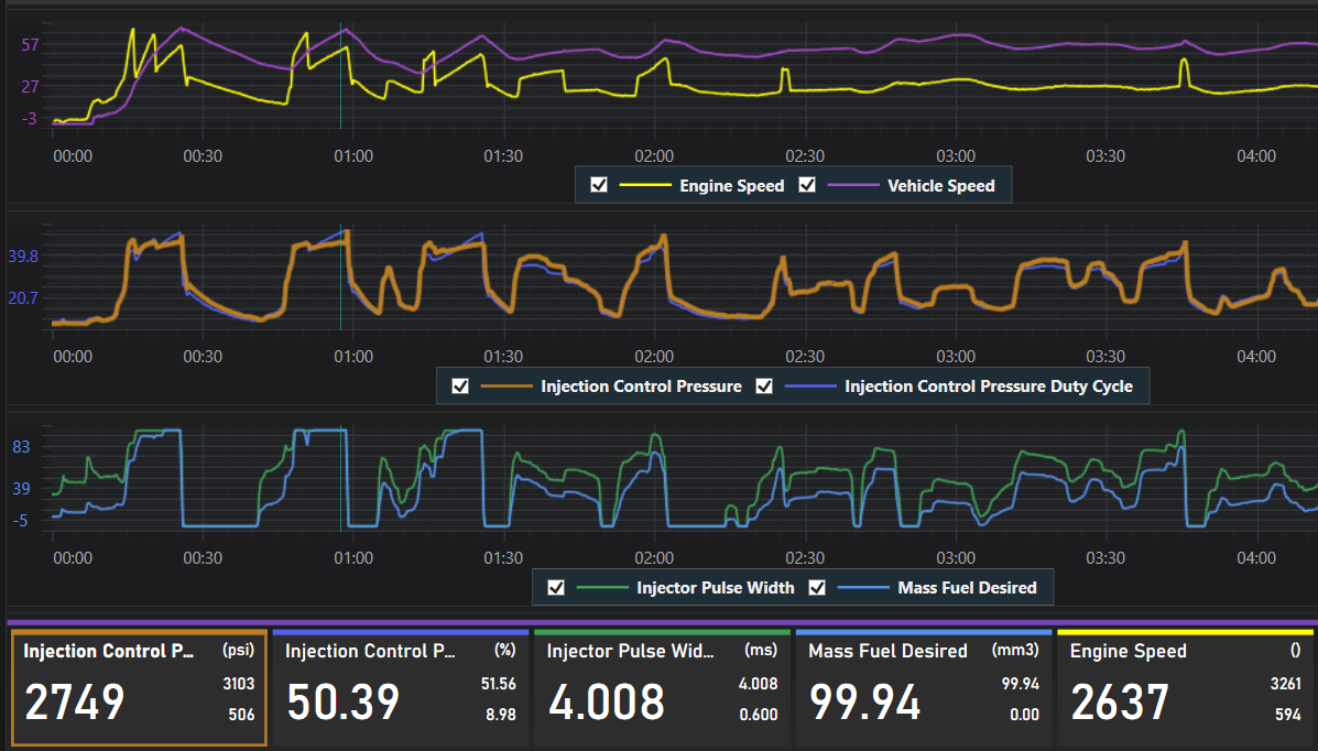

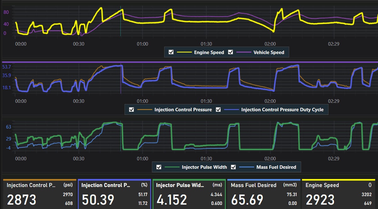

Thank you for pointing me to the dataviewer for the CTS3. Here are screenshots for the two logs you provided. Looks like a healthy HPO system.
Jelibuilt tune run:
1023 tune run:
This dataviewer is well done. I just picked 6 PIDs to view, to keep clutter down, but you can adjust scales and colors, pick gauges along the bottom to highlight specific data points. Looks like it lets you export the data to CSV as well, but no need as this app gets the job done.
I picked a datapoint for the gauges to display, moving the provided vertical bar to an interesting point. Both tunes command over 4ms fuel pulse width, even for single shots, and yet ICP is keeping up. I didn't think singles needed pw that high. IPR% is climbing and might have peaked higher if loaded with the 1023 tune. IPR% leveled out at 50% with the jeli tune.
I checked pedal position on both logs, and you had the pedal down hard in both runs, yet mass fuel desired peaked lower on the jeli tune at 75 (also typical for PHP tunes), while 1023 put it near 100. I'm guessing the pedal feel is different between the two tunes.
No concerns with your HPOP, IPR valve and ICP sensor based on this data.

Thanks for looking into this for me and thinking it's not the HPOP. What do you think it could possibly be then? Probably an injector or two? Probably 2 and 7 since they through codes more than likely?
Pedal feel is definitely different between the 2 tunes, the jelibuilt has considerable more power and more throttle response(Will pull hills in 4th vs the 1023 tune doing it in 3rd). The jelibuilt will also put out some smoke until the turbo clears it out once it spools up where the 1023 doesn't smoke at all.

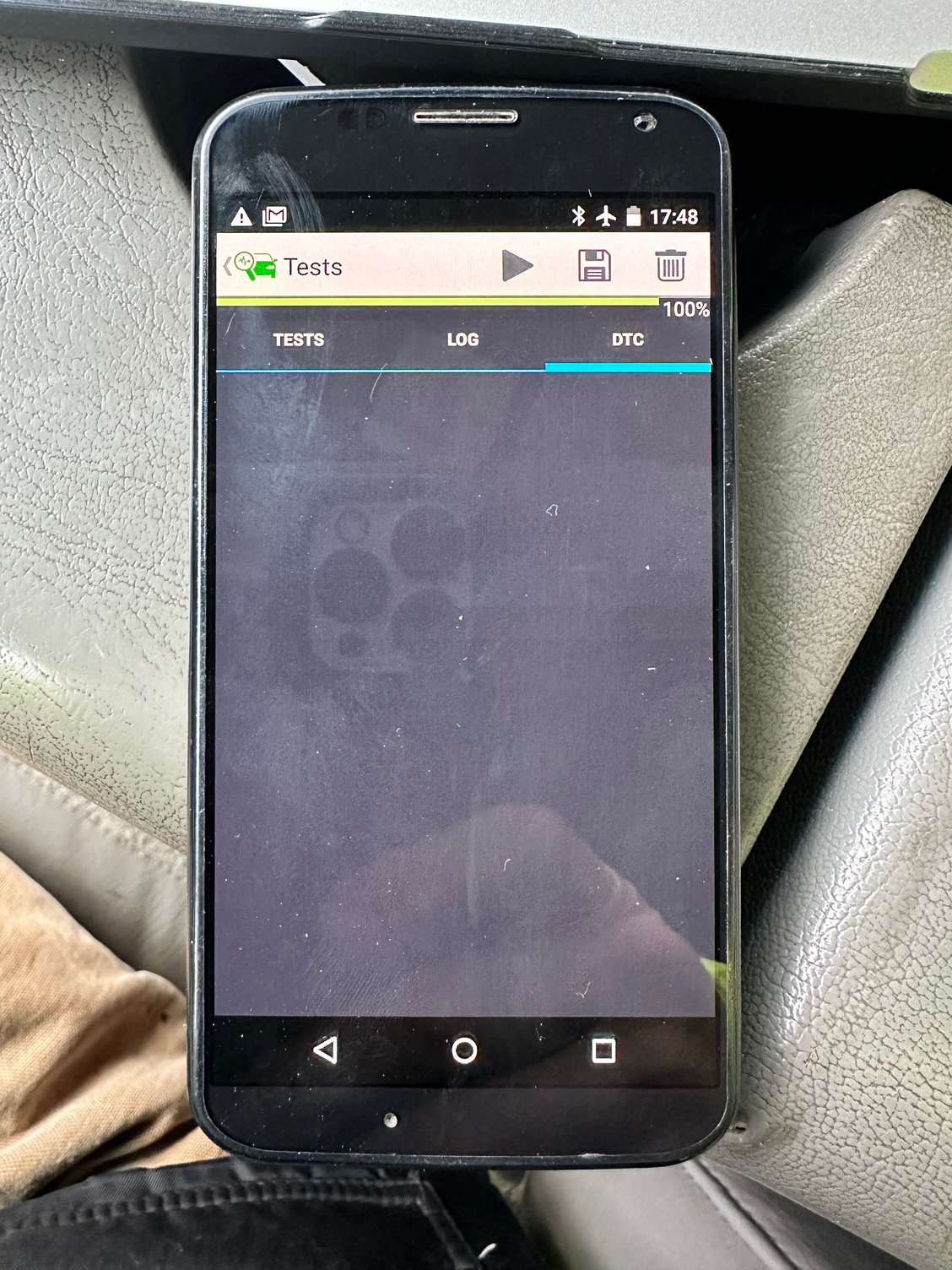

Well it randomly just started to work. This is the result after contribution test. I’m assuming it’s good if it didn’t return anything. I’ll upload the videos of the pirdels and buzz test

These tests are good to have in your pocket now. Nice strong buzz test. That lines up with the rig running ok at idle or low power settings, right? The low power/miss has been occurring at higher loads that these tests may not see. Confirming no codes after the buzz test?
