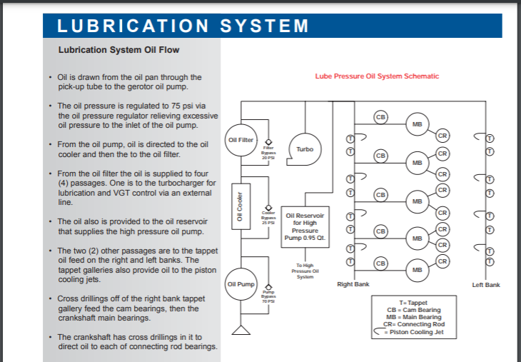

The oil temperature at the oil filter is before the oil cooler. You could leave it there if you want a true oil temperature Delta, not a differential between the coolant temperature and the post-oil cooler temperature.
You would have to use a Tee at the existing oil temperature sensor, which provides real values. People have done that, although it's not a normal fitting. I don't remember what size that is, Mark (Bismic) probably does.
lt would be one kluge of a stack of fittings, though.

Not following the thoughts above completely I guess.
The oil in the oil filter is after the cooler also - from the Ford info, and should be essentially the same temperature as the EOT sender.
Not sure what might be wrong w/ the OP's aftermarket setup, except that temperature sending unit must be immersed in the flowing fluid.

On the temp sensor, you can't tee the two sensors together and get accurate readings. The temp sensor needs to be in the flow. The oil in the tee will stagnate and cool off. It will get some heat from the main flow but will be off.
You can tee pressure sensors all day long without issue.
I wonder if the location sinister provides for the port isn't in the main flow. You may be getting stagnant oil that is cooling off. Filter is directly downstream of the oil cooler so temps should be pretty close.

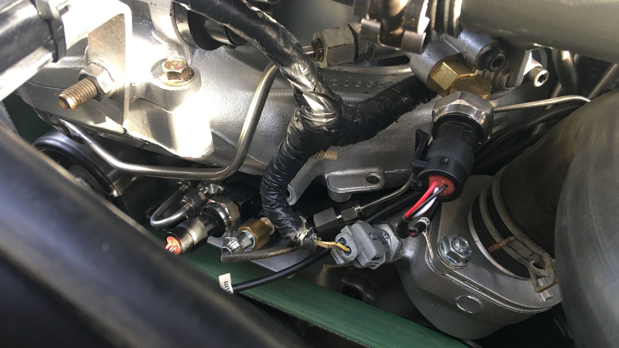

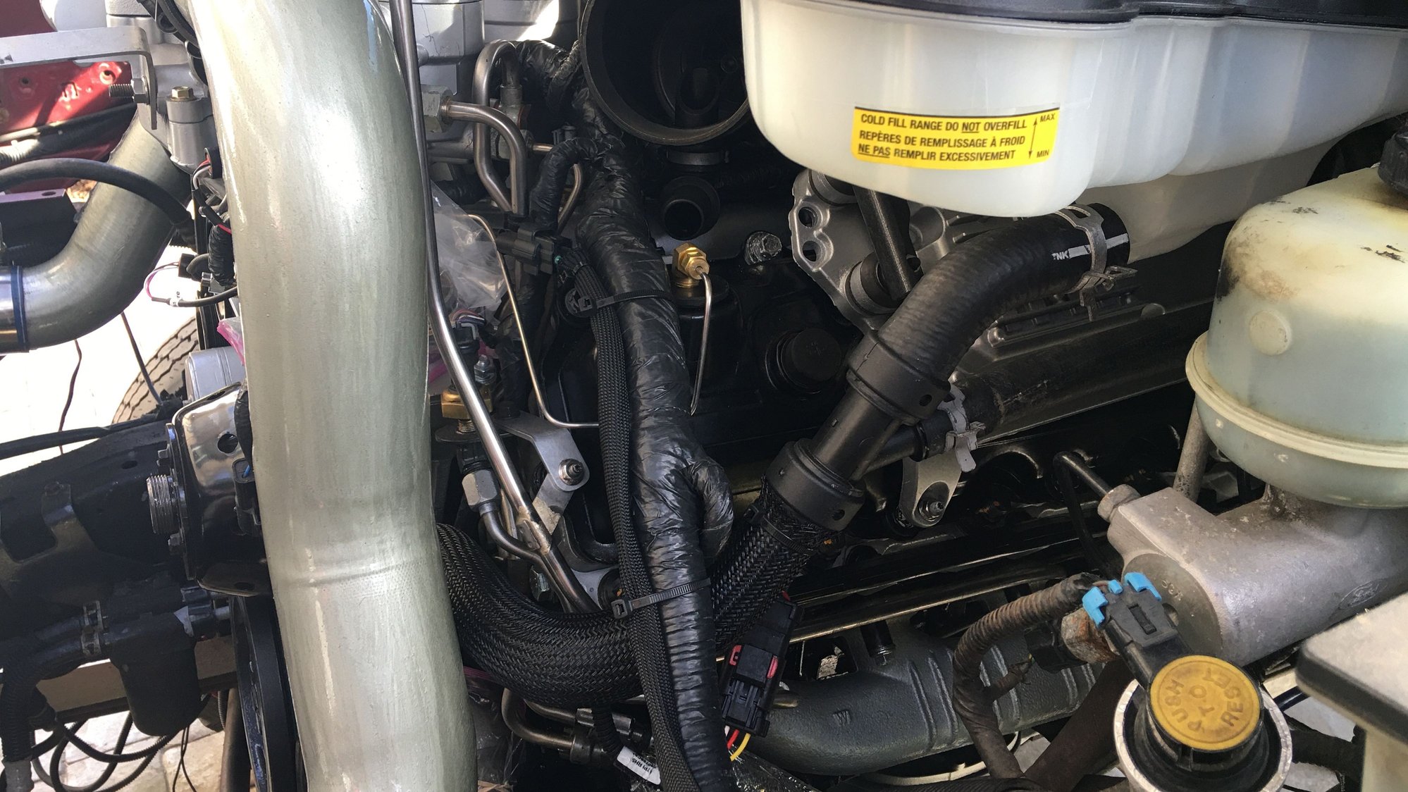

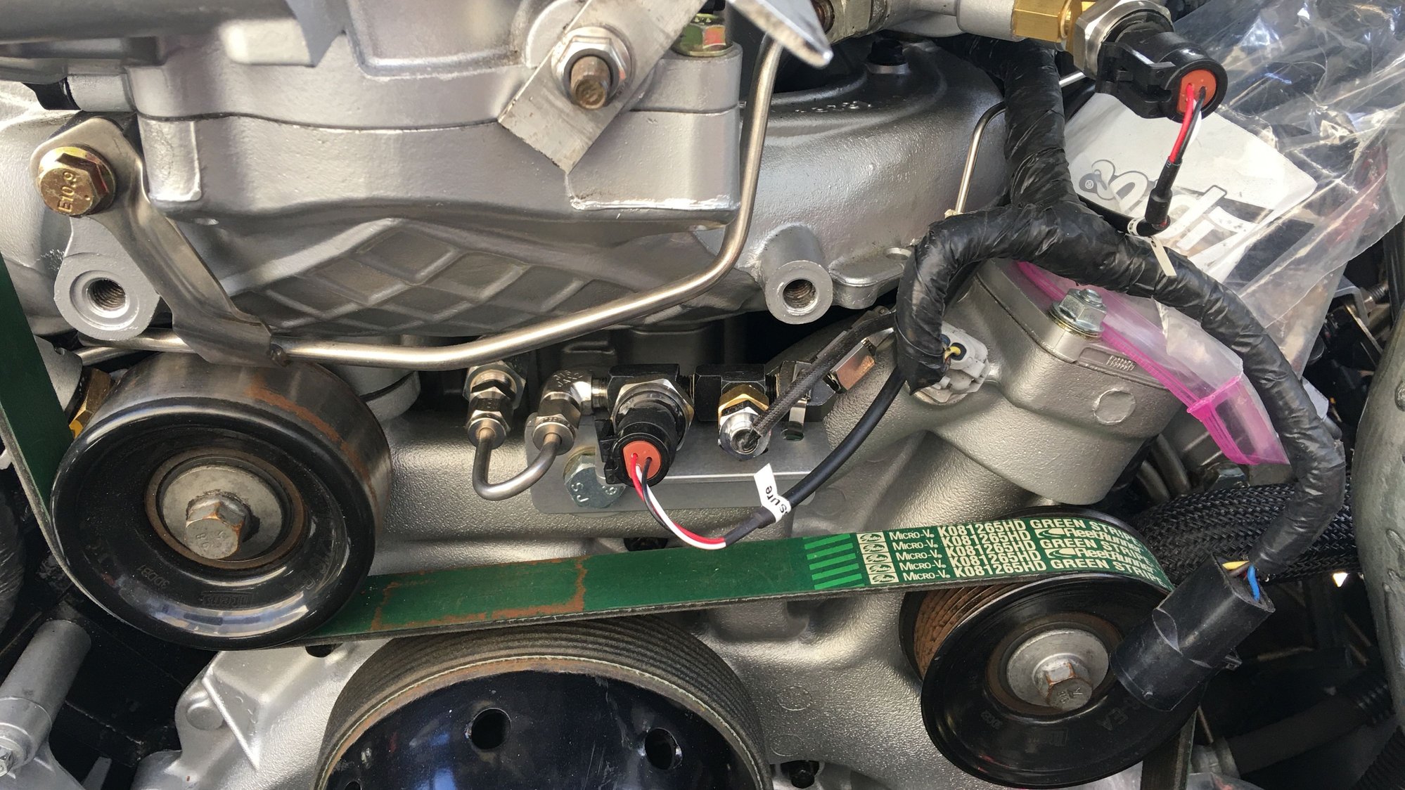

And to show more how much I went brain-dead earlier, here is what I set up on my truck.
I ran tubing from the oil cooler housing's test port to my oil pressure and temperature sensors. Then, I ran a 1/8" SS tube to the valve cover so the temperature sensor was continuously in the oil bath. This is post-filter.
This was temporary so I could check the calibration between the factory sensor and my aftermarket gauge. The temperature sensor now resides in my oil pan. Well, for now.
