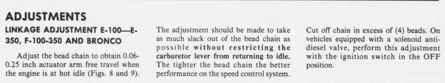

1) Do I just try to connect the ball chain to the throttle cable/rod (because of altered throttle position, made a solid rod linkage to take the place of the factory cable) at a closed position? I assume once the cruise is activated, the vacuum will hold the chain/rod/cable in a constant position.
2) Do I need a modulator/regulator on the vacuum line, or can I have it hooked directly up to the intake manifold vacuum? A lot of the factory vacuum lines have been modified/deleted so far.

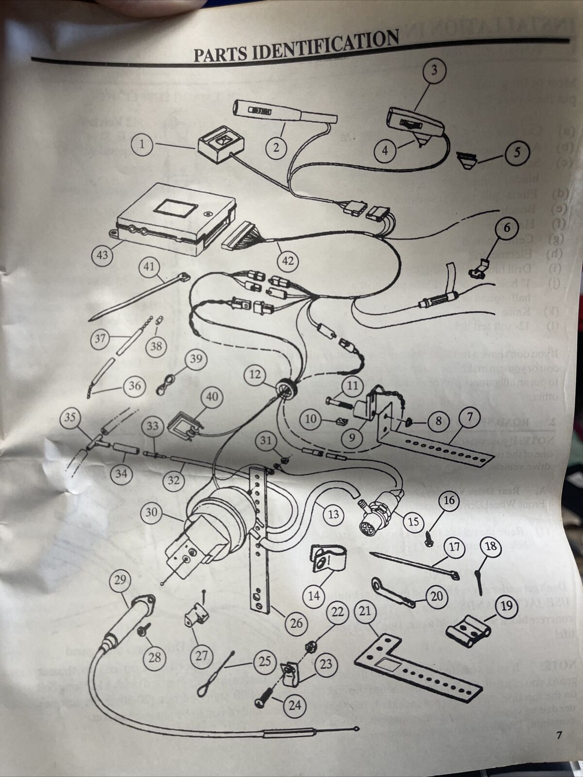

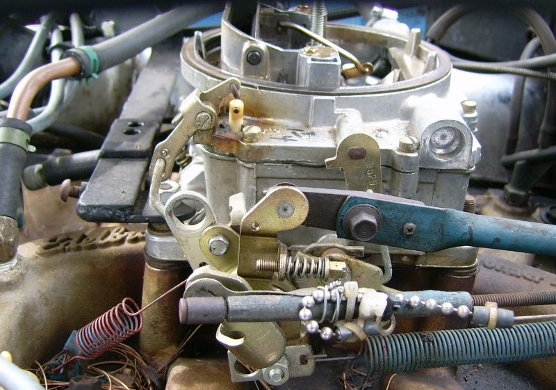

I've looked at the factory cruise controls then, they look to be the same as the DANA one I have on my '77. It's not the only way, but it's worked since the '80s, and before this truck, I used one exactly like it on my '67 Chevelle with 454 and TriPower carb set up. Worried about parts, I bought a still new in box never used one off Ebay last year. The ball chain wis crimped into a long metal retainer that has a hole so it too goes on the carburetor ball. Item #20 in the middle picture. I might think to replace the zip ties, they are a "few years" old now. I have changed the carburetor a few times, but just leave the chain as is. My vacuum "servo" used a single stud, it has a long wire flexible cable that is in a long guiding sheath like a choke cable, etc. I just have it mounted on the firewall.
Round thing in last picture is just a grommet.

Just hook it to throttle lever, There is a factory clamp on end for carb end but unfortunately made of unobtainium. You should have a vacuum reservoir between cruise and intake for best results.

Nothing in my set-up is factory anymore, but just wanted to verify that I could hook it up to the throttle linkage with little to no slack and be fine. I do have a vacuum canister hooked up to the system, but did see some vacuum regulators in the original factory diagrams and wanted to make sure we didn't need these.
