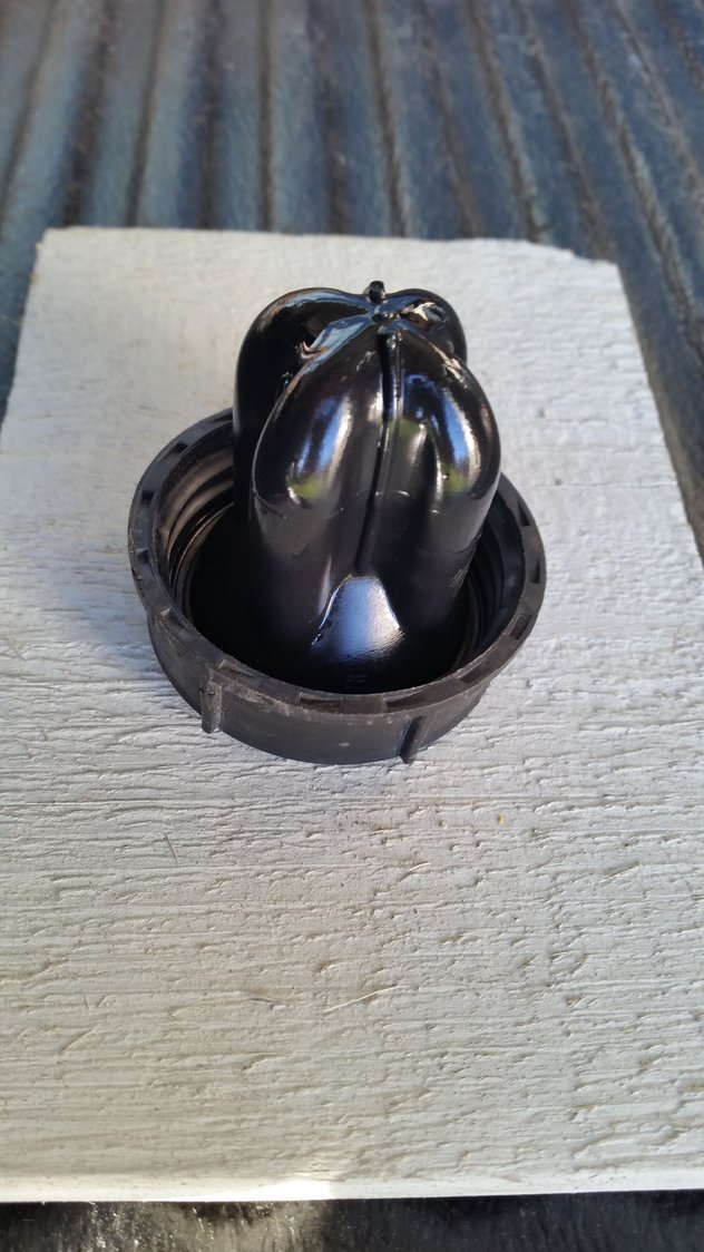

All kidding aside we would like to hear about your "rubber piece" and see a photo. I'm wondering if you have an original master cylinder. That would make sense since your firewall checked out ok. How many miles does your truck have?
You did post that you were low and added fluid but if you have the two piece cap and rubber piece and you didn't remove it to check fluid then you may have filled up the rubber piece and that won't make it down to the master reservoir.
Notice I did not refer to "rubber ducky". Out of Respect...

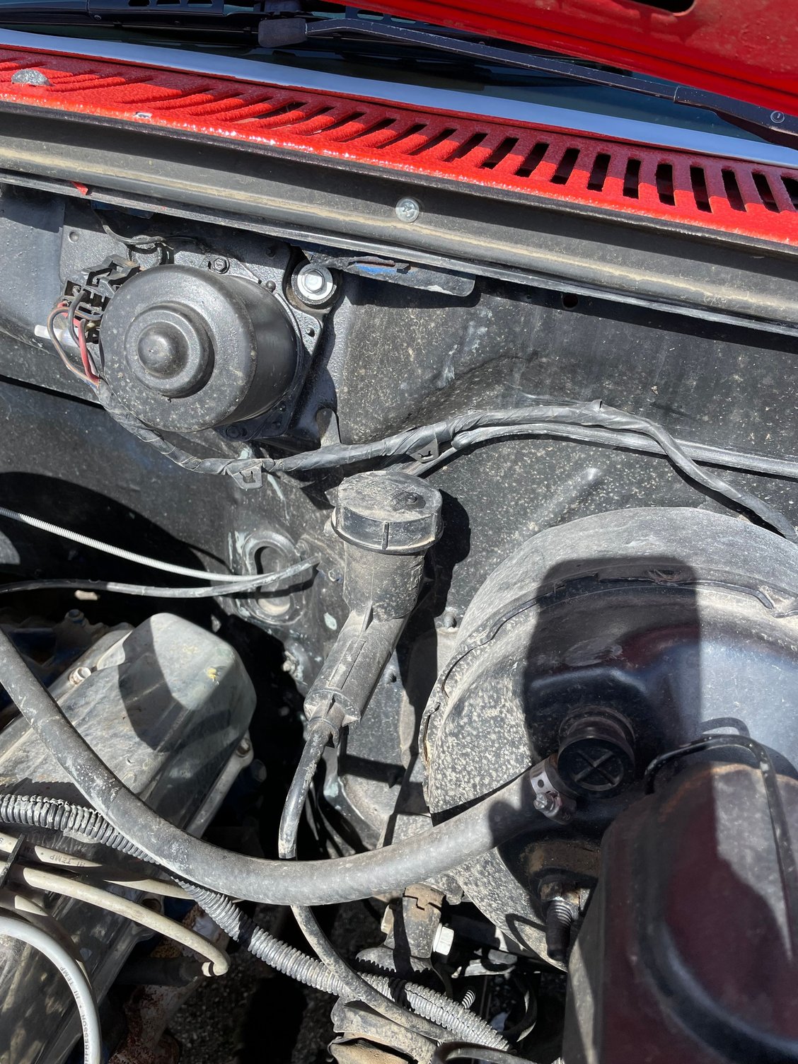

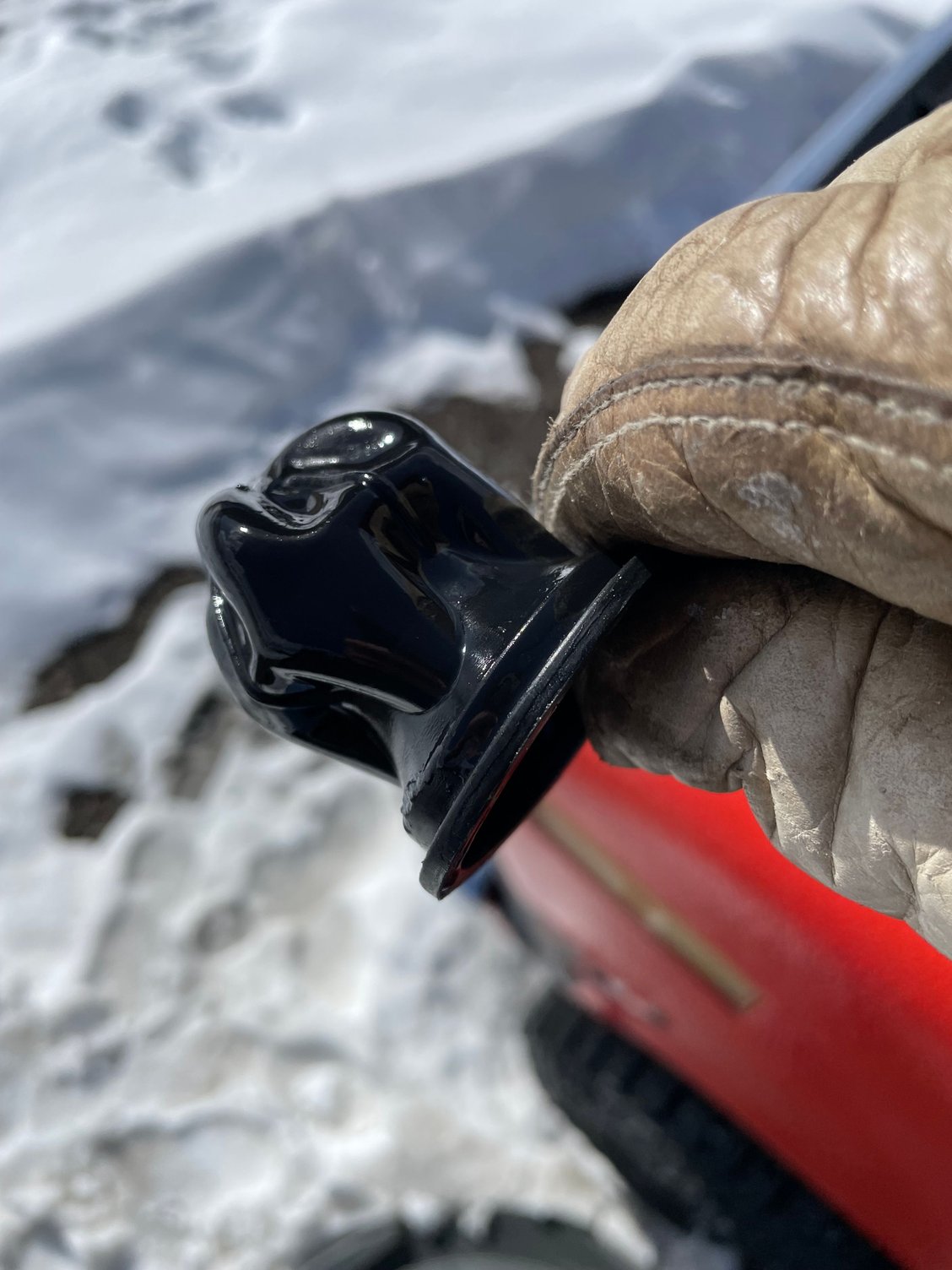

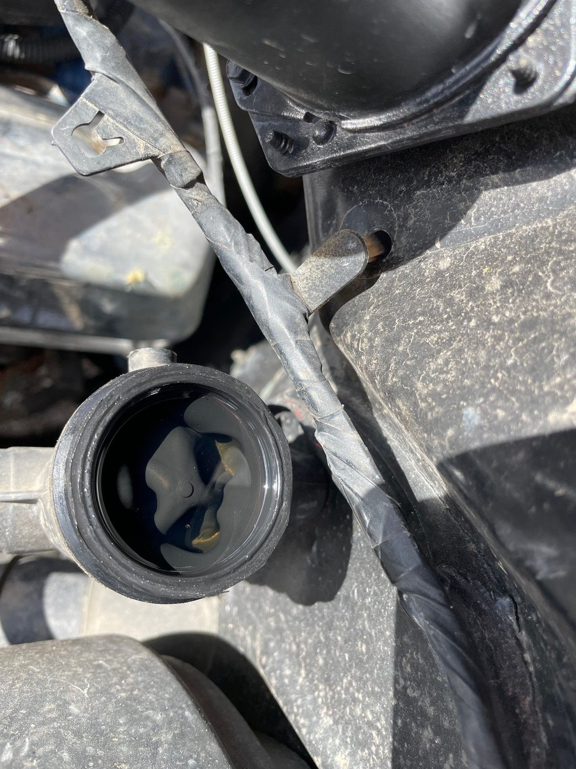

Big Blue and all u guys I got out there and did it. I’ve attached pictures. Rubber Duck was pushed into itself when I first pulled it out. I then pushed it out into its proper form. The fluid appeared to be at the correct level and was clean. I put ducky into place and screwed down the lid. A small amount of fluid squeezed out so I guess that means it’s full. Sherry and I drove to town and the clutch worked just fine. Except for follow up comments I’ll consider this post closed in regards to my clutch. As usual I learned stuff that I had no clue even existed…so thank you.

Thanks for posting the pics of the rubber ducky. That's what I remembered my original OEM master having. So I'm not losing my mind yet. How many miles on your truck? Low I would suspect. But possibly being an upper Midwest truck it could be as high as 250,000 miles on an original clutch master and firewall as you get a lot more miles per clutch depression out there.

The only thing I see that concerns me is in the second picture, what's that rust like stuff, in that fold ? Is that something that shows there may have been some moisture in the system in the past ?
I would think he should keep an eye on the color of the fluid. Hopefully it stays light and does't get dark, which would show there is some moisture in the system.
Do you guy's think that is an issue ?

Max Cap I do see that now that you pointed it out. I’ll get back out there today and inspect further. I don’t believe the system has a leak but you never know. When I again pull this rubber piece out and do find discoloration what should I do? As u can see the fluid is super clear…like water.
