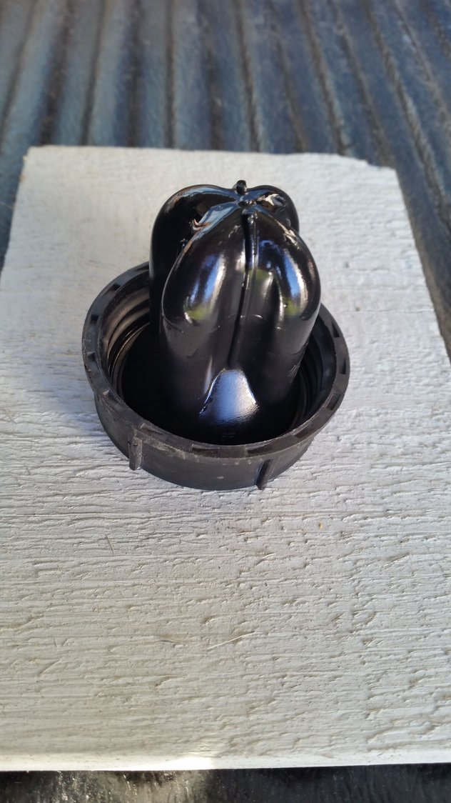

Old Feb 17, 2024 | 01:04 PM
  #59
BigBlue2's Avatar
BigBlue2
Joined: Apr 2002
Posts: 5,311
Likes: 1,243
notice the rubber ducky has 4 pleats. As the reservoir level goes down the ducky can expand to take up the volume. Similar to the accordion rubber seal in the top of the brake master.
So the fill line is the level where it can accommodate the rubber ducky with out spilling over the top. Replace the Cap-N-Ducky carefully.

Does he need to push the rubber ducky back into the cap ? Like what is done on the brakes.
