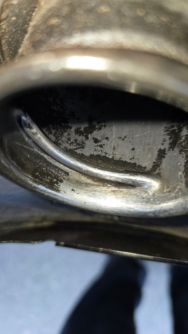

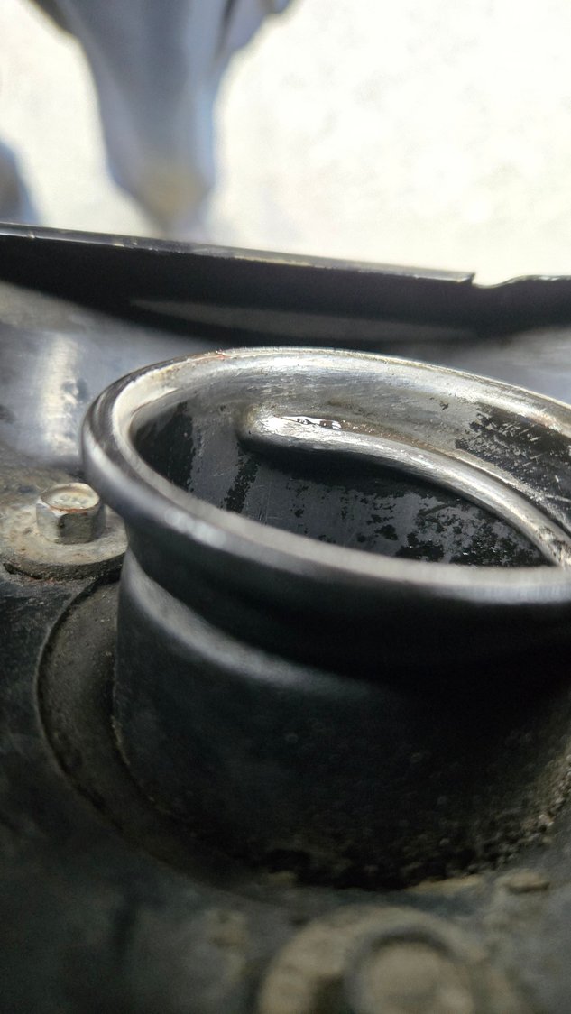

I left a message on their website IIRC on a Sunday and they sent me a text message the next day on my phone with Nicole's cell number.
I sent pics of my regular fuel tank cap threads and pics of the fuel metal fill pipe.
She said they appeared to be "too angled" for the cap to work. I told her I wanted a DEF cap also. She then said she would send them to me, free of charge, so I could test fit them, which IMO, is fantastic customer service.
The set shipped Monday and arrived Wednesday.
On Thursday, out at the EVOC course, I crossed my fingers, turned it on and she fit like a glove.

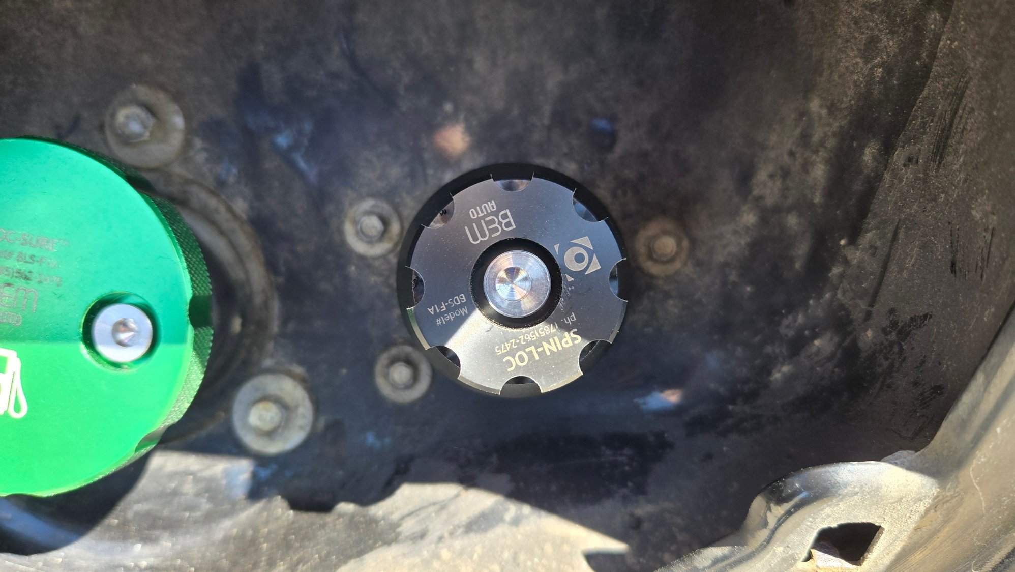

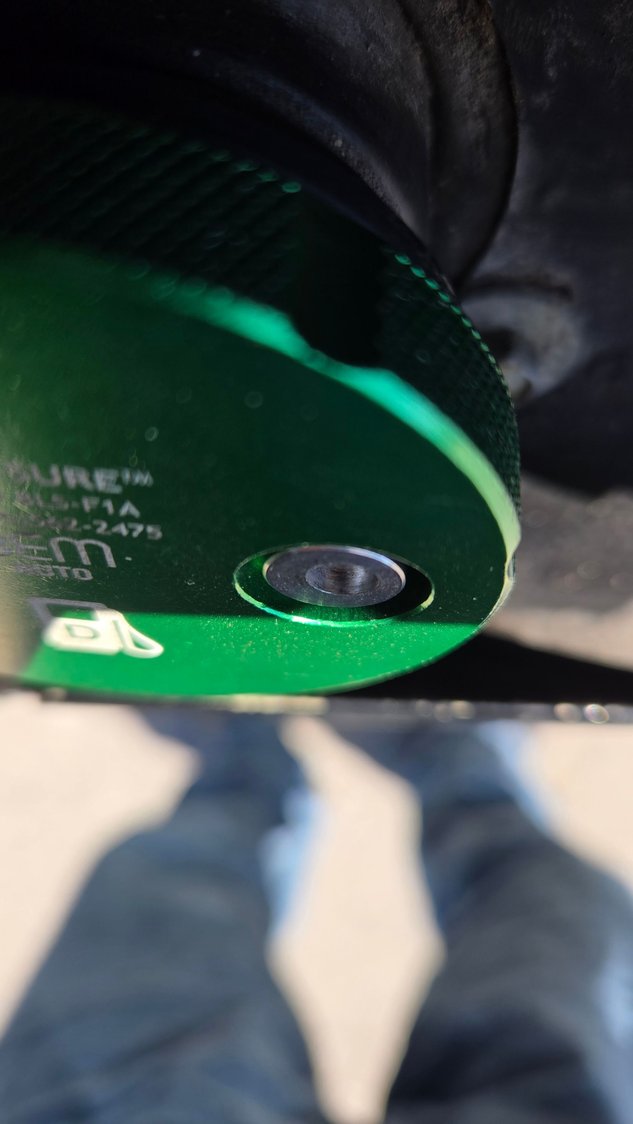

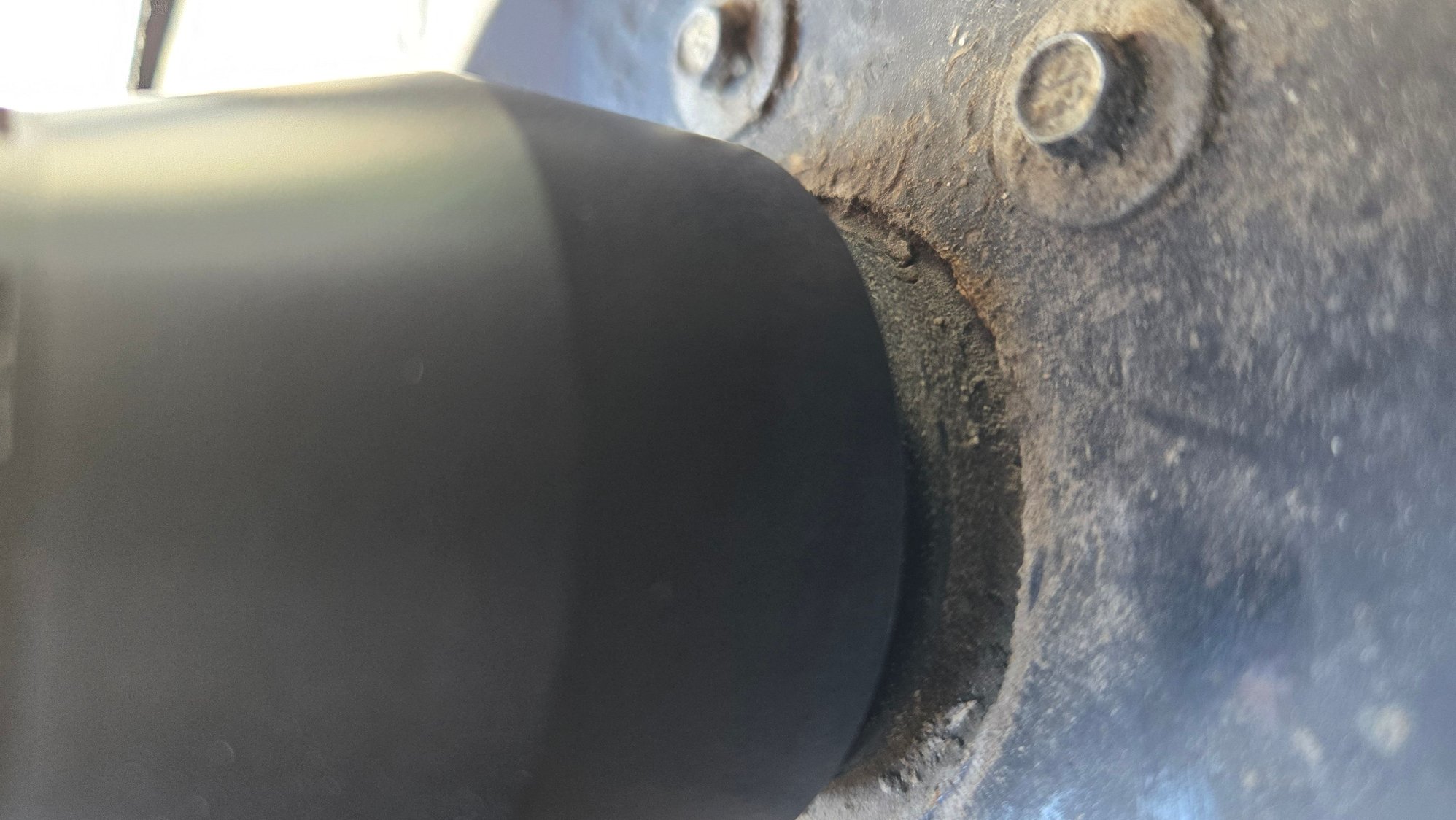

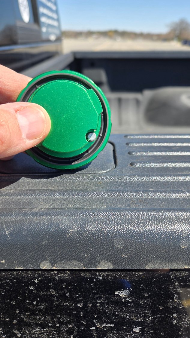

These are the pics I sent Nicole...
The aftermarket diesel fuel cap I bought because couldn't find the original cap that was somewhere in the garage...

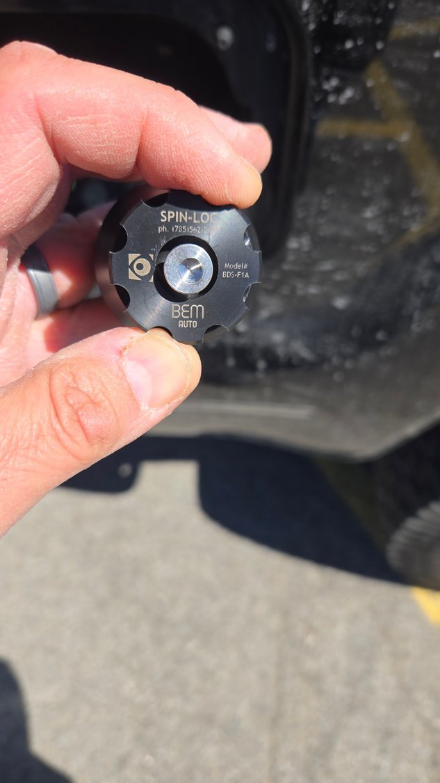

I should have taken a pic when I first got the BEM fuel cap because it appeared to be solid... but was not.

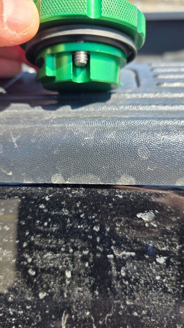

So the screw was not flush but seemed to be locked on...

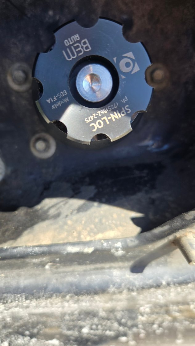

This is what it looked like. Sent Nicole the pics and she was going to send me a video link, also told me to press down harder when screwing it on. I fixed it.

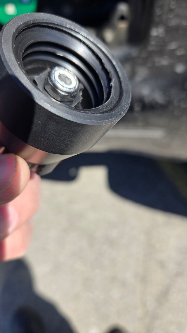

The rubber seal needs to open up to enclose and seal the cap on the end of the filler pipe to the cap.

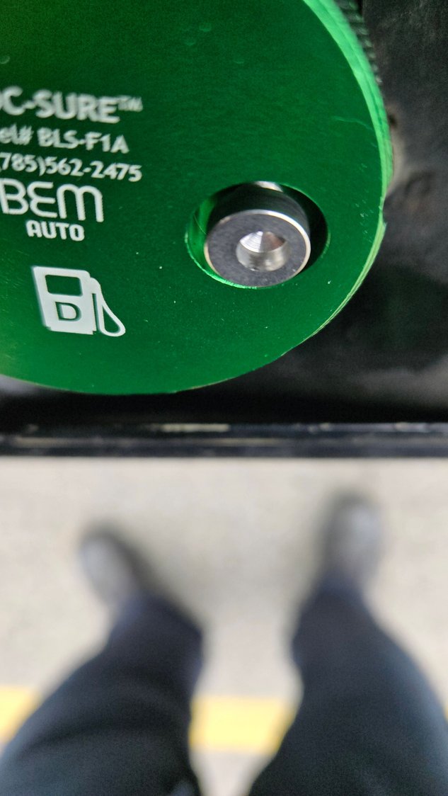

With the open seal, the screw snugs right down where its supposedly to.

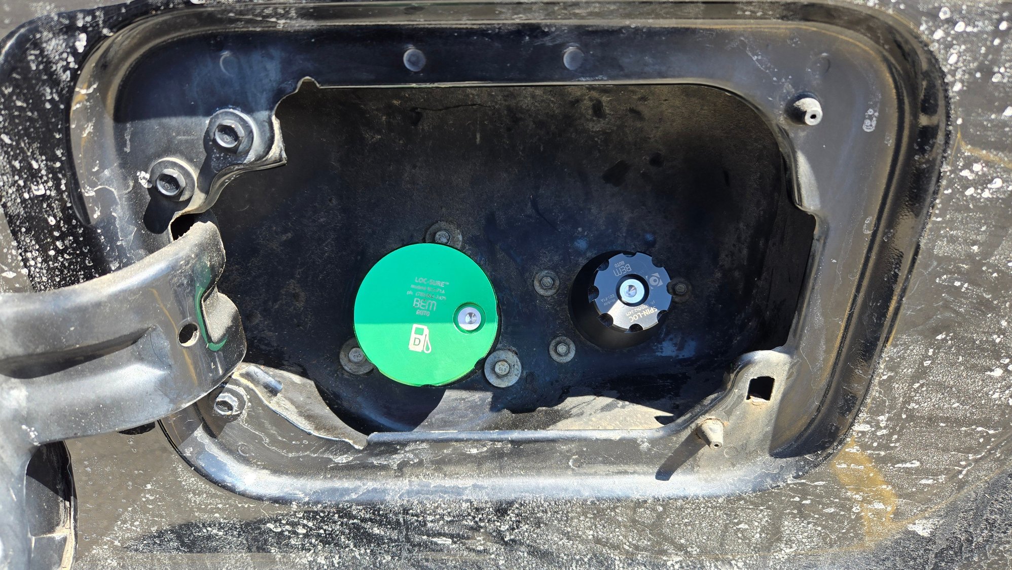

What's nice is that it is probably about a quarter turn for the cap to lock on... or maybe not even. Then turn bolt down. Feels solid because it is... a piece of machined aluminum locked into threads on the metal threaded pipe. Same with the DEF cap.
I never liked the way those Tank Warden caps moved around because they are not threaded into the filler pipes of either...

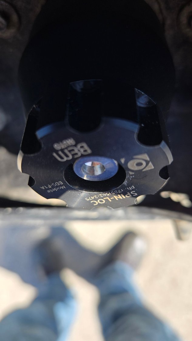

DEF cap...
Well machined piece of plastic...
Snugs right on the DEF filler pipe threads.
