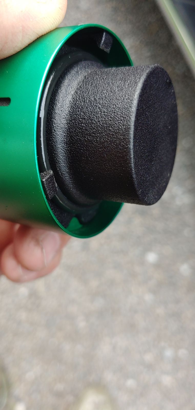

I hear you on your concerns. I was a little surprised myself when I saw the caps and the flimsy locking arms... but I was already in and ahead of the game because I now have a locking DEF cap as well. As I've said here before, I thought the BEM cap set wouldn't work on my gen truck because they listed them for the 17 Alumina Duty trucks... I didn't look into them enough and should have.
As to the bling factor, I really don't give a schitt about that... I thought I was buying a good set of locking caps for my truck... and yes, the jury is still out if they can withstand an attempt at theft... I don't have the answers. Like I just said, I'd probably have that BEM set if I knew they worked on my 16... but it is what it is.
Yes, 250 dollars was a lot of money. So I'm not going to attempt to break or otherwise damage mine to test them. Maybe if I was wealthier I would. I do like have the locking DEF cap now as before I had the Stant cap for the diesel cap.
Here's a few pics and I'll provide a few more comments after.
Those ridges from the cap lock together into the aluminum cap... this was in the locked position.
Yep I agree with the thought those arms are chinsy... I hope there's a method to their madness. The cap fully spins like the Stant cap does. It does rock very slightly. I also grabbed it and was yanking pretty **** ing hard and it's on... as for your standard $10 locking cap OEM style, like my Stant, check this out. Again, maybe the strength of the Subtle Design is the lock mechanism itself... I don't know. You decide...

Thanks for the photos and insights OK2.
This will hopefully be my final Tank Warden post. My first-hand experience revealed the undeniable flaw that precludes longevity. I doubt improvements are forthcoming.
I strongly advise against this product unless redesign upgrades incorporate a metallic 4-pronged retention system with positively aligning fuel spout lip interfaces. SD attitudes negate confidence.
*My sole reason to post re: Subtle Designs $250 Tank Warden was to help each of us contemplate seller's intentional mechanism obscurity, inferior material choice verses price-point, and a tell-tale 2-week return policy "FROM THE DATE IT LEAVES OUR FACILITY" ?.
>DEFECTS TELL-TALE> "Due to the nature of our handmade and customized products, returns within 14 calendar days from the date the order leaves our facility are accepted on a case-by-case basis; only on rare occurrences where the product demonstrates a clear manufacturing defect impeding the advertised function of the product." <100% HOGWASH<
If anyone cares to know the true character of people at Subtle Designs when things inevitably go awry, and how they wriggle, invest a bit of time in reading to the end. Had I known, I would never have done any business with them. My philosophy differs a bit OK2. We do not always get what we pay for with our hard-earned cash. Expensive mechanism with short return windows require thorough testing to avoid chintzy product di$appointment$ so that we can return the bad stuff in time for refunds. That being said, I am not suggesting abusive mishandling. Details of the weak diesel and DEF retention band-end nub failures during first installations are below in the copy of my request for an RMA, plus Subtle Designs initial claim that they do not accept returns. The obvious side-benefit of detecting and returning faulty products is potential motivation towards improvements to avail intended functionality and cost-justified time-in-service. It also deters proliferation of bad actors and their falsely promoted inferior product marketing for ill-gotten-gains at our expense. Most of us worked hard for our money.
They surely do accept returns in compliance with laws, albeit within their suspicious 2-week mandate. OK2, I drew in-hand Tank Warden conclusions on May 13th, and returned one failed and another sealed kit for the $500 refund which came yesterday. No accounting for hours of time invested to understand why they hid their doomed retention system insufficiency. I anticipate definitive wide-spread failures, although most may not post about them. Mark my words. Those pathetic composite nubs made of mystery material don't have a snowball's chance in Hades. Subtle Designs curt and cagey verbatim correspondence is down at the bottom.
The only physical resistance to cap deployment are those three nubs. The ridges you mentioned protruding from the molded plastic core which houses the casino-style lock and spring act as tin cup guides during compression, and stabilize it in situ. The O-ring flange seal is retained within the molded housing groove surrounding the bung. The casino-style lock holds the spring-loaded tin cup down. The tin cup forces the tri-band end-nubs inward to engage the outer fill-neck flange. Pushing the tin cup into locking position compresses the spring within the molded plastic core housing to pressurize the O-ring and weak tri-band end-nubs. The fill neck flange is squeezed between the O-ring and three nubs. Those very weak fiber-reinforced composite tri-band end-nubs are the only retention system. The tin cup rocks when locked due to a soft spring-rate since the weak band-to-nub composite unions cannot withstand much stress. Those retention bands are very smooth while the nub ends have a mildly stippled finish. I noticed early nub surface wear on yours. Only Subtle Designs and the manufacturers know how they are created. The smooth non-expanding bung does not flare-out under compression when locked, precluding interface with the internal fill neck threads. Sooner or later down tha road, I would bet my entire livery that one-or-more of those thin band-end nubs will eventually crack in the crease, or break-off completely on many, if-not all of these units. Tuck an alternate cap in your trucks. Unfortunately for buyers, Subtle Designs did not go the extra mile during R & D to avoid their perilous defects by developing an aircraft-grade alloy or spring steel quadratic-band retention mechanism, and incorporating a stronger compression spring. It most-likely came down to budgetary restrictions, and bean-counter revenue forecasts that led to these inevitably short-lived mechanisms.
Love the idea. Hate the result. The worst factor is that other more-capable engineers may move onto another project if word does not get out that Super Duty owners still need a genuinely effective long-service design to defend their diesel, DEF and gasoline tanks. Subtle Designs tried to tell me that they don't really accept returns. That should speak volumes, if you prefer to do business with decent, honest people.

I removed the OE DEF cap and retainer. Then I removed the white zip-tie, and slid the blue DEF cap over the spout the same way with no resistance. The key would not turn very far to the left. I know better than to force anything mechanical. With key to right, I removed and inspected it closely. There appeared to be a fine crack where the angled black plastic retention tip is molded off the flat plastic finger-tab.
When I removed the green diesel cap for the first time, one of the retention tips dropped onto the lower shelf-base of the fillers shroud. The entire units are cosmetically as received, and my experience leads me to believe that the retention tabs can be replaced upon disassembly. Based on extensive life-long mechanical experience, I was, and am dumb-founded. I could not have been more careful with the caps and first install process. I'm skilled with body panel tabs, delicate alloy parts, and also rebuild turbochargers, etc.. I wanted to speak with someone at Subtle Designs about technical aspects, as I cannot see any sense in attempting to install the 2nd set, which is still sealed in the box, since I was extremely careful the first times.

Okay they responded already...
Hello and good morning Dave!
The Nylon 12 is rated to a minimum of 10,000 cycles from our testing. We actually tried metal years ago, at the beginning of the project, and those didn’t last even 20 cycles and fatigued. Would’ve been cost prohibitve to manufacture as well.
Should anything ever fail, the Nylon core can be easily exchanged by us or the customer. While unlocked, the roll pins can be pushed in further to remove and replace the core with 3 new roll pins.
Lisa
On May 26, 2024 at 10:58 AM -0500, Subtle Design <sales@subtle.design>, wrote: Name Dave Email
Message Hello,
I was excited to get the Tank Warden set for my 11 to 16 F350. There was no manufacturing defects at all and it functions like designed and stated. What drew me to your product was the lock itself. I like that someone cannot just insert a screw driver into the lock, strike it with a hammer, pop the top off like on the Stant lockable cap it replaced and get into the tank.
But I would be lying if I said that I am completely satisfied with the design of the inner lock made from a composite plastic, and not metal such as a steel alloy or aluminum like the cap itself. Those would have still been able to flex as required and would have been more durable than plastic. Four arms would probably have been optimal as well as a tighter fit of the plug that inserts into the metal fill up tube which would have prevented the cap from wiggling as it does when grabbed in the locked position.
I am just wondering what happens if or when, those arms, and/or the tabs on the ends, ever break due to the material they are made of. At a $300 retail price, with an introductory price of $250, I would think that the inner lock mechanism would have been made from metal making it more stout and durable for the cost of the product itself, and have a stronger warranty.
I'd appreciate a response and I thank you for your time.
Dave
I replied back with:
Hmmm... okay thank you Lisa for your quick and complete response...
Did you guys do any testing with those to see how well they held up to an attempt at getting into them by prying at all? Just curious.
Thanks and have a good weekend.
Dave

Well-executed inquiries, and straight feedback to them on their design flaws.
Not buyin' Lisa-talk. Wondrin' what metal, if any, they supposedly tested that would fail so soon.
HP PA 12 has strong properties depending on applications while observing modeling limitations and stress exposure.
Subtle Designs claims 10,000 cycle test? Not in their thin configuration with a highly-stressed fulcrum point at the end of a thin strip.
She did not reveal the cost of replacement cores for either the diesel, nor DEF caps. Their not about to return to R & D regardless of proven issues.
No mention of strange, small configurations in similarly extreme stress applications. https://duckduckgo.com/?q=Nylon+12+i...vivaldi&ia=web
No imagery showing 12 in small and strange forms proven to resist extreme stress cycles. https://duckduckgo.com/?q=Nylon+12+i...ages&ia=images
Dissection of Lisa's word-play reveals contradictions.
"The Nylon 12 is rated to a minimum of 10,000 cycles from our testing." Firstly I've witnessed stress testing, and no-one stops at exact round numbers.
If Subtle Designs actually ran 10,000 cycles on their retention strap configuration, why would she write; "The Nylon 12 is rated...", then claim "from our testing" ?
Any manufacturer who truly tests will plainly specify equipment or subcontracting lab, configuration, number of cycles, and stress resistance specs applied plainly and simply.
While 12 can be formulated and cured for a diversity of tried and true industrial applications from pulley belts to trolling motor props, it is not suitable for Subtle Designs thin strip end-nub.
That's why it cracked at the inner 90 twice due to forces generated by the fill neck flange during initial installation. That weak point cracks while stretching under spring pressure during key-turning.
I encountered heavy key resistance while bottoming the diesel tin cup. The key fought full red dot alignment for extraction. Subtle Designs definitely mentions key resistance during the break-in period.
I do know that I was very careful because I wanted to avoid damage on a strangely designed mechanism. I wanted the tin cups to function far-more than Subtle Designs does to secure my fuel and DEF!
Catch y'all on tha flip-side.

Me:
Dave
Hi Dave! The owner has tried to pull it off by grabbing the aluminum sleeve and putting fingers under the backside, but it is slippery and was not successful. Prying on it with tools would probably damage the filler neck. The caps are to thwart casual vandals and bystanders who have an agenda.
We have an emergency unlock procedure if you ever lose the keys and would allow the lock cylinder to be reused again.
>>>>>They show a picture which I am not going to post here which shows what they "recommend" for an emergency access... not giving any ideas to anyone....<<<<<<
Me:
Okay thanks...
So how much would a core cost if needed? And do new roll pins come with the new core?
Beyond the 14 day return policy, is there any warranty on them at all?
Dave
We don't sell the cores, as we would recommend that we do any refurbishing at our facility to avoid issues the customer may have (a shipping label would be given to the customer). New roll pins would be used.
I don't have a price on a refurbishment procedure, as we haven't had to explore that in the nearly 3 years it took to make this product; the original is still holding up great. I can't imagine it being more than $60.
For warranty, 1 year from date of delivery.

* They must have repaired "refurbished" the failed diesel and DEF caps that I returned by replacing the tri-band retainers, and re-sold them by now.
Good (and bad?) for buyers to know Tank Wardens can be removed sans key in a pinch.
Does "roll pins" refer to their 'Nylon 12' tri-retention element with the three thin bands and end-nubs?
