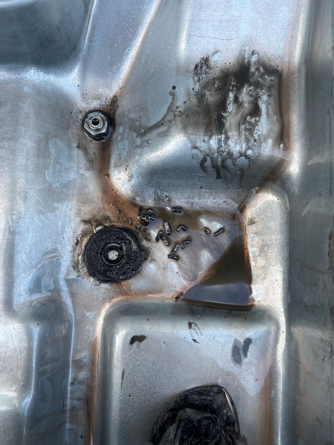

Unfortunately I don’t know how many miles are on the trans, but on the last two fluid change there were a couple little chunks of debris in the pan.
