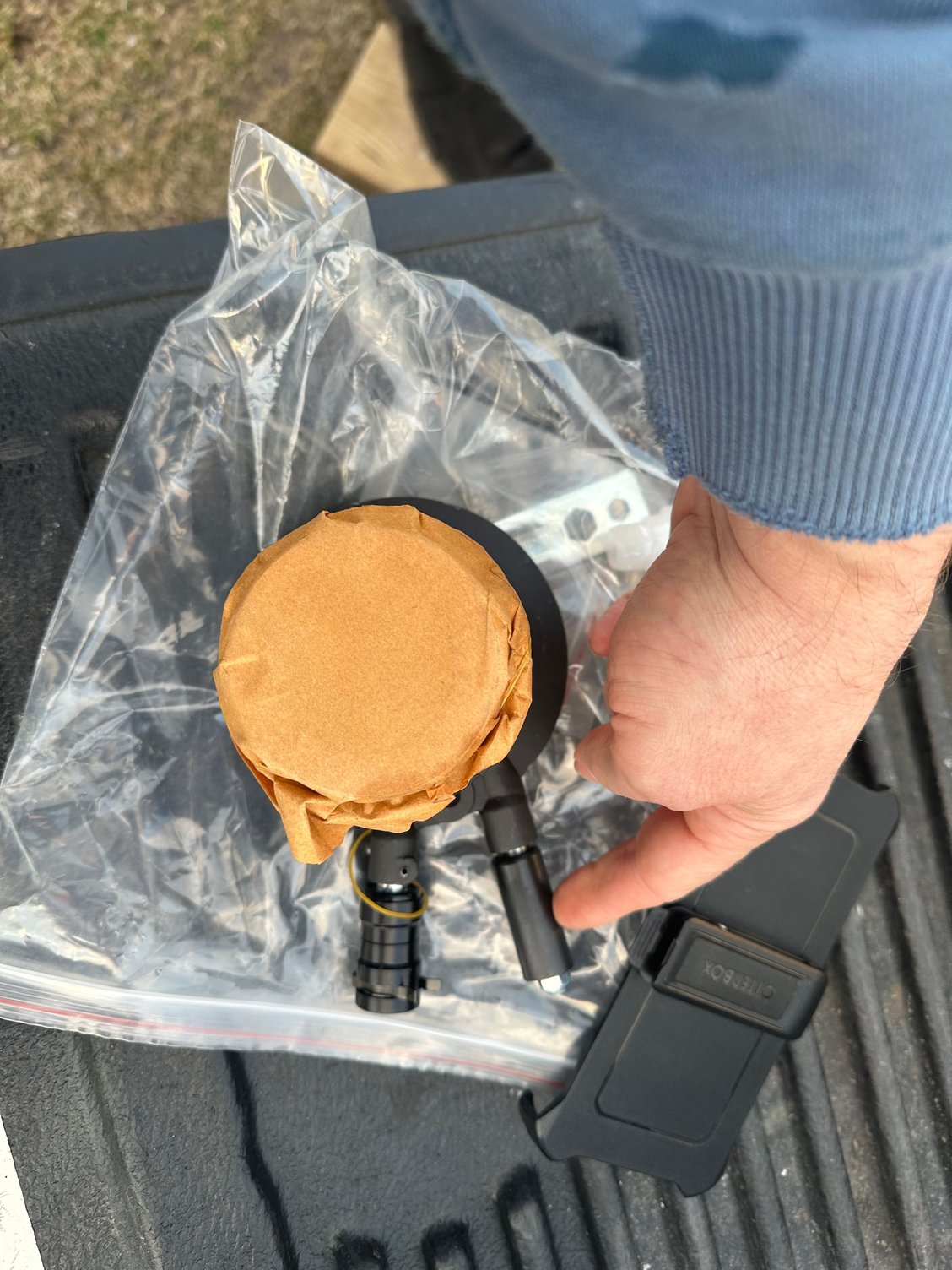

@Franklin2 @FuzzFace2 thank you I did look on rock auto and I did see that the pilot bearing and bushing were the same for like 15 years. For vehicles with 300 in it.
i’ve started receiving parts this week, and I bought it from Rocco and I did the searching for the slave cylinder as discussed. And the slave cylinder looks different from the one that I received the one that’s in the transmission.
Trans
Rockauto….
what do you think?

Keep using rockauto for reference. What year was the original slave? What year did you order? Look up the hydraulic line for the slave you ordered. Is it the same part number as the hydraulic line the old slave uses?
Transmission is a 97 or 98.
1989
the hydraulic line was the one that came on the slave. I didn’t order just the line.
. The slave was the same part number for the 89. But the truck that I used in the search criteria was a F150 with a 300 as there wasn’t a F100 at the time.
After looking at it for a third time I think it may work. I just don’t understand why the line is different. That would tend to indicate that there is indeed something going on with the slave not being correct.

There is a danger that things will not match up sometimes unless you research what you are ordering. The transmission and slave and hydraulic line are all 97 or 98. You are ordering 89 parts. Just be careful, Ford liked to make little changes sometimes. It takes some time to look things up for the different years all the time, but it helps avoid mistakes.
The aftermarket parts places try to stock the least amount of parts on the shelf as possible. So if a part will work for several years, that is all they will stock. You may encounter minor differences, but they usually will work with a little massaging. Sometimes the instructions that come with the part will tell you what you need to modify to make it work for different years.
For instance it's not unusual to get a replacement brake master cylinder that has adapter fittings installed to make it work for your application.
