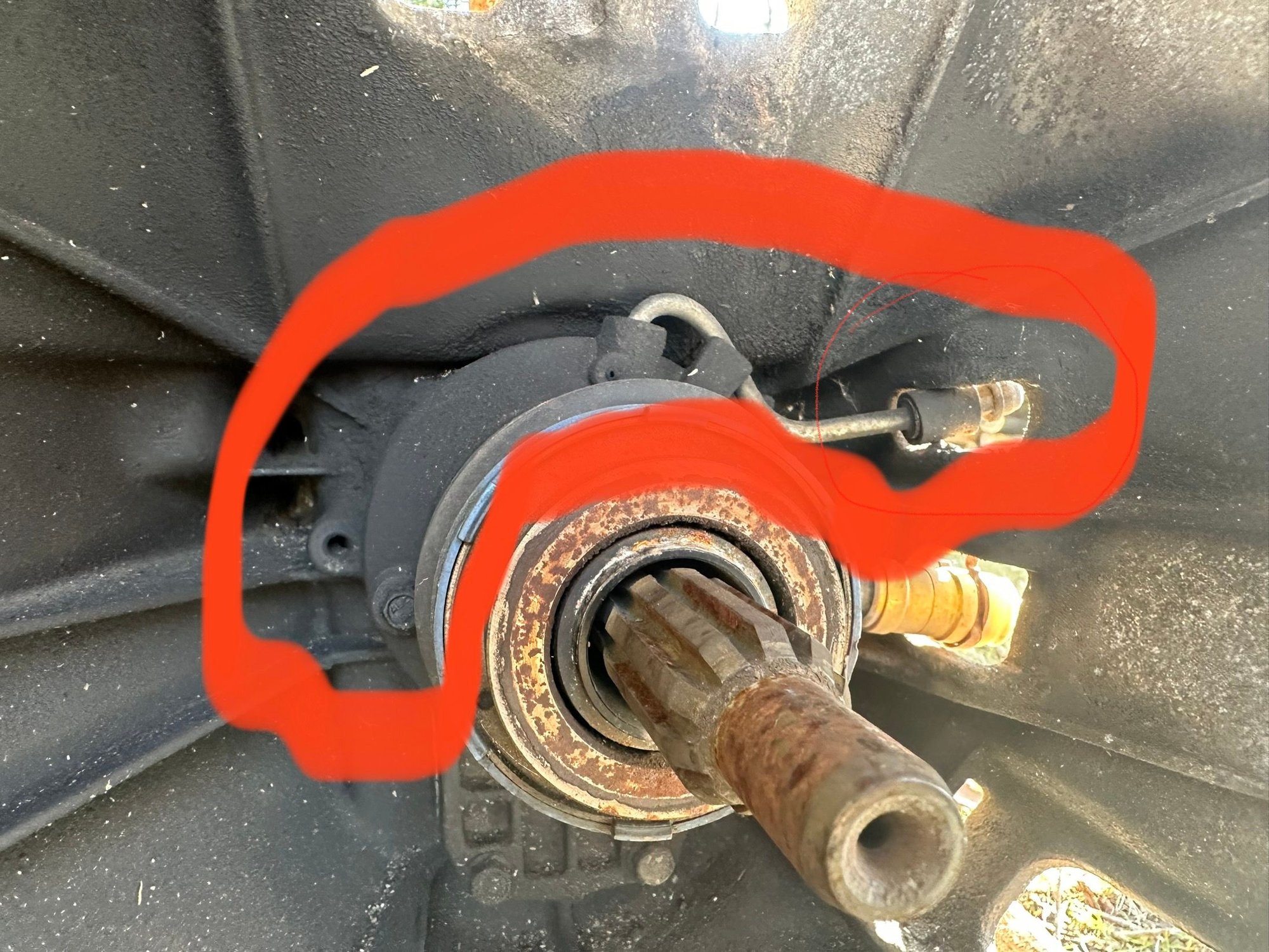

Thanks @Franklin2 for your response. I think your referrring to Rockauto PNs to compare different years for both the slave and the flywheel?
pic of what I think is the slave on the Mazda trans. You mentioned it in your response

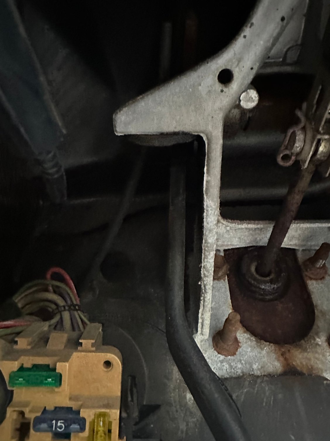

On the pedals if you have a 80-83 truck, think 84 to 86 went hydrolic you have to use the 84-86 pedals as the 87> dash is different and will not bolt to the <86 trucks dash.
Cant help on the master as my 81 F100 uses good old linkage
Dave ----
My 81 has a clutch pedal. The truck originally had a three on the tree trans. Some one then installed a C4 or C5 and graciously (maybe) left the pedal. From the previous conversation I believe this pedal won’t work? There was linkage hardware on the frame rail at one point I believe.
thank you both @Franklin2 for your feedback.
I have not looked that close at the hydro pedal assy. and the linkage assy. I have but I believe where the arm on the end of the clutch shafts are at different clockings.
I also dont know because of the different clocking if the shafts are different or if you can change the "arm" on the ends?
When I say clocking look at the arm on the end between the 2 assy..
Linkage is set up to push a rod down through the floor where the hydro one pushes through the firewall where the master cly is bolted to.
So you may need to come up with a hydro pedal assy from a 84 - 86 truck.

Same with the slave, though you will need to pick a 1984 300 six and compare it to the 89. I believe they are all internal, you will see that right away when you look it up.
I have read that the Mazda transmission have the internal slave cylinder. The slave cylinders are different from the 84 & the 89. Rockauto has several kits for the 89 that include the correct MC , Slave and flywheel. I will need to read up on the procedure for replacing the slave on the Mazda trans I have.

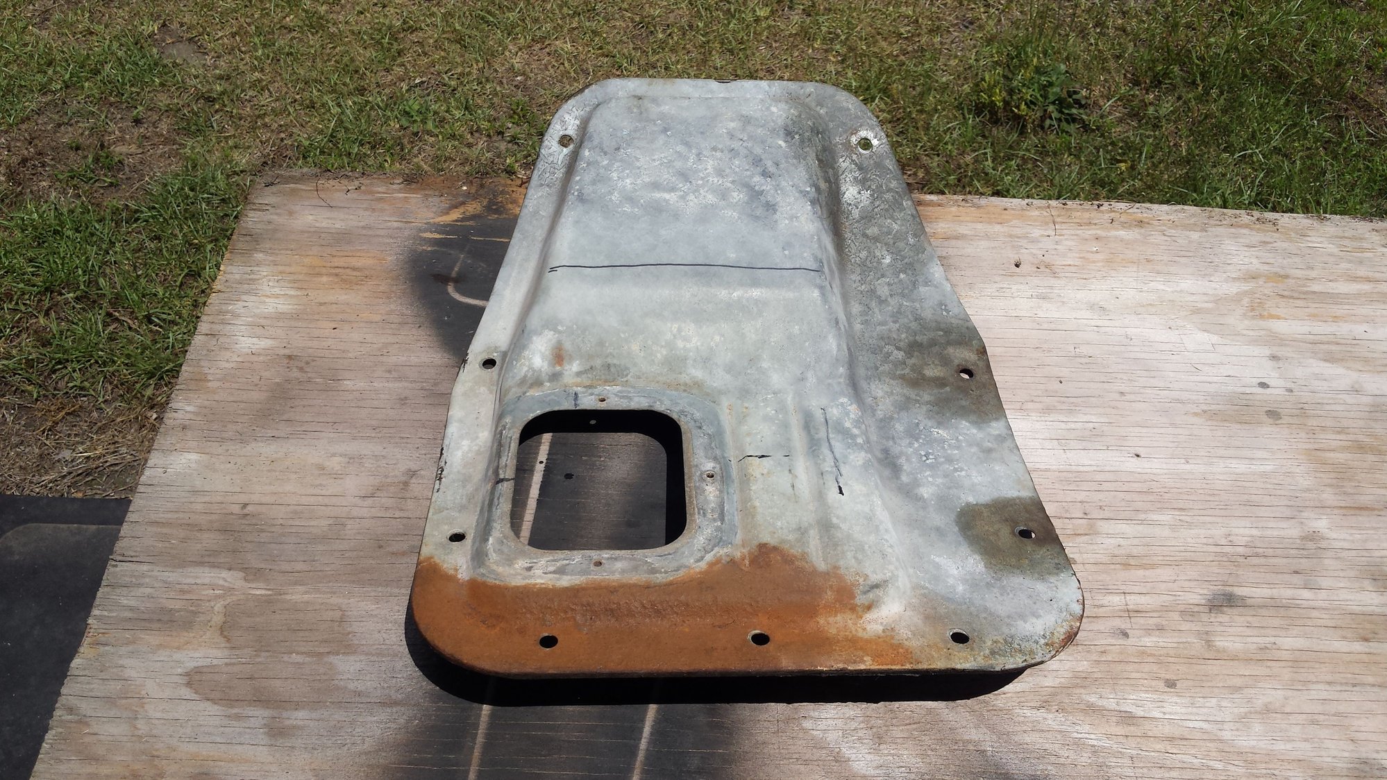

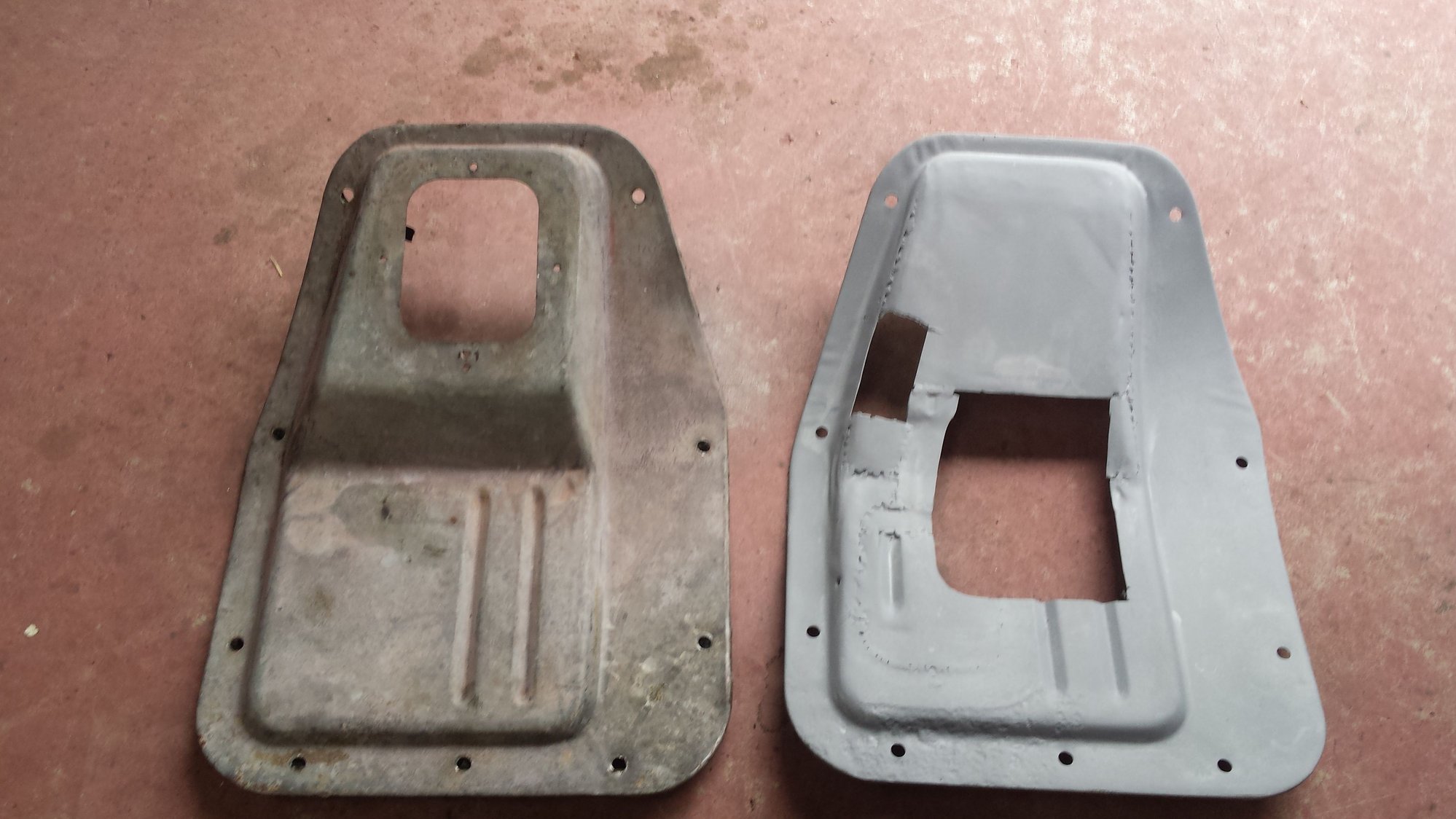

I manual transmission trucks there is abolt on pan where the shifter comes thru the floor.
Some pans are taller than others to clear the transmission because the transmission is taller. Maybe this is only the ZF5 transmissions?
Also the hole where the stick comes thru are in different locations.
At least between the T18 and the SROD transmissions as they were the 2 pans I had at hand.
My truck came with a T18 that was bad so replaced it with a NP435 and at the same time added an over drive unit that pushed the trans back 7.5"
I wanted to keep everything for the T18 if I wanted to rebuild and stick it back in so I used the SROD pan and mod it to work .
SROD pan
T18 pan on left the mod SROD on the right for the over drive
