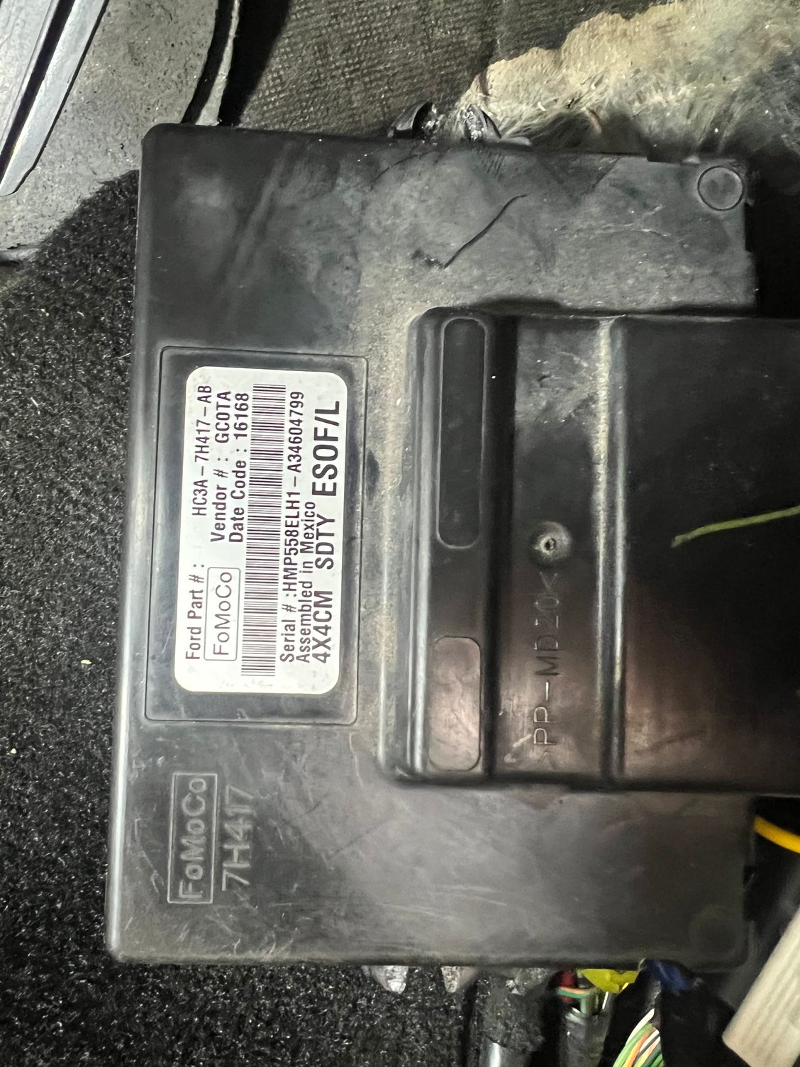

i had a truck sitting here with the same set up as mine but with diff lock. I borrowed the 4wd controller from that and plugged it in. Yes the locker locks and unlocks while sitting here but I am not 100% sure it will shut off at 30mph or whatever speed it is. I am not seeing any dash indicator. The truck I borrowed it from has a larger screen than I do and it has an indicator that comes on and off.
I ordered a controller from eBay and will report back after I get it in and do more testing. It was $50. Here is a pic of the unit I tried and the one I ordered on eBay has the same part number. The part number on the bottom is the same is the non lock except for the L at the end.
total I am at $625 for the complete locker axle, $50 for the control module and $50ish for the 4wd/locker switch. Everything plugs in.
So I ordered the "Locker" controler, pull ****, from ebay as well. Mine will not lock but 4x4 works when activated BUT no elocker. I did test the elocker when I pulled it as well as the wiring harness that came with it. I may pull it and check the serial # compared to yours. Sorry I Just noticed you were talking about the TCM. I will look one up. Thx
PS. Where was the controler located ?
Preacher
Preacher
that 4wd controller is by the passengers feet. It is easy to see
