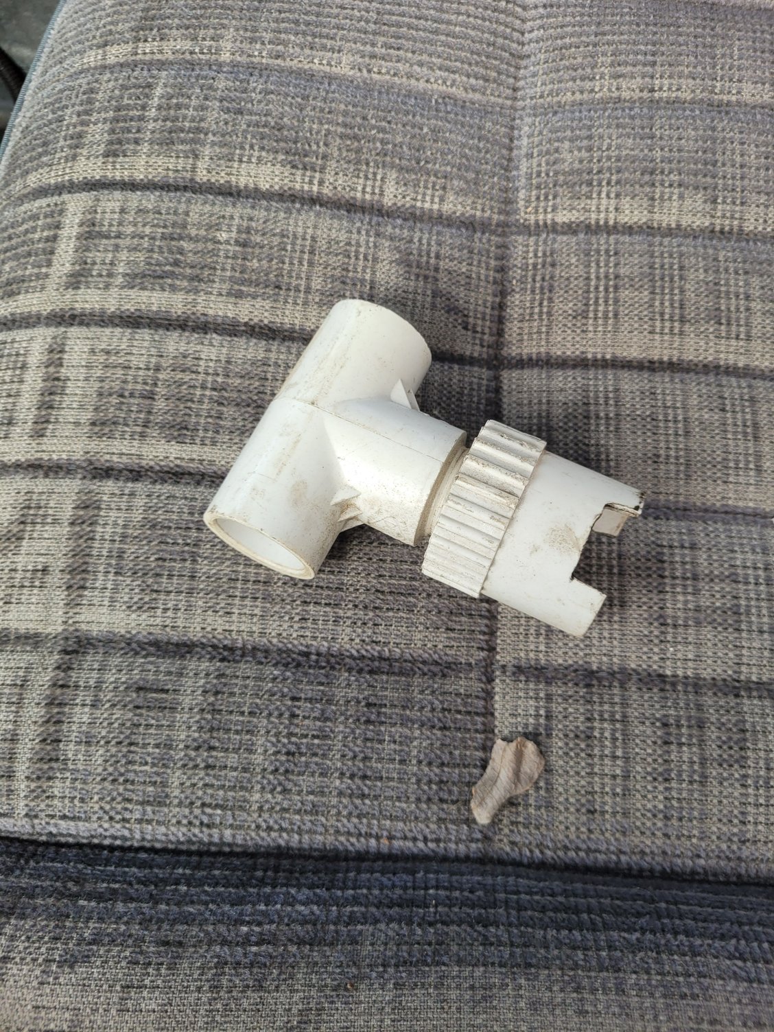

about 35 years ago i realized it was a real pain to lock the front hubs when cold out as i had bad frostbite on my hands and toes in 1976. so i made a "tool" to aid in locking/unlocking the hubs. i got a 1 inch PVC "T" and a 1inch screw in coupler. screwed the two together, and cut a slot in the coupler just big enough to fit over the bar in the locking hub. now i can easily lock/ unlock front hubs no mater what the weather is, even wearing thick gloves.
