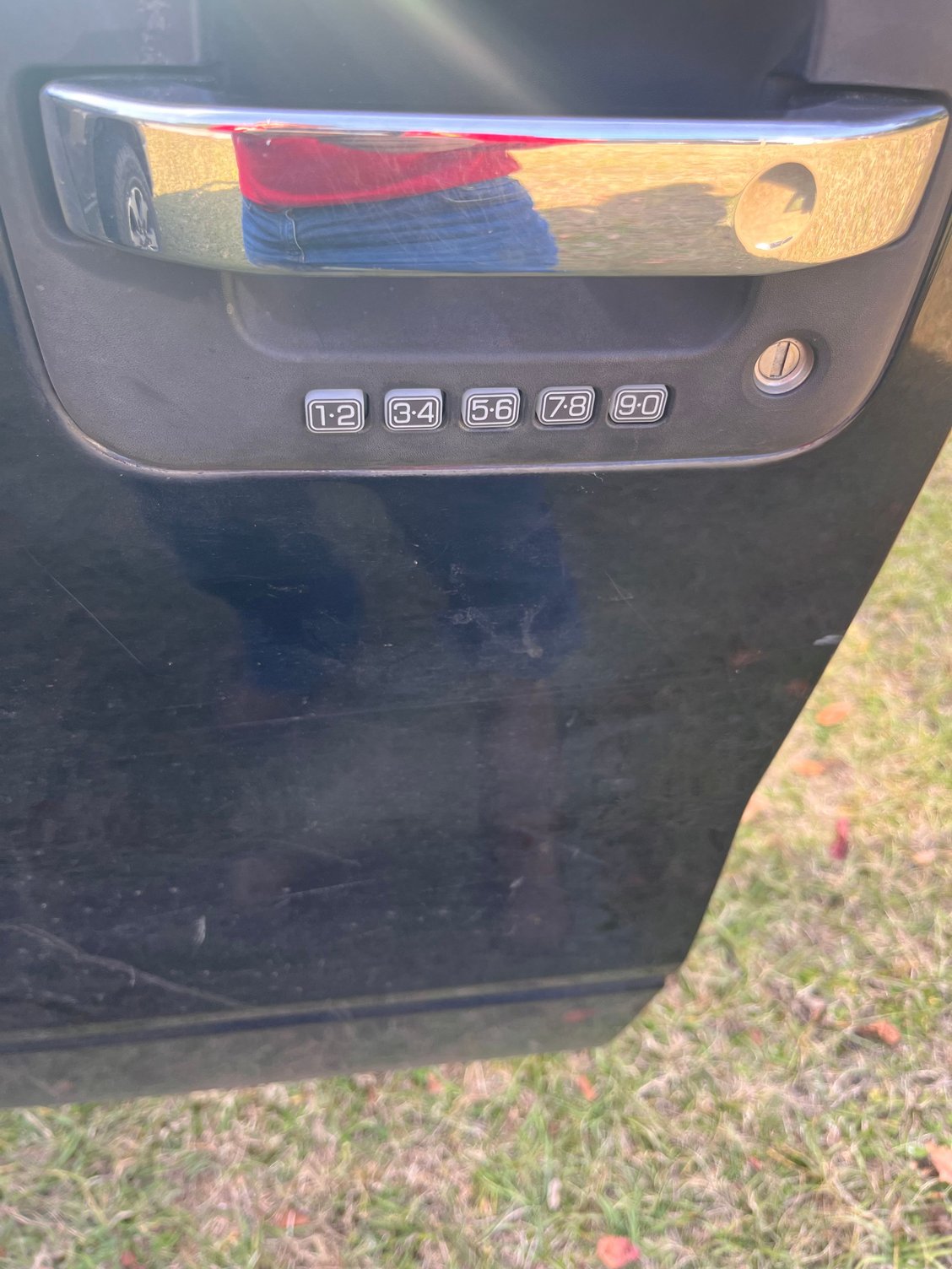

My keypad on my 2013 XLT 4x4 quit working it lights up. Key fobs work. I check several fuses but not sure which one. Any help appreciated. Ty

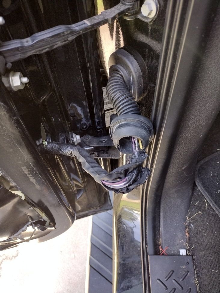

I would check the wire harness over on the hinge side of the door. Our trucks have a habit of breaking wires, may have to take panel off the door and/or the truck side, to inspect the harness.
heres an image of a rear door harness
