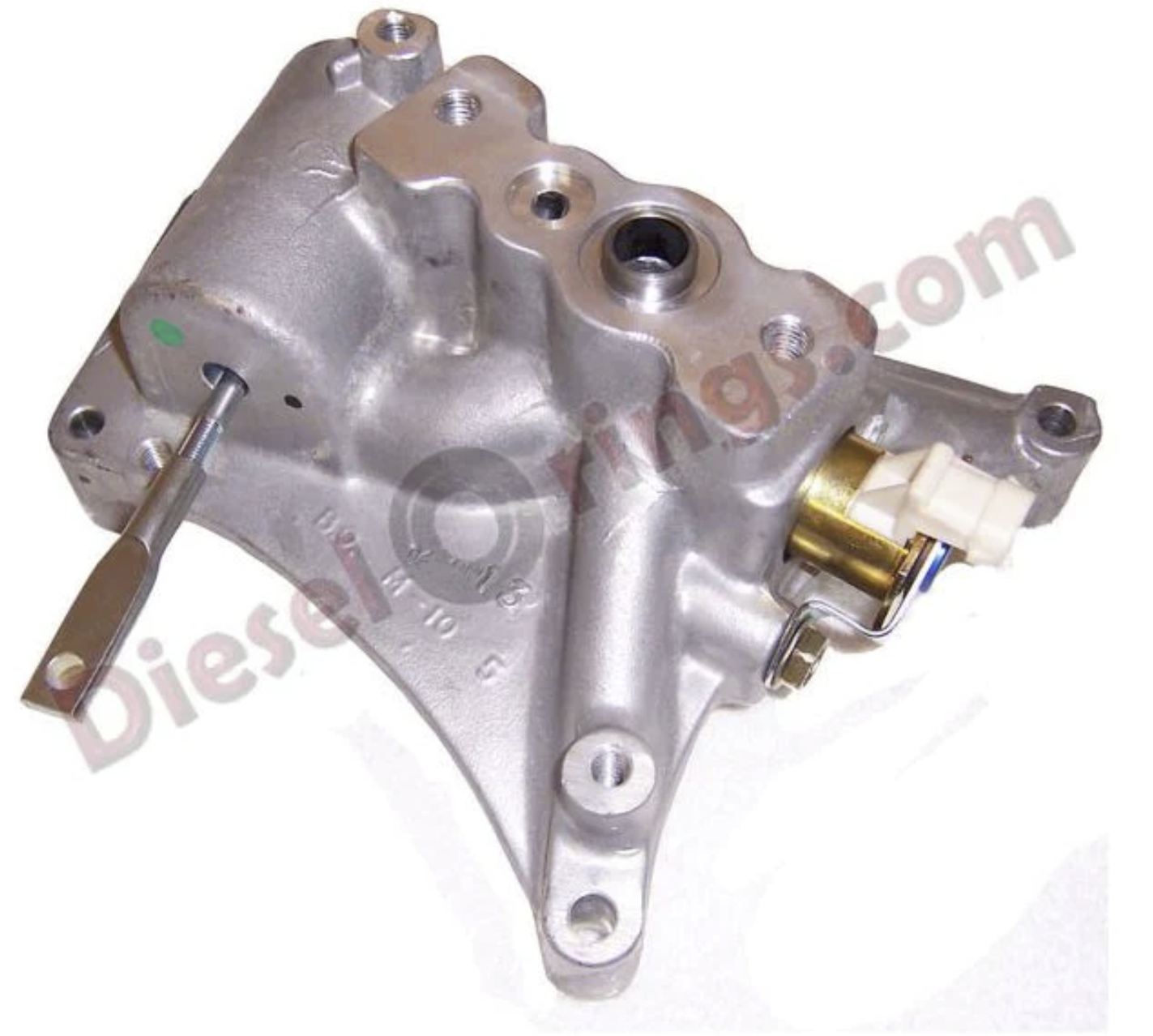

Was poking around the engine valley to check on bunch work I did early this year (turbo pedestal etc) and noticed the EBVP piston rod was not connected to the door/flapper/valve. I changed it with complete pedestal and EBPV solenoid etc unit from Diesel O Rings.
The clip had disconnected from the arm. The arm must be pulling too far inwards and pulled the clip off of the flapper arm connection.
In my many attempts to get it back on, I lost the clip. OF course.
Until I get my hands on a new clip, should I use some mechanic's wire to tie the flapper open? In other words pull it out towards the passenger side (the position its in, in the pic below)?
They give you some lousy instruction on how to set the tension on the spring and set the length but maybe I didnt do it correctly.
Here is flapper arm I'm talking about:

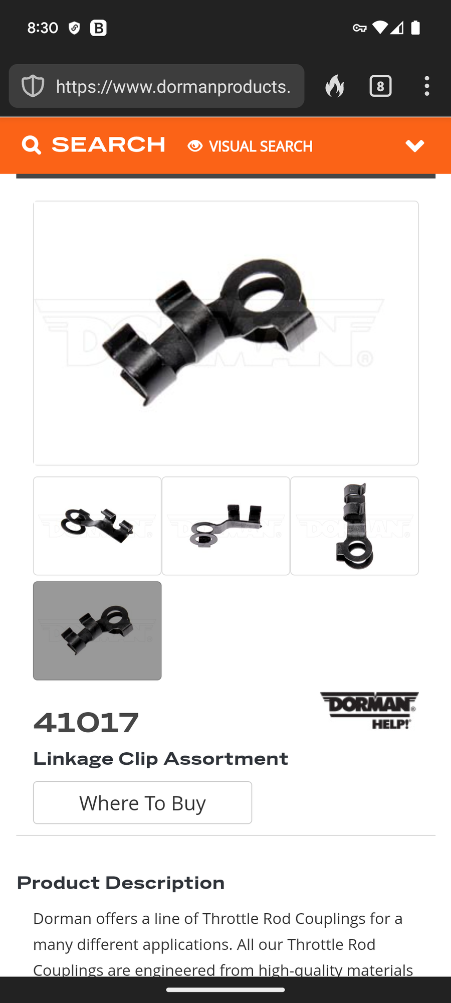

They sell those clips for $30 on eBay! Stupid.
This set?

Dorman Kit 41017 Carburetor linkage clips didnt work. Too small.
They didnt have 41016 for linkages at the Autozone near me and I aint driving all over God's creation for a clip when Amazon exists.

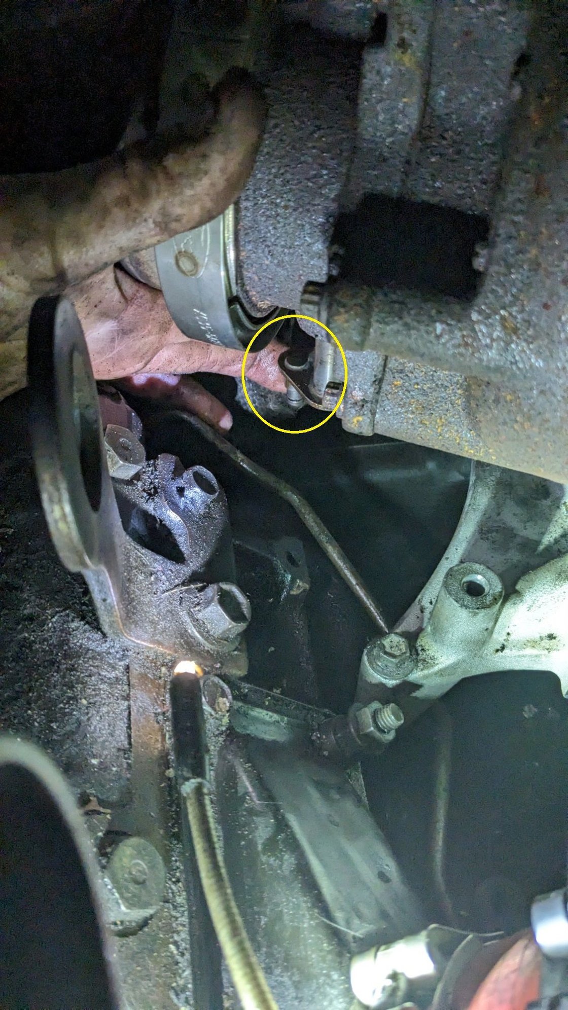

Do I have this correct? I'm obviously lying on the motor with my hand reach back towards the firewall.

If I remember it should have a little nub that gets tight as it's going over the shaft. Then once it's over the hump it can't slide bake without a little force.
