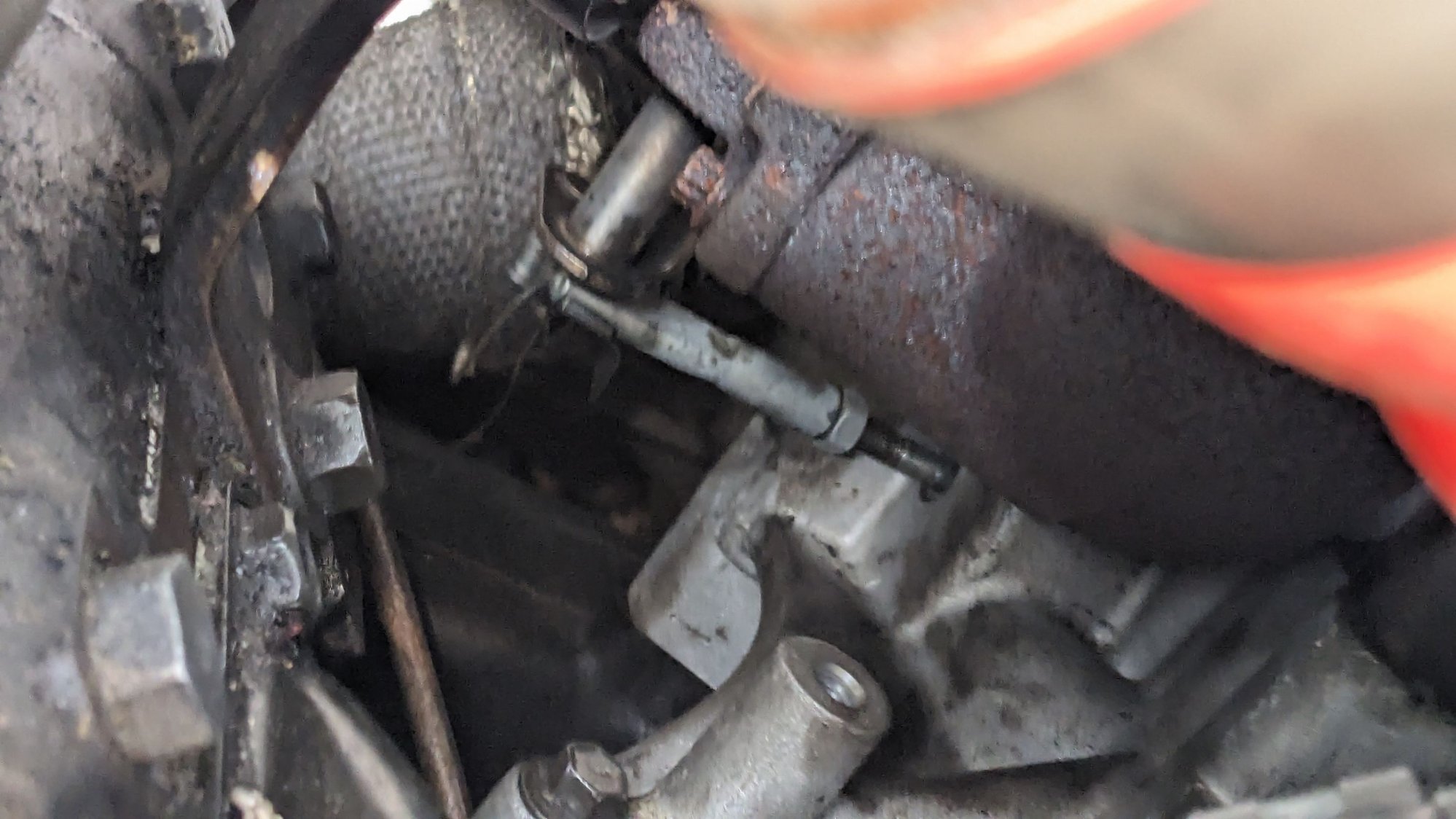

EBPV arm with engine good and hot and running after a 20 mile drive at Mach 0.045.
This looks no different than with engine cold with key off. Need to check for when engine cold and just started.

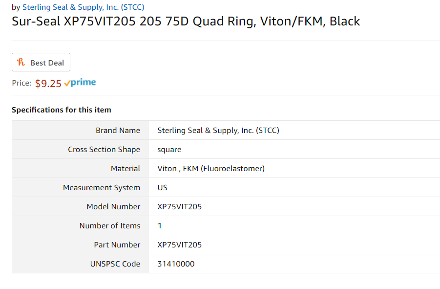

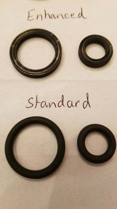

Alternate o -rings?....I got mine from RiffRaff with turbo reinstall kit that includes 4 o-rings and bolts.
One guy in that other thread advocated for another round of torquing the bolts! Just make it tighter..problem is I dont know whats leaking.
Interesting design.
