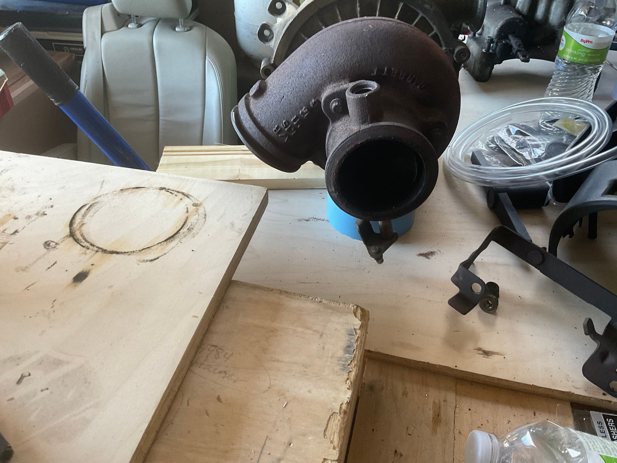

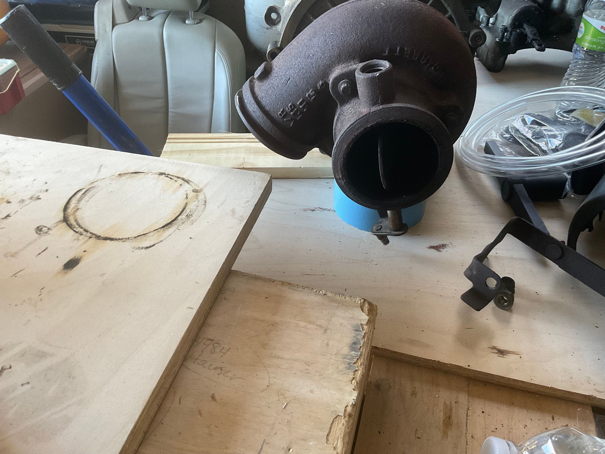

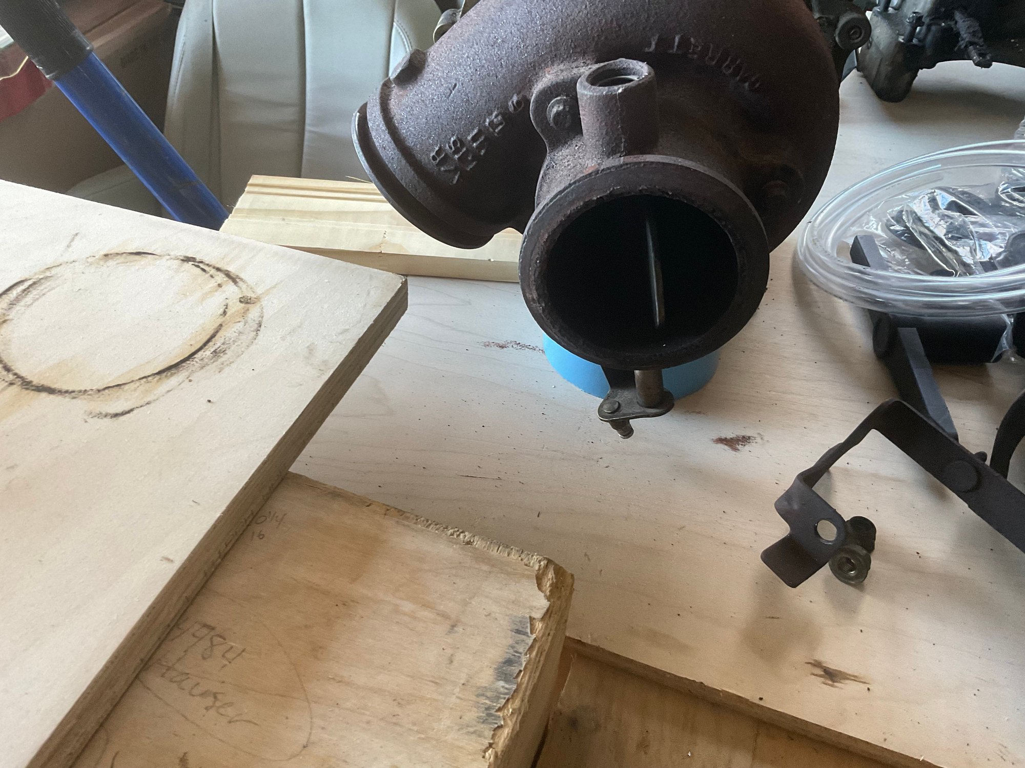

I guess I’ve never tried to upload a video clip. Here’s a couple of photos to show the orientation. I guess if you grab it w your left hand and rotate it counter clockwise it closes.

I got this explanation from Diesel O rings:
The piston pushes the valve closed. With the piston extended the valve will be closed.
When the piston arm retracts back into the pedestal, the valve opens.
Engine off and key off, the valve should be open, piston will be retracted.

Description from Bob makes sense. The valve must be actively pushed closed to work. Default is floppy open.

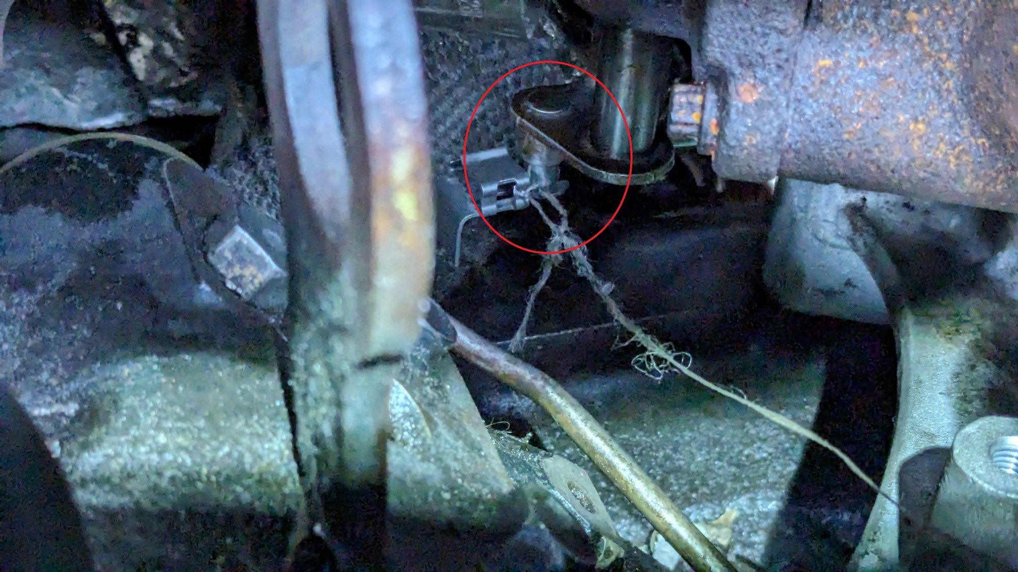

How to install pedestal clip on EBPV arm 7.3l turbo
Update 9.3.24.... The pivot arm needs to go into the hole in the ebpv actuator arm, like so: (not in front of it, duh!)
ok I got to chance to install the pedestal clips from Diesel O-rings. I literally tied a section of dental floss to the thing so it wouldn't disappear on me. THANK GOODNESS I did. She jumps around.
Seems heavier duty than the OEM unit but doesnt seem to fit around the arm like it should.
The opposite side doesnt completely envelope the arm as shown here in RED. Might be that the arm is thicker on this unit.
Anyway if you need to get one on after the fact, like I did, ya definitely need to get the intercooler tube off on passenger side so you can get a hand in and then either start the clip on the thin part of the arm and the slide outwards....like below....or....
...put the clip onto the VALVE'S ARM first and then spin it around and try and pull the open end onto the actuator arm.
I also spun the arm out a few turns to get it closer to the valve actuator in hopes in wont pull away again when the engine is warm and valve open.
