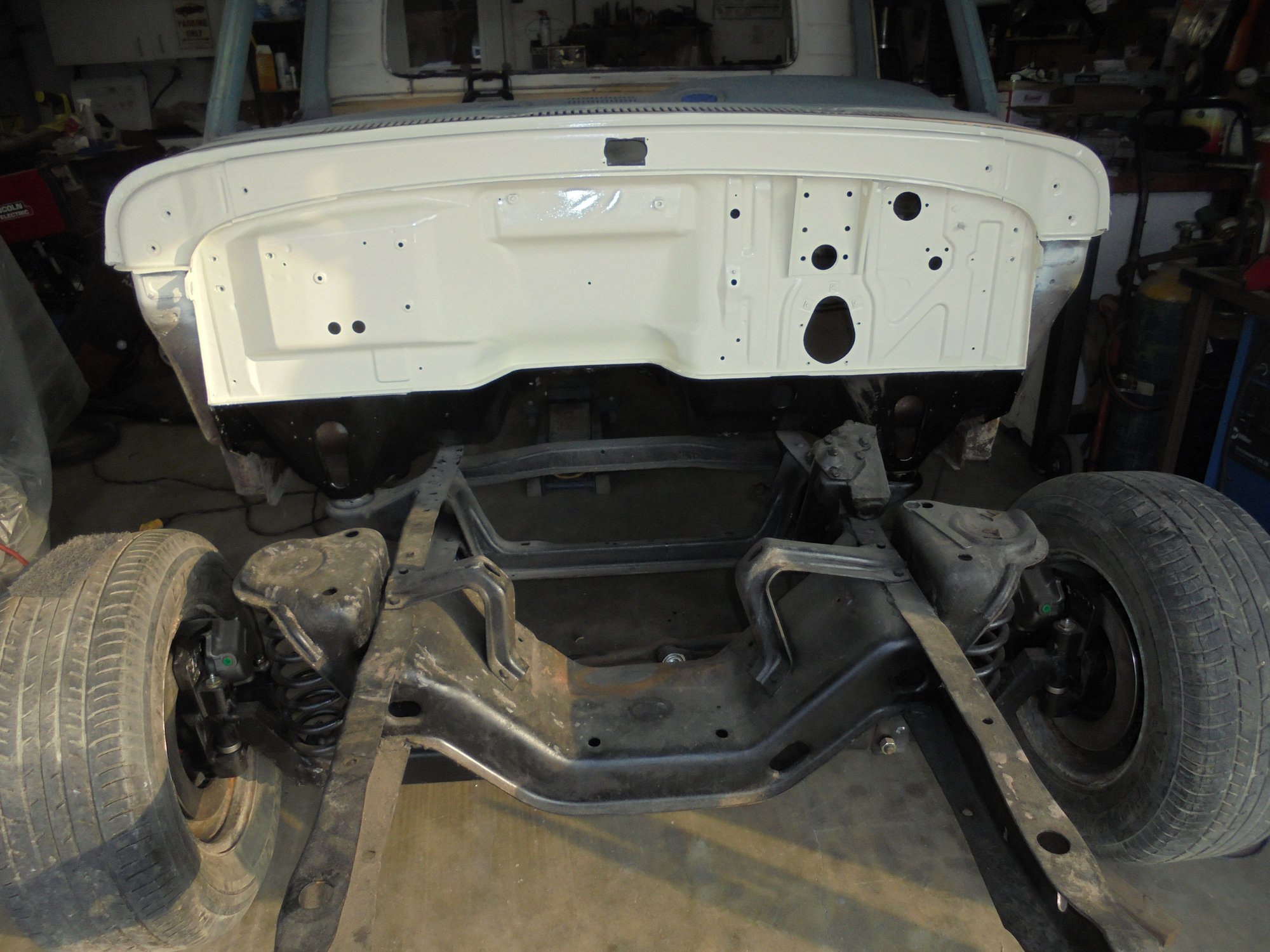

Where the steering column goes through the firewall is a bit of a conundrum. Below is a photo of the bare firewall that shows the shape of the opening. The column seal, also pictured, that I bought several months back does not cover the entire opening. It gets sandwiched by a metal surround that fits on the interior wall. It goes almost straight across the two top small holes, leaving the top third kinda open. The outer shaft support does cover the top half, but it seems wrong.
Is there something I'm missing here? I'm thinking I may make up a full length cover for the outside.

Yes, that rubber boot pictured goes on the inside with a plate that's roughly that size. It uses those bottom four holes around the opening. The outside gets a larger plate that covers the top of the hole with the captured nuts. I'm doing the same ididit column and bought a power steering outside bracket from brian morison at slick parts to get a better angle but if your truck already had P/S you already have it. This is a picture numberdummy posted in 2015.

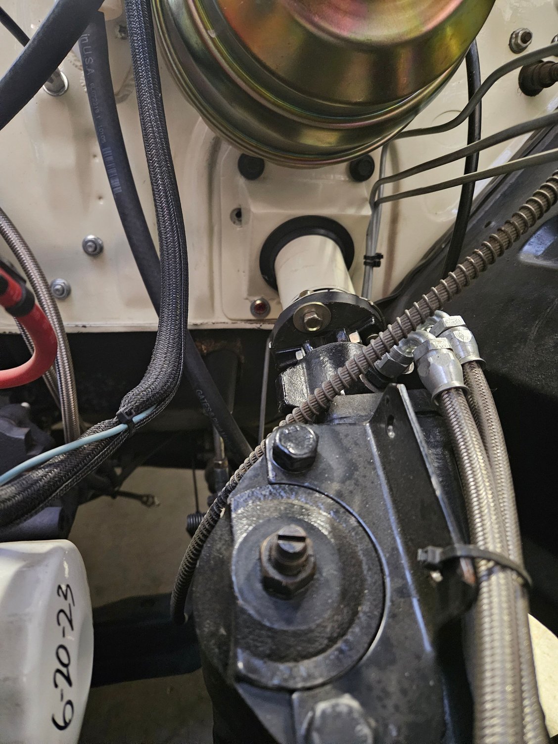

I thought the whole factory firewall seal, and shaft support was kinda half-assed. No real seal since the firewall seal only covered 2/3s of the hole.

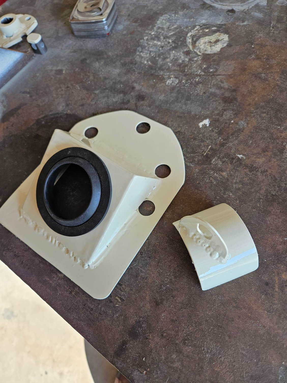

So I made one from 16ga sheet metal and a heavy duty universal gas neck seal.
First I had to mock things up to locate the actual hole position. Made the pieces up and tack welded it together, and then checked the fit again. That other bracket in the photo is my brake light switch mount. I don't like pressure switches. I've had several fail on various vehicles, so I used a GM style brake light switch.
Once I got it all finalized, I shot the column and the new sealing plate with the same wimbledon white as the rest of the truck. A little fiddly getting it all together. The rag joint part that attaches to the steering shaft doesn't fit thru my seal plate hole. So the column had to be slid thru, and then the rag joint flange could go on.
The steering wheel position, which Ididit claims to be in the same spot as the original is actually a bit further away from the driver. That is good as now there is plenty of clearance between my gut and the bottom of the wheel....and my gut is not all that big! Also, one click up on the tilt puts it in a very comfortable position. So my concerns about having to find a smaller diameter steering wheel have been eliminated.
The steering box end has a sliding shaft for different steering boxes.
However, with my power steering box, it is very tight. I had to cut an inch off the shaft, and there is not a fraction of an inch lee-way between the ends of the rag joint between the box and the column housing. I wanted to use a universal joint rather than a rag joint, but there is no room.
Maybe the column housing could be shortened. I did not delve into that to see if it was feasible. The bottom bushing/bearing is held in with a roll pin in a blind hole. I didn't wanna dink with that.
It's in. I'm fairly happy with it. But it wasn't just a bolt in job....at least not the way I wanted it.
