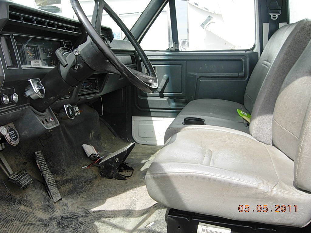

Originally Posted by ctubutis
The trucks had the gear indicator behind the clear bezel, along with the speedo/tach/other gauges. That one with the indicator on the column looks to me like it came from a sedan.
Here's the dash before removal. My transmission is a C6, no overdrive.
AOD shift indicator dial, AOD first introduced in misc 1980 Passenger Cars. Due to how dial (7A213) is made, location of it, column appears to be from an Econoline (see pics). AOD introduced in 1981 E/F100/150.
1980's cars with column shift had cable controlled instrument cluster mounted shift indicator dials similar to F100/350 & Bronco.
Notice how the lower section of cutout for T/S handle in upper flange is shaped. Column swapped because someone wanted a tilt wheel. Press the turn signal handle forward = BOING!
Brake pedal pad installed upside down.
