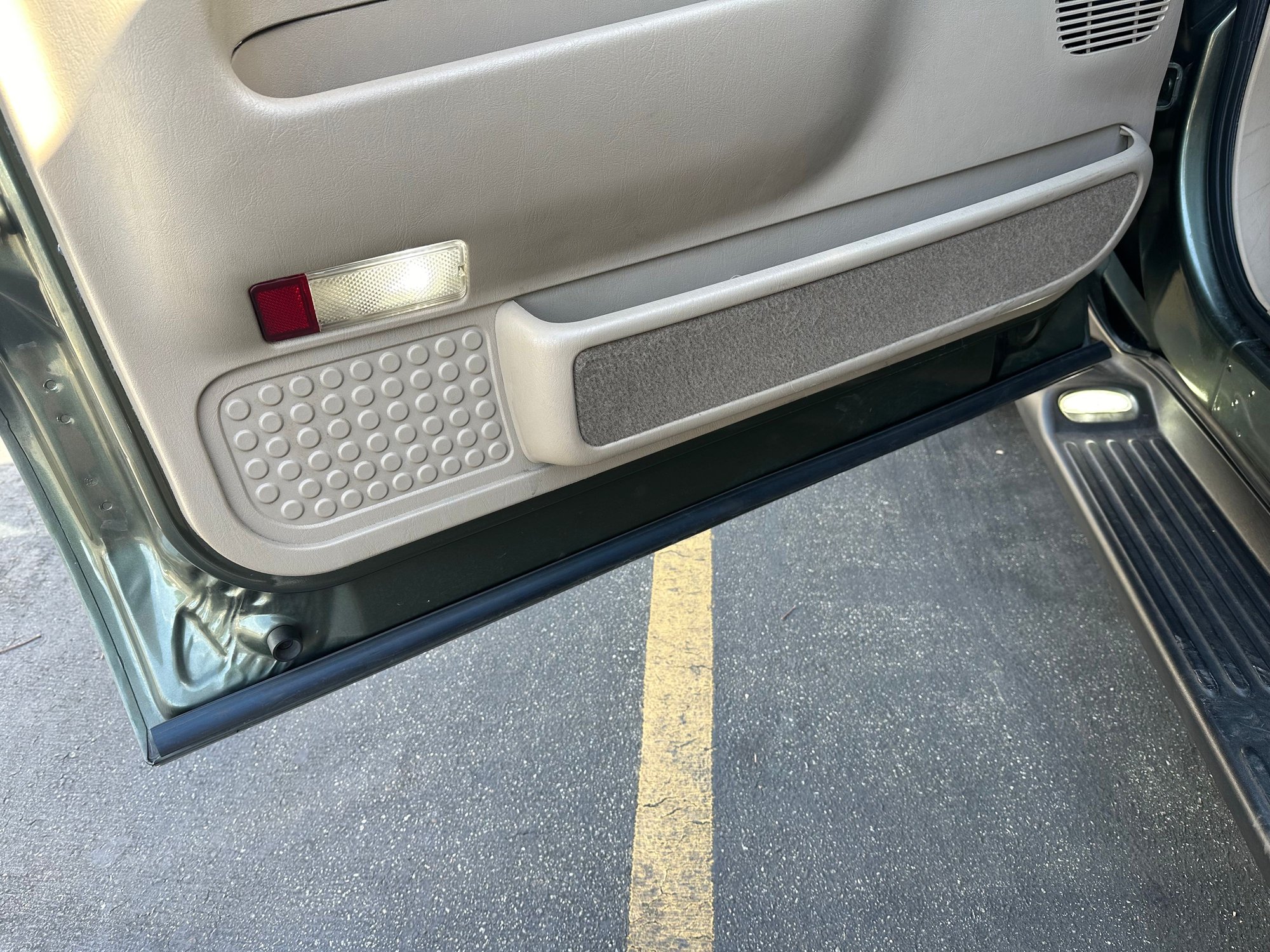

New rubber

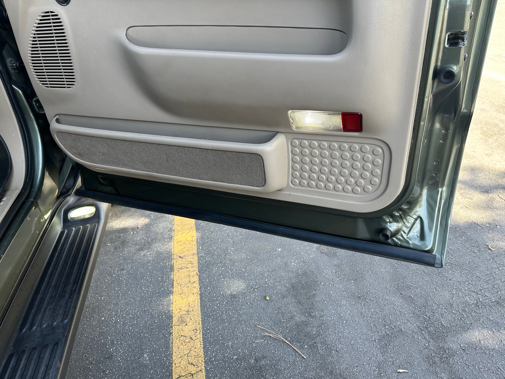

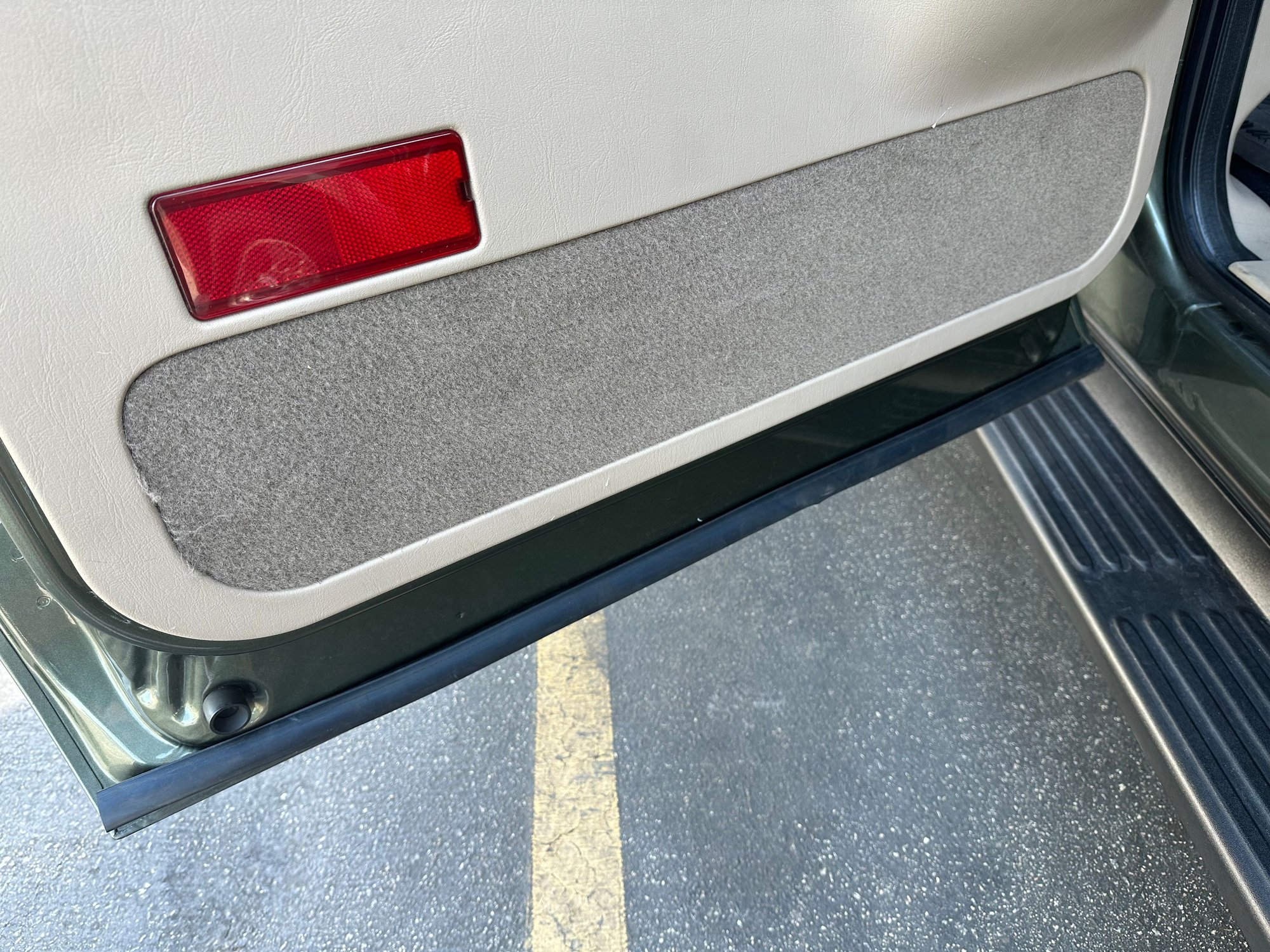

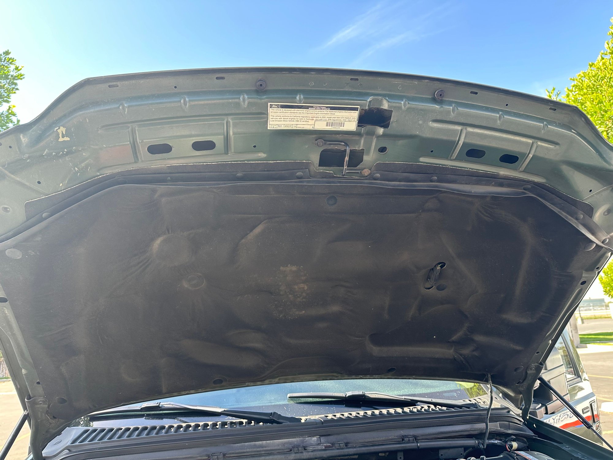

Today installed the tailgate struts and installed new rubber hood front edge deflector and all four doors lower weather strips.

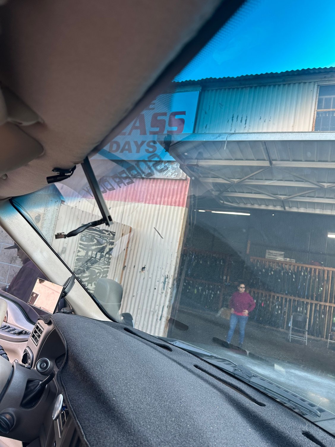

Gauges

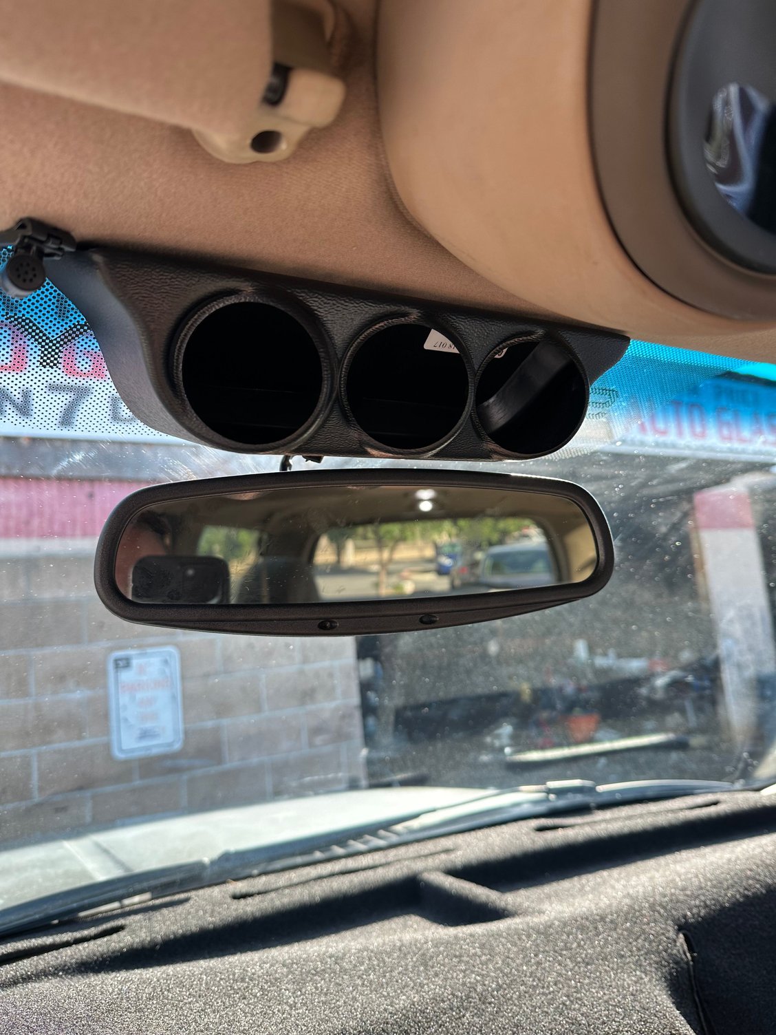

I might have mentioned this before but, I’ve been collecting these gauges overtime because quite frankly, they’re pricey! After much research, I’ve purchased the three most essential ones, fuel pressure, transmission oil temp, and pyrometer. To house them I decided on the overhead gauge pod to go above the rear view mirror. I also purchased the pigtail to adjust the red alarm light and just discovered a dimmer switch might be a good idea to match the backlight brightness matching the instrument cluster.
My first challenge was getting the glass shop move the rear view mirror mount about an inch lower to accommodate the gauge pod. Had that done yesterday. Thank goodness it didn’t crack the glass requiring replacing.
Next step is to have the sensors installed. Hopefully that’s done this week and then the final gauge installation.

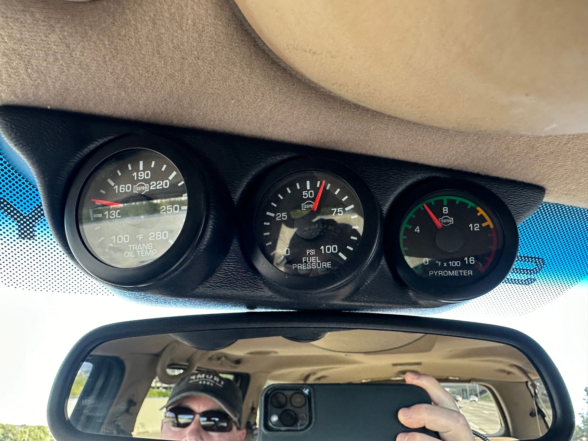

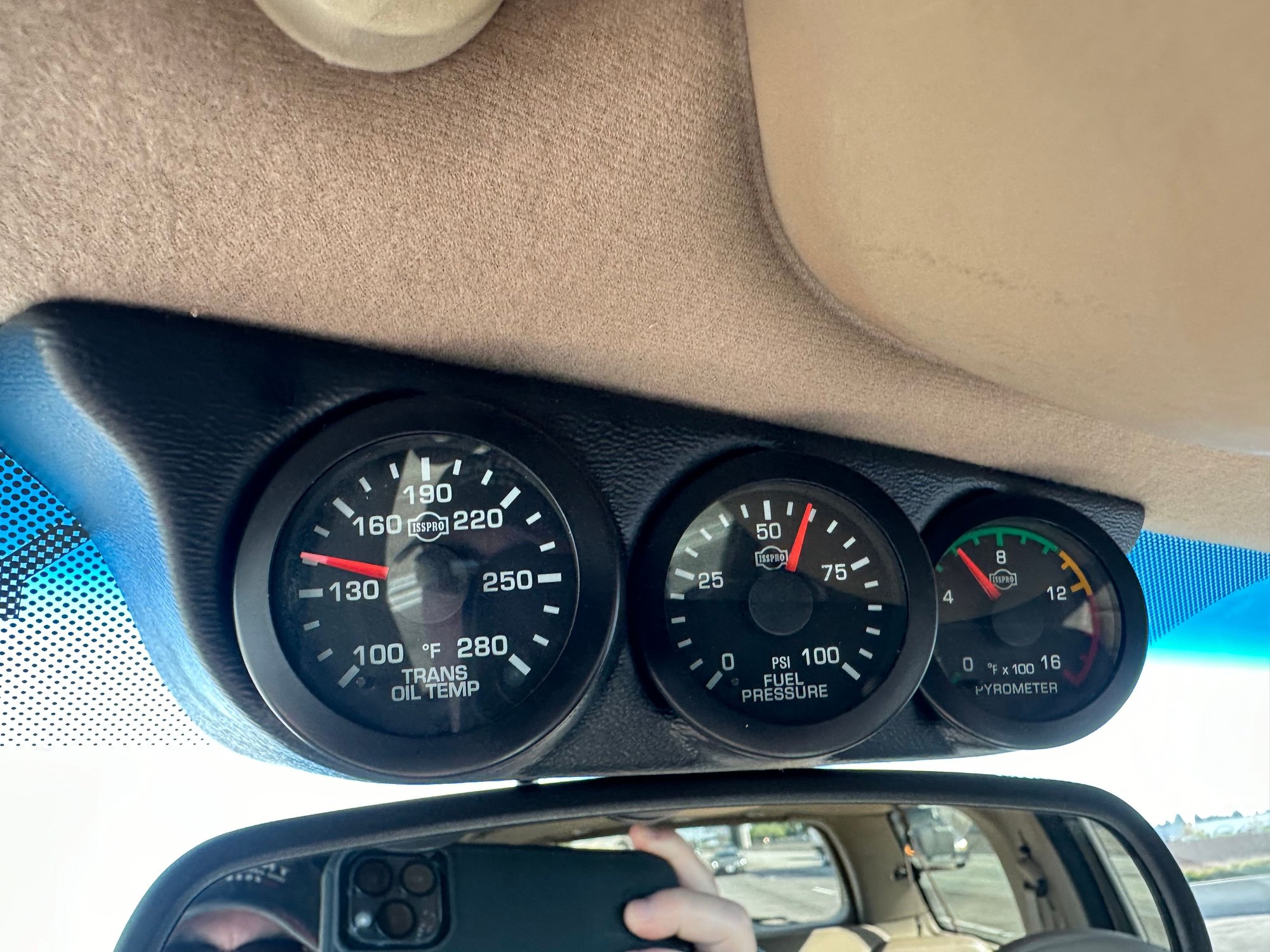

Finally got the gauge pod installed. Of course the shop bent me over with a $550 bill. They said last Thursday if I brought it in the following day, Fri, they should have it ready by EOD. That didn’t happen and my truck was in this place with ~20 trucks torn apart. I was having nightmares about seeing my truck without an engine or some other catastrophic condition fearing my truck was used for parts.
The reason for my panic, I had a customer meeting yesterday that I couldn’t postpone and today had a 105 mile drive to San Diego for a trade show.
Long story short, the gauges are installed and working seemingly correct. It’s a 7.3 completely stock, no mods and has 204,000 on its clock.
Ambient temperature today was about 75 degrees
Transmission temperature was a steady 130-135 degrees. I have the Mishimoto transmission cooler.
Fuel pressure was mostly at 59 psi but at full open throttle maybe dipped to 57 psi.
Exhaust gas temperature at full throttle was up to 800 degrees and at cruising speed of 75 mph hovering around 400 degrees.
Im curious if others have similar readings..

I couldn't be happier! Fuel pressure seems pretty stable at 59-60psi, trans temp around town, not towing is ~130F, and exhaust temp runs anywhere from 300-900 depending on how hard I'm stepping on the forward pedal or not. They look great and I have piece of mind knowing what the systems are doing.
